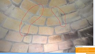

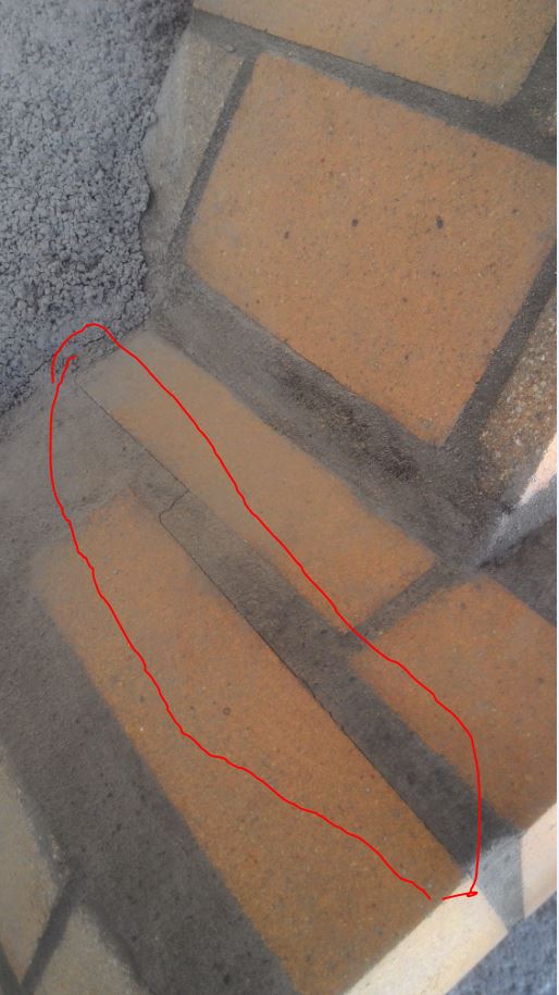

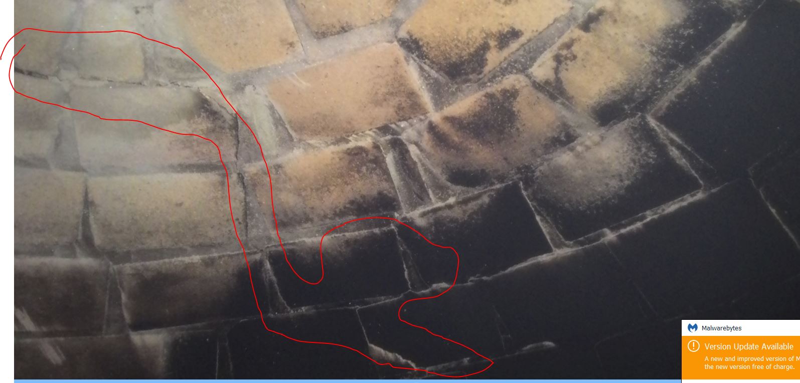

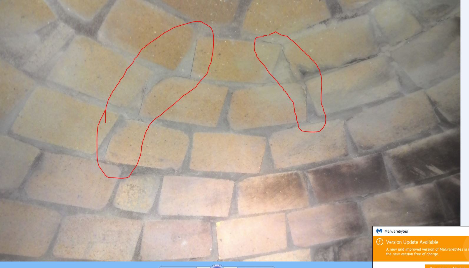

      Today i insepct inside and i saw some cracks.Also i have and on the other side of the vent arch a crack..
      Please i need your help,is it bad for my oven?
      Need to do something??

        not a problem, just hairline cracks. We all have them and some bigger. Is your oven fully cured?

          #304
          Yes,i wait few months before start fires..Also,my oven is under a roof and i don't have any issues with rain or water to come on the dome or under the floor.
          It's protected 100%
          About vent crack in previous page?
          Which your opinion?
          Thanks texman.
          • texman
            • Nov 2009
            • 724
            #305
            the crack in the vent is normal as well. If all you have are hairline like those, no worries at all. The cracks that you have may get bigger when the oven is hot and then shrink back to what your pictures show when the oven cools. That is normal. If you get some larger cracks, you can fill those if they bother you. If you have a brick oven, you have cracks in it.

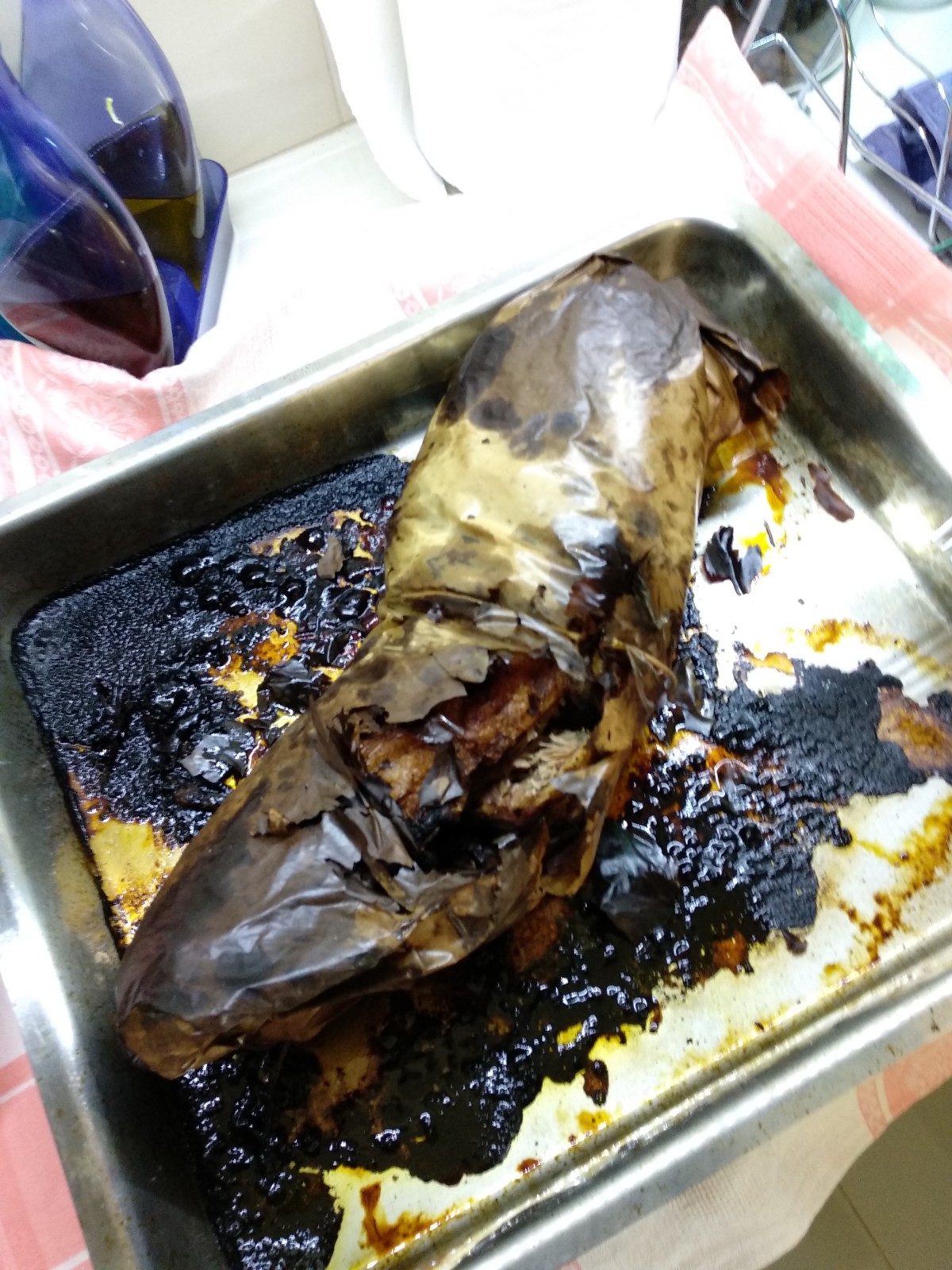

                                So far 76 pizza are baked!!
                                I cooked the first leg lamb.4 hours slow cook at 200C.
                                Was amazing!!!!
