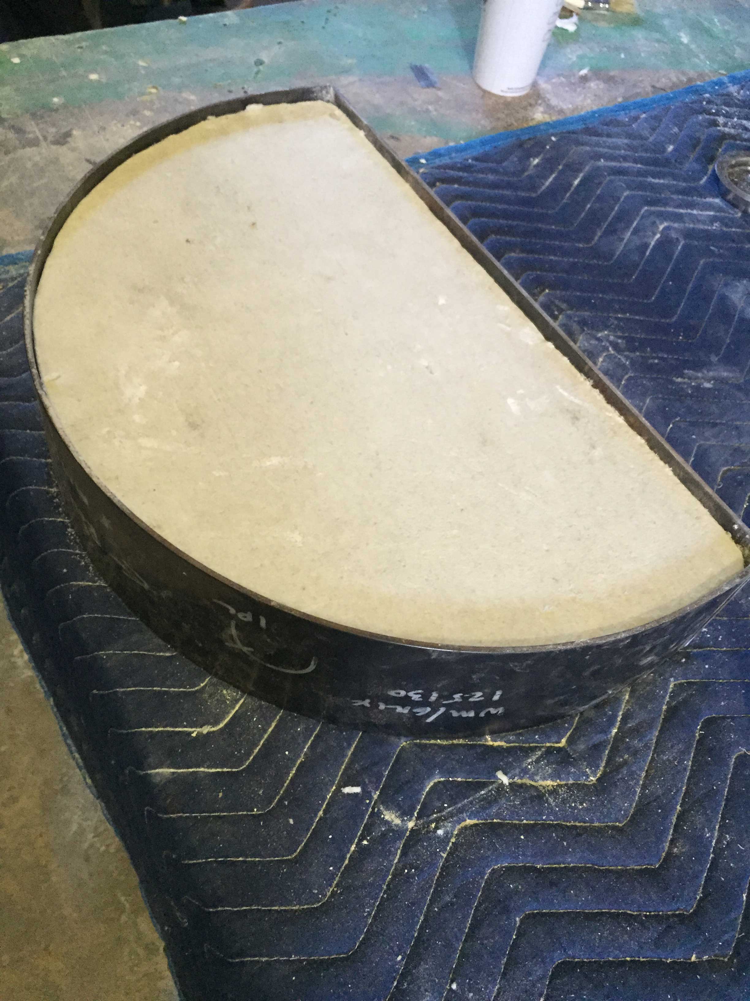

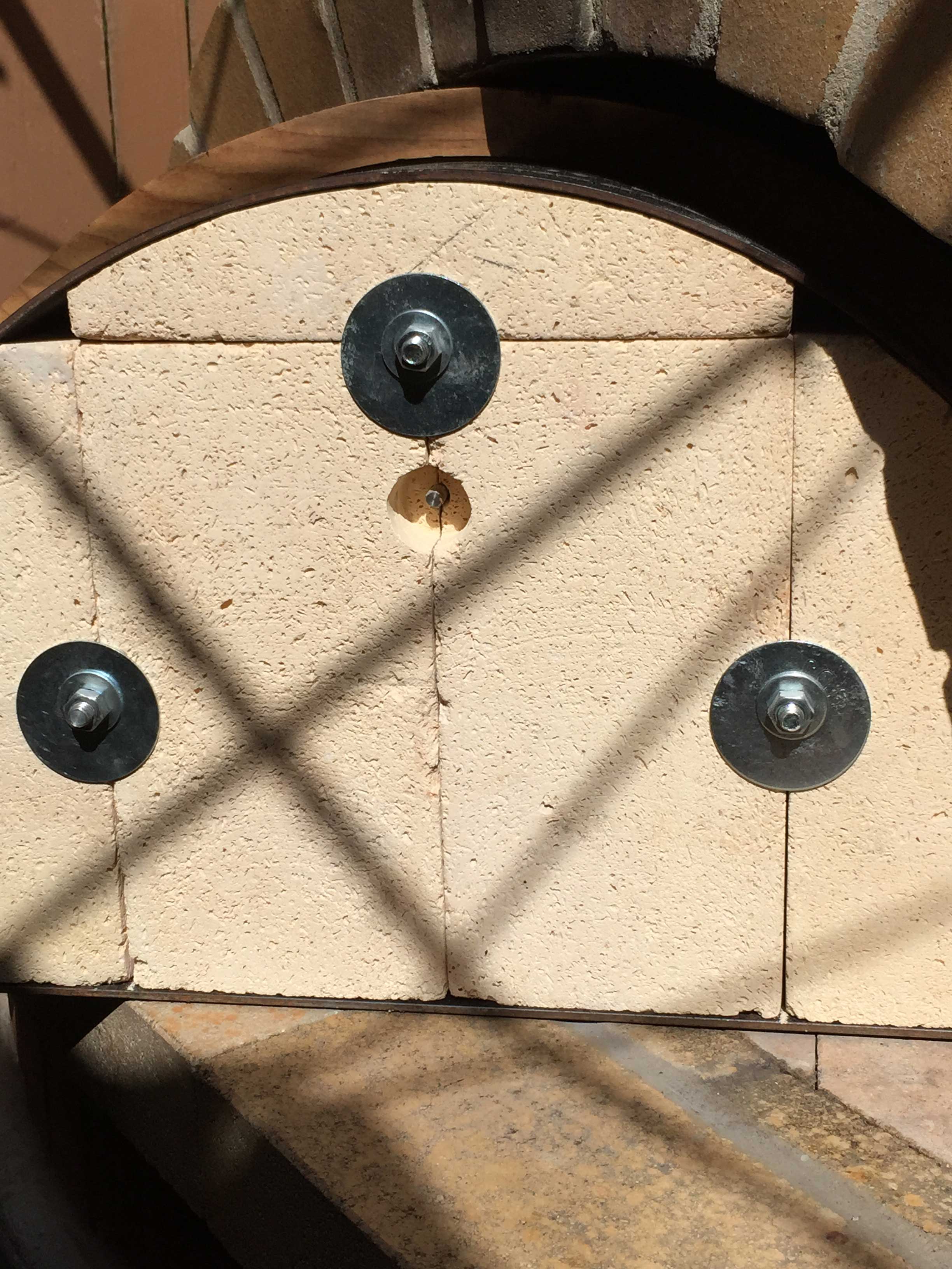

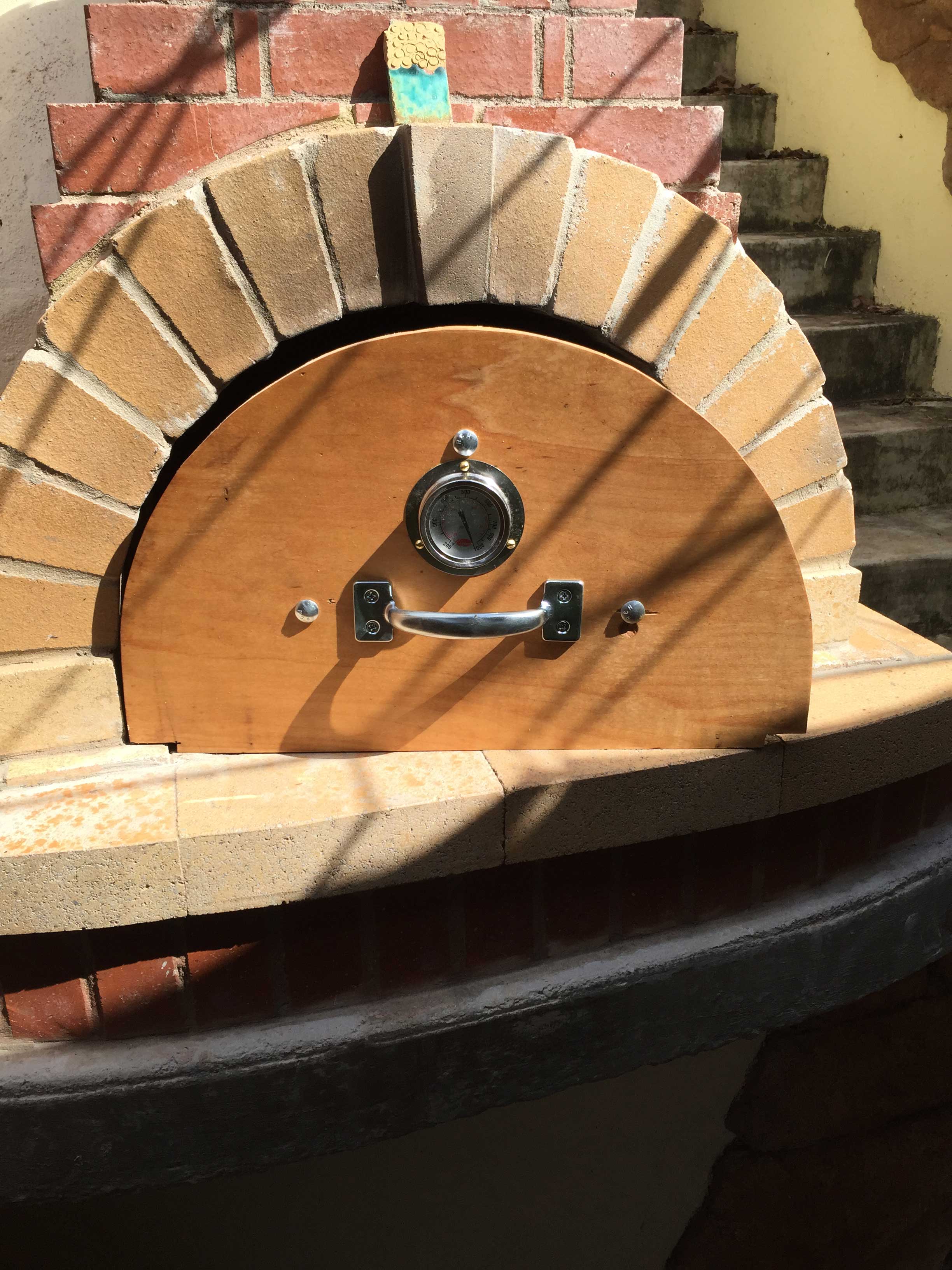

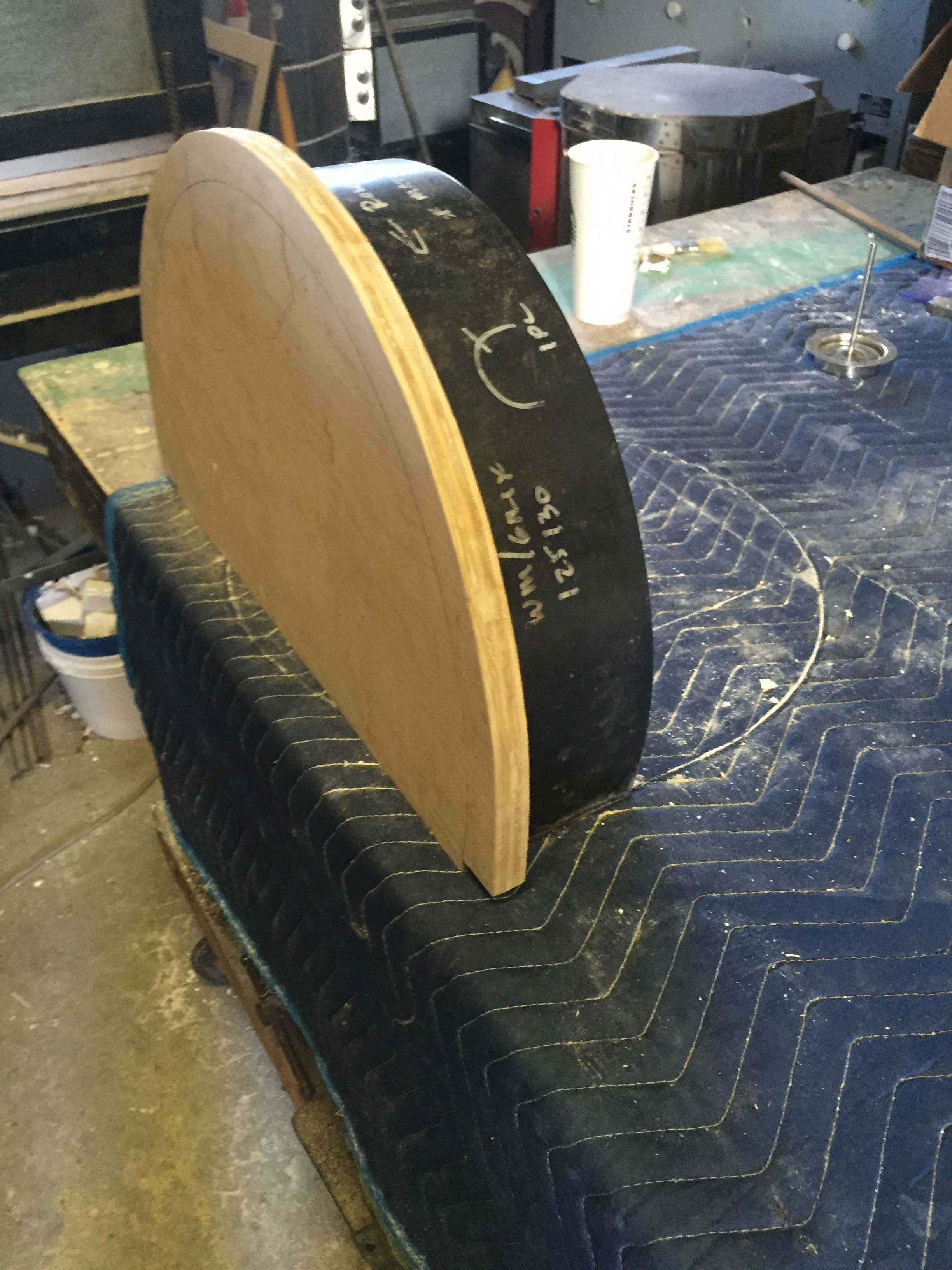

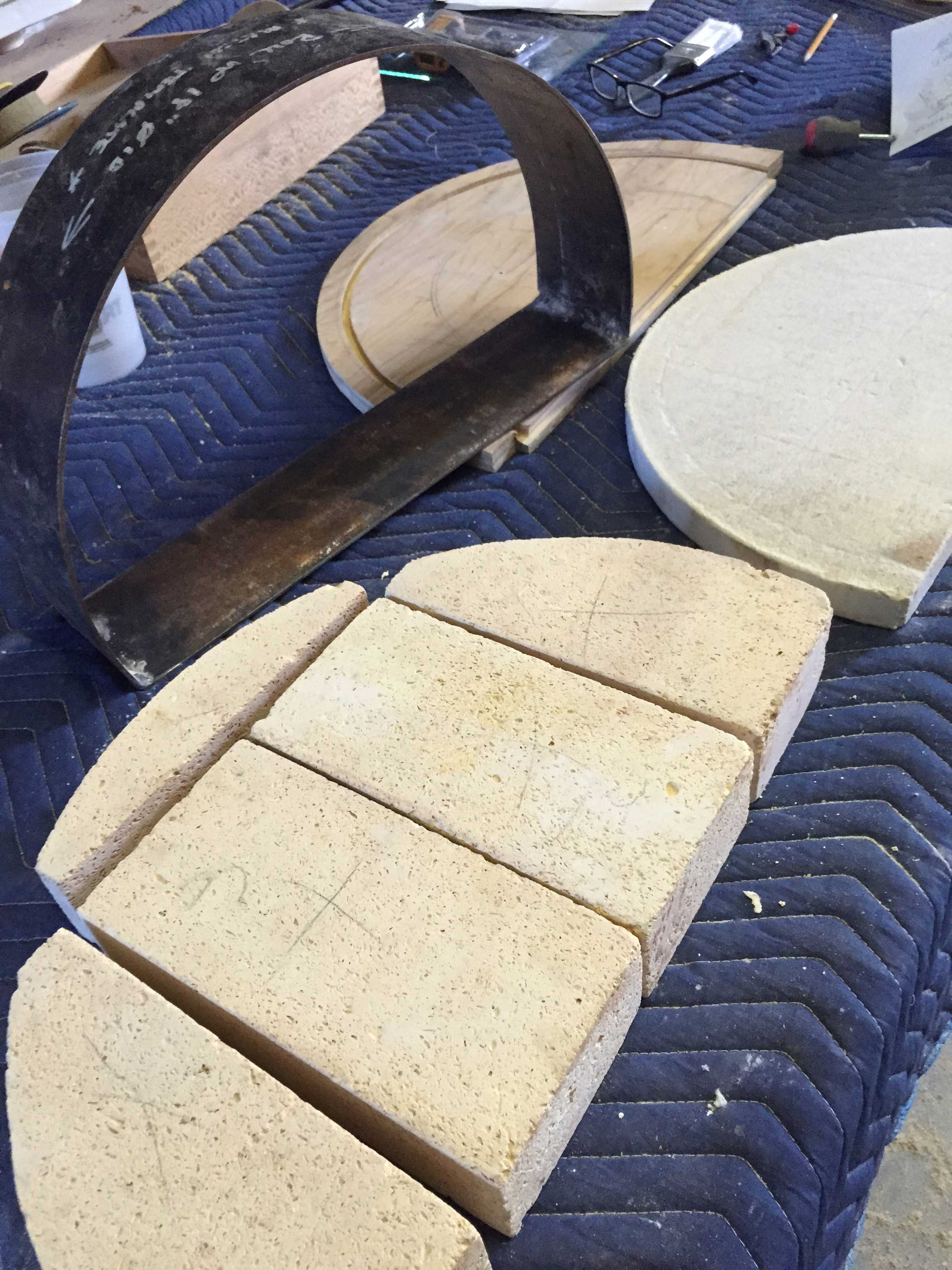

                              Wanted to share my oven door build, I started off with 1/8" mild steel and rolled and welded the sleeve. I cut K26 insulated kiln brick for the inside of the sleeve, I then cut one inch LD fiber board to back up the ply door, which was one of my forms to build the outer arch. I ran three bolts thru the ply to the back of the brick and used carriage bolts and fender washers to hold together. For the thermacouple I drilled thru the ply and brick and since the probe was only four inches I counter sunk the brick so it would protrude into the inner air area. The weight is not to bad although if I was to do it again I would have used a lighter gauge steel, that is the heaviest part. I will in the future replace the ply with a more decorative panel.
                              Bill
                              • #45
                                Your oven looks fantastic....one thing I ran into....the 1st door I made was too heavy. I made it out of 1/4 in steel and put fiber blanket inside. It was about 30 pounds and was damaging my brick. i stressed whenever anyone touch the door and my wife could not cook in the oven simply because she couldn't easily move the door.
                                The next one I built, I went for the lightest possible option. I am really happy with it. I put 4 inches of insulation and used very thin steel. It is still over 10lbs. But easy for my spouse to move.
                                Something to consider if you start getting damage like I did.
                                Awesome job BTW.
