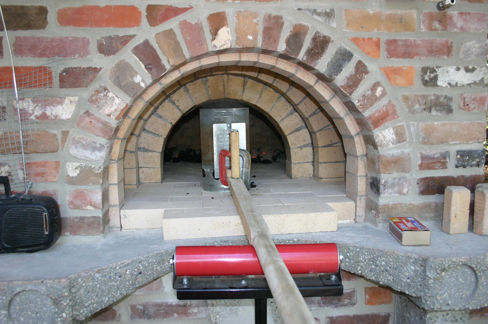

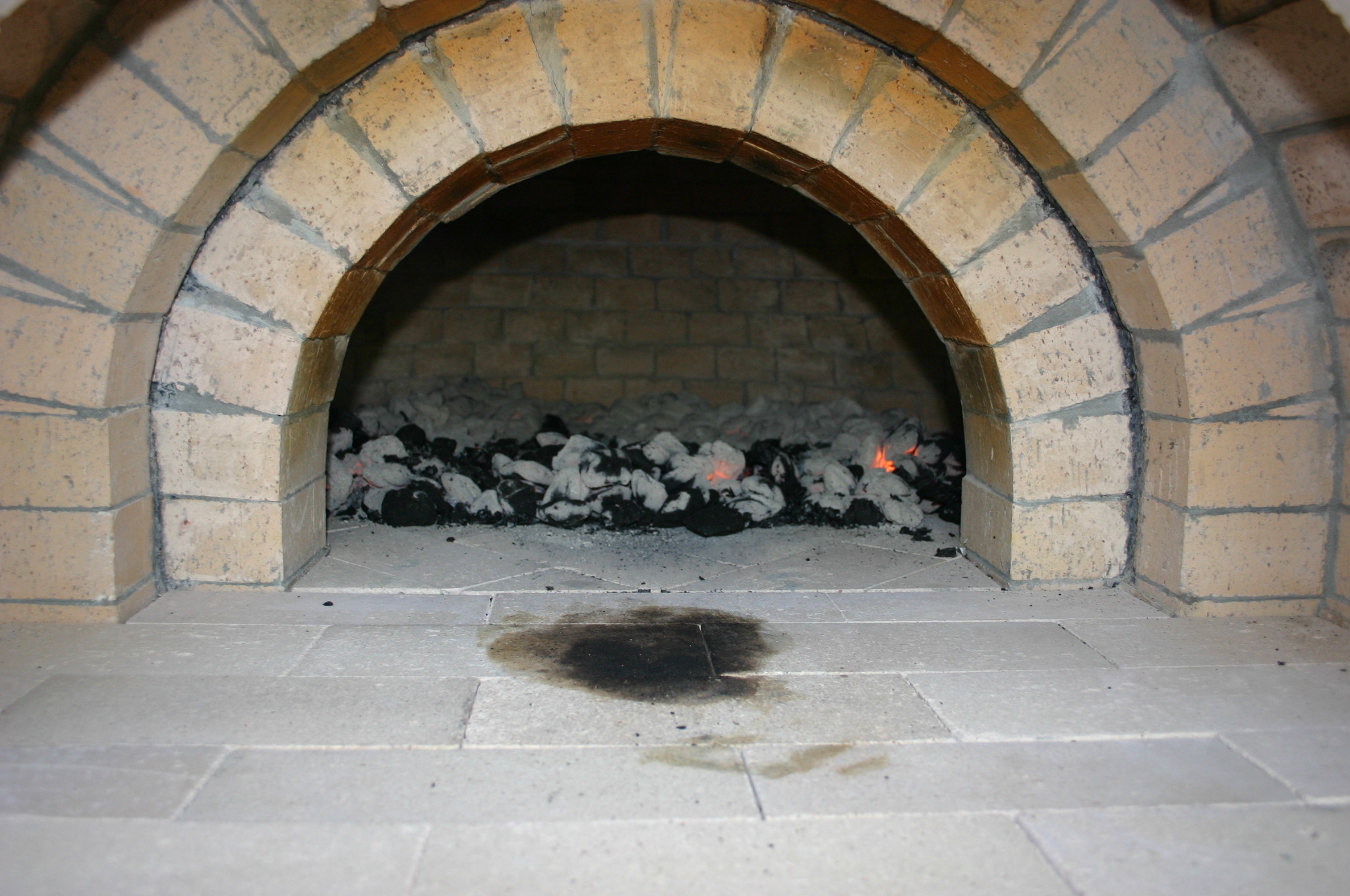

          Originally posted by Gulf
          For the first drying fires, charcoal briquettes or lump (lump burns hotter) is a little more forgiving. They can be started in a chimney and then placed around on the oven floor. No charcoal starter fluid, though . Paper only .
          I used a c-clamp to temporarily attach a charcoal starter chimney to an old broken boat oar. A 3/4" ripping would work. It wouldn't be too hard to attach one to an old broom handle. I lit each chimney in the entry with paper. When it was going good I just slid it through the door and dumped it where I wanted it. The chimney will barely fit through my door so it may have to be tilted for ovens with lower doors heights. It could probably be started on a portable charcoal grill and just shoveled in to the oven. I started by placing the first load in the very center. I just worked my out of from the middle of the oven towards the dome walls with successive placements. I would add a chimney full back to the middle from time to time as it burned down. It was an all day affair. If I remember right, I had bought 3 double bags of 20 lb Kinsford briquettes that was on sale at Lowes. I don't think that I got very far into the third double bag. Toward the end of the day it took less and less charcoal to maintain or raise the temperature. Again, it worked pretty good for me. But, I did not begin the charcoal drying right after laying the dome brick. Due to work and other projects, it was several months before I began the process.
          I hope this helps.
