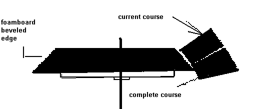

    Movable floor drawing.
    Well I am afraid this is the best drawing I could get to upload due to file size.
    I beveled the edge of the "floor" so that it would give some error room when cutting. I would not have to cut it perfectly.

          The diagram does the job Wade - confirms my minds eye of your idea.
