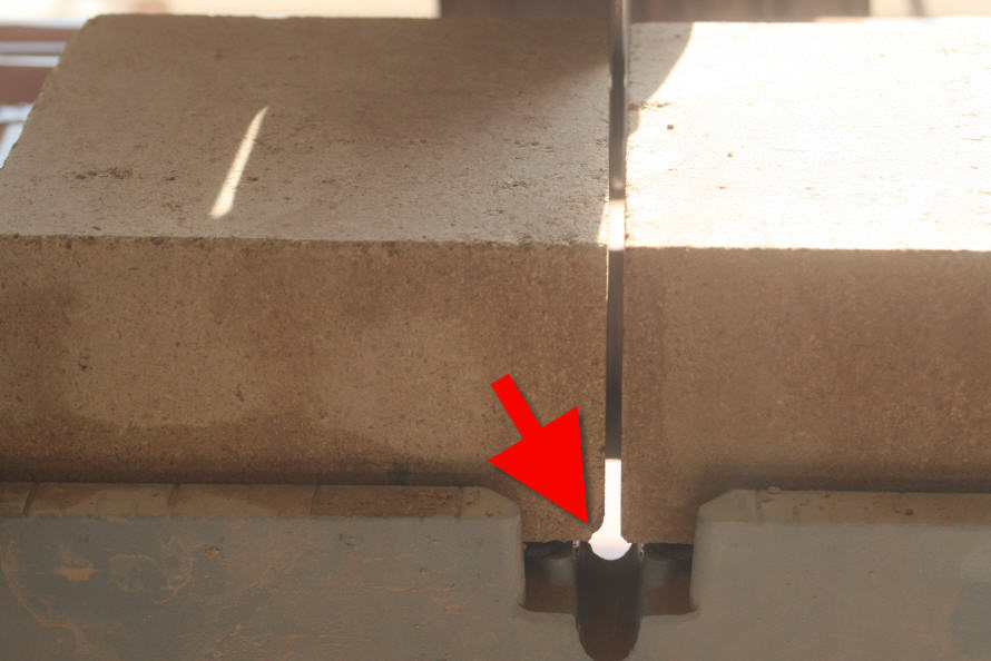

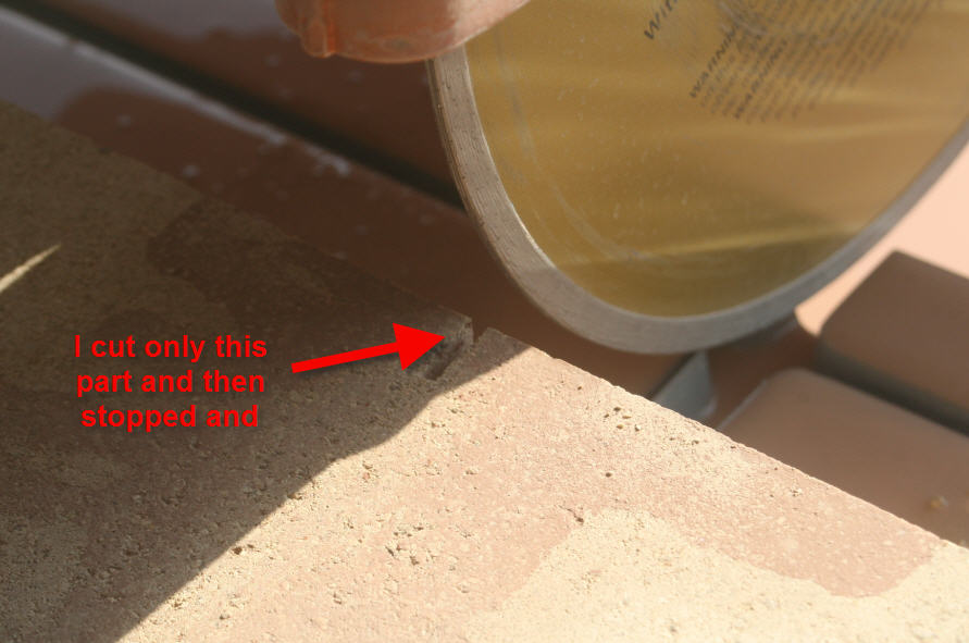

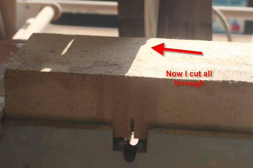

    Cutting bricks technique
    Today I started cutting bricks with my HF wet saw and I noticed that often the last corner of the brick would chip and because I want to use the cutting side to face the internal part of the oven I want them to be clean and clear. So I decided to cut only 1/2 inch the brick and then flip it over and finish the cut, it worked very well and all the bricks came out nice. I put some pictures so you can see.

      I mostly used the cut side of the brick towards the interior as well - they were smoother than the original end of most of the bricks. In hindsight, it might be a bad idea. Apparently, the bricks have something of a glaze on the outside that makes the original face of the brick stronger than the newly exposed cut surface. I encourage comments from others on this as this is just derived from my readings.
