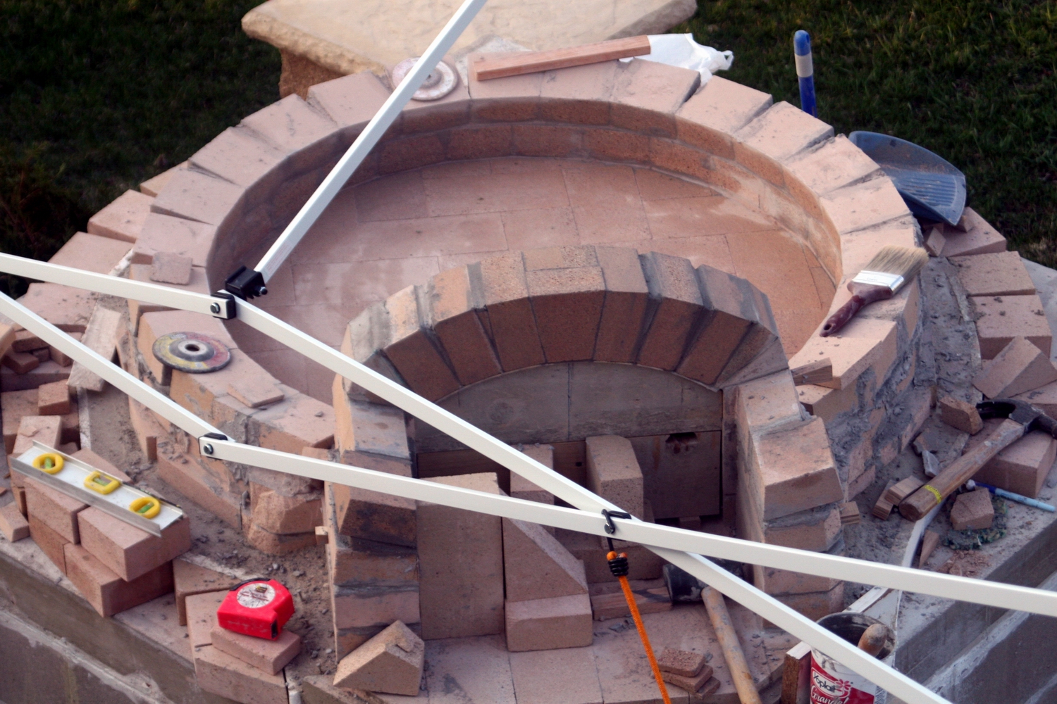

          • #50
            Row 8 finished
            little update ....Worked all week end and went up to row 8, now starts the hard and difficult work!
            Ciao Carlo

                    • #55
                      key stone in!
                      Over the week end the dome was closed and arch for the vent finished, had to buy the 4th 50lb heat stop mortar, not much used but I'll use it to cover the dome.
                      I prepared also the transition plate for the next step...

                        • #57
                          Re: Pompei oven progress from Carlo
                          I thought the last part would have been the most difficult, I was wondering what to use for the last few rows, an inside ball or casting...looked at the different techniques on the forum and decided to use clamps, they worked wonderfully, I finished the last 2 rows + the key stone in the same day.
