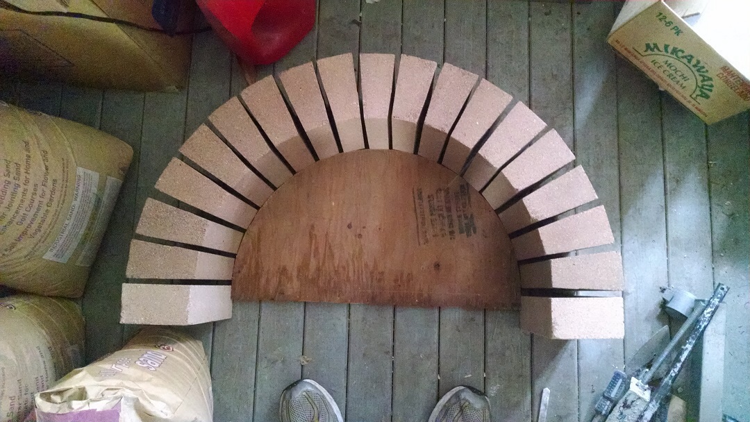

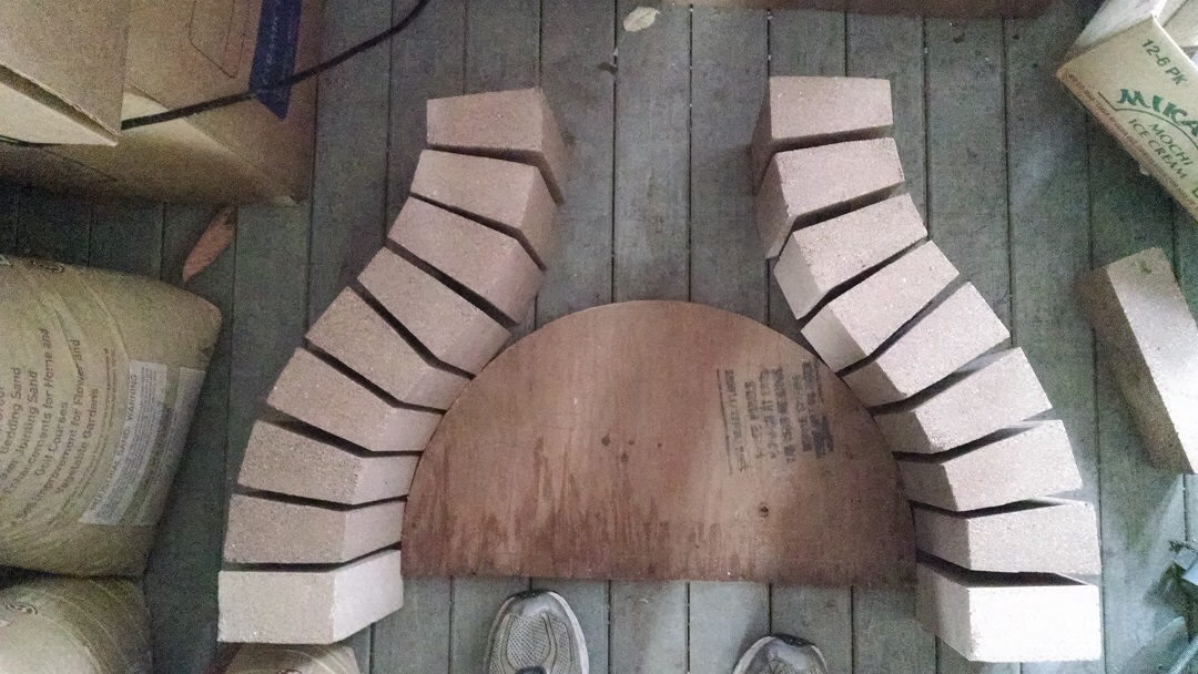

          Something very odd going on then. The number of pictures in his screen print and your screen print are different! Maybe delete all cookies and clear your cache, and then look at his post again? It's possible your computer is picking up something from your cache instead of reloading the page (that could make sense for the difference pics you see,but still doesn't explain different pics in the screen prints!)
          These are the 2 pics that I see as pics one and two. A regular arch and a double "S" arch

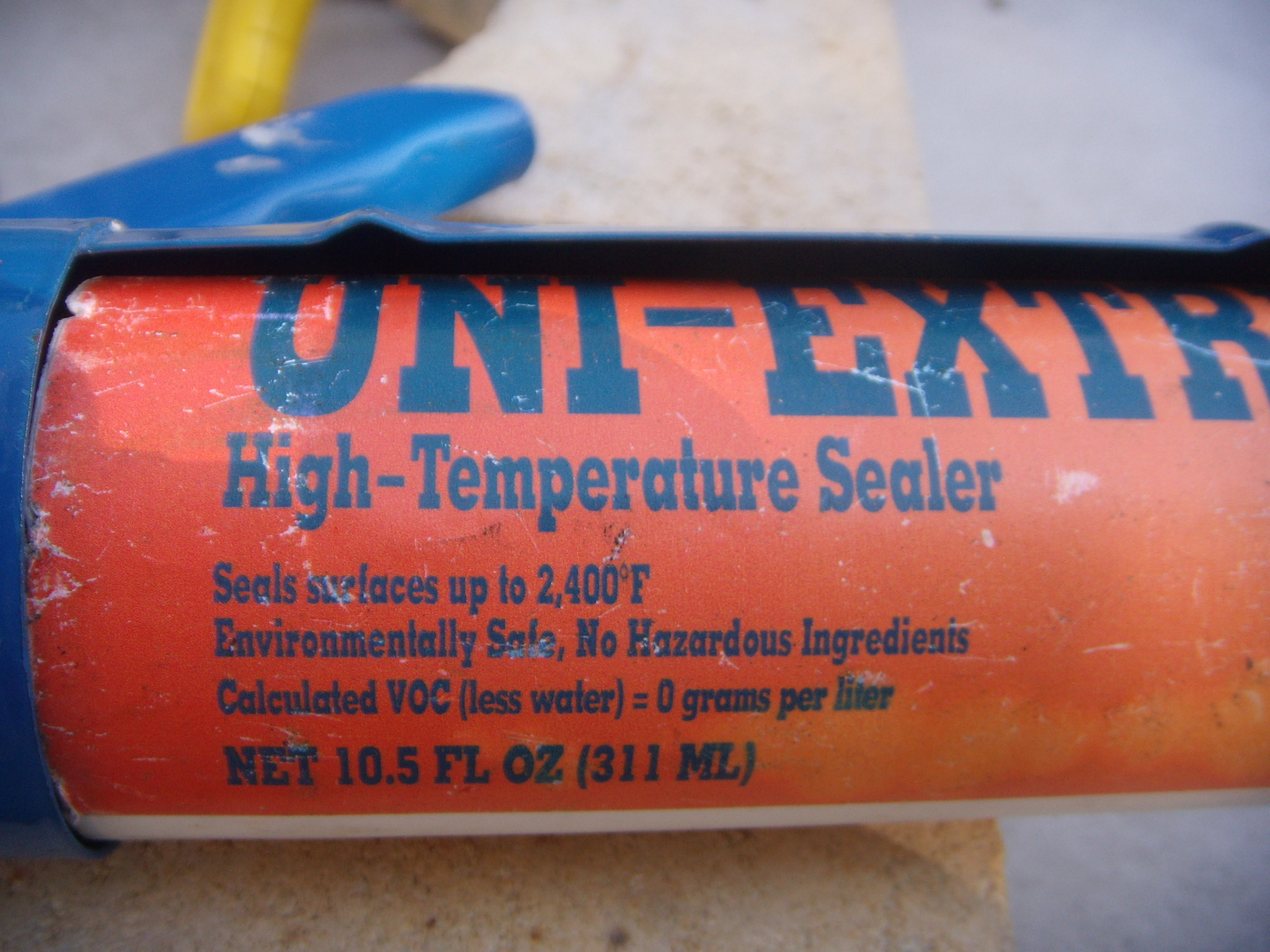

                      I used Uni-Extreme made by McGill Airseal it is good to 2400 F and environmentally friendly. I is NOT silicon based and sets up firm. Used it to seal in my CF rope on my arch heat break. Click image for larger version

                        Russell, did you buy the Uni-Extreme online? I found an online source for the stuff RandyJ used, but could not find a source for your produce. Plenty of info from the McGill website but did not see any pricing.
                          #177
                          JR,
                          I found it at a surplus store that I frequent every week. I bought all they had for a buck a tube and sold the extra to other members on the forum for cost plus shipping. Unfortunately I sold them all. So short answer, you may have to call them and see how much. There is a another modeable caulk called kawool cf caulk that is good to 2000 f. I have not used it personally but others have. I think it is about $20 a tube.

                            Wow, a dollar a tube was quite the score. I was able to search, now that I have the brand names (thanks to all) and found both Kawool and Inswool moldable for about $15 a tube. I also found some for $42.73, do I guess it pays to shop around
