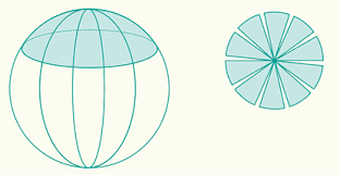

I'm getting ready to wrap my insulation, and had a question especially for Russell, but others please feel free to chime in. I have 1" blanket, in 2' wide 25' long rolls. I'd like to get the blanket wrapped with as little overlap at the edges as possible, so I don't have to do as much compensation with the v-crete to make the dome round. I'm planning on doing at least 3 layers. Russell's wrap job looks exceptionally done, so I was wondering if he did any special technique with either sequence or how he cut it to conform. I watched the fornobravo insulating video, but was hoping to not end up with a bunch of small triangles left over, unless that is unavoidable. I have an idea to cut pieces like the picture shown below - I think I can do it with very little waste.
Thanks for the quick reply! I figured if I cut them using the 2' width at the bottom and to a point at the top of the oven, I can take the two pieces from each side and make another triangle, if my geometry is correct. I'll have to use some bits around the chimney I know, but the orange segments should minimize my waste.1 PhotoMy build thread

I finished my insulation today. Planned on cutting the insulation into orange peel segments as discussed above, bit abandoned that after I put two of them up and saw my hopes of having everything "just fit" weren't happening. I ended up cutting strips (6" to 8") of various lengths and tried to replicate what the FB guys do on their insulation video.

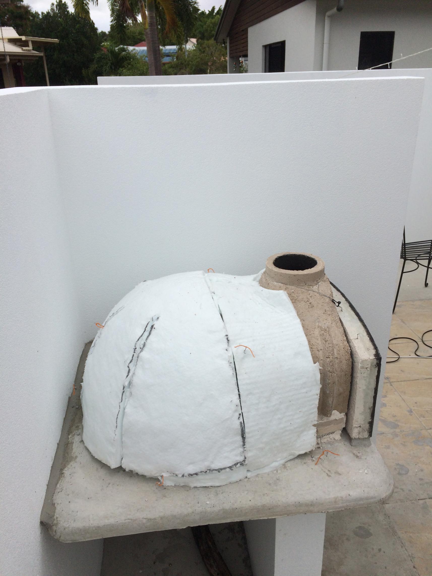

For the triangles to fit you need to make the sides curved. I do a similar thing marking out the blanket with a template and spray paint. Cutting the blanket with a slight bevel then results in a perfect fit. [ATTACH=CONFIG]n387850[/ATTACH]Originally posted by JRPizza View PostThanks for the quick reply! I figured if I cut them using the 2' width at the bottom and to a point at the top of the oven, I can take the two pieces from each side and make another triangle, if my geometry is correct. I'll have to use some bits around the chimney I know, but the orange segments should minimize my waste.
