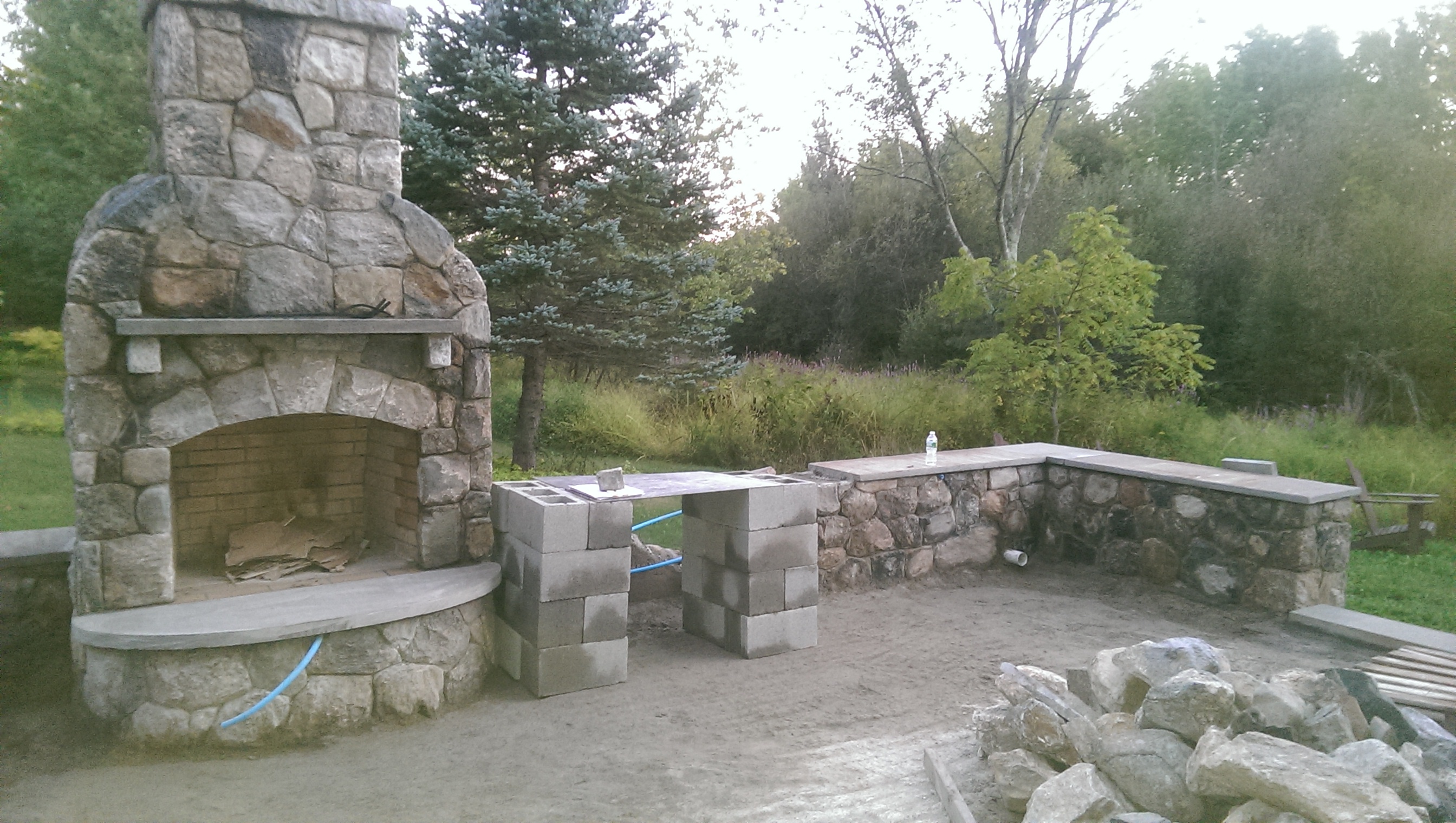

                  Ran into a major problem. I only have 60" wide x 48"deep for a base. My wife doesn't want it to stick out on the back of the wall.
                    • 3885
                    Unless you find another location, I don't see much way around it. Actually, I would set the face of the oven back a lot further back than even what you have shown. As far forward as it is, you will be loosing a lot of the view and the usable area in front of that fine fireplace. Any chance of a corner build?
                      • 5264
                      Is it possible to do a arch cantilever hearth deck. It will give you a little extra room out front and match your fire place hearth. I am not seeing your dimension you gave based on the CMU layout unless the CMUs are bigger than std 8x8x16.
                        I think you will need more room. Can you come out 1 more set of blocks to pick up 7 more inches? I mean come forward? 36 inch dome is going to take at least 50 inches i would think.

                          Trying tof figure out how I can extend it further by going deeper into the yard. How many bricks does the typically take to construct?

                            I would do a corner build looking at your photo, it also would not crowd the fireplace and give you more cooking room
                              Build a smaller oven and or keep the entry shallow.
