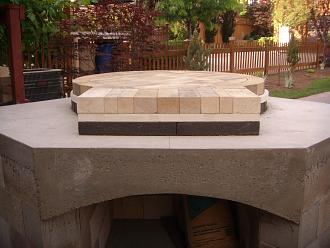

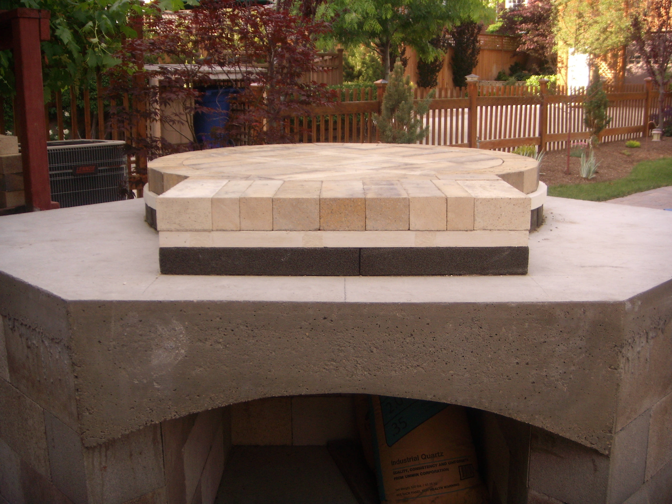

                        Yeager,
                        I elevated my CaSi insulation by placing FoamGlas insulation (which has thermal conductivity properties similar to CaSi) underneath which is water proof and would not absorb moisture. But there are lots of ways to skin the cat. As you know CaSi gets mushy when it gets wet.
Name:	30A Brick Floor on Insulation 5.30.12.JPG

                          Heatbreak - For the "heat break" doesn't the hot bricks eventually touch "some" of the concrete if it's truly a flush floor? Russel, is your heat break the piece of metal looking item? It has a bricks on outer left and right that still touch. I may be in left field here - sorry guys!
