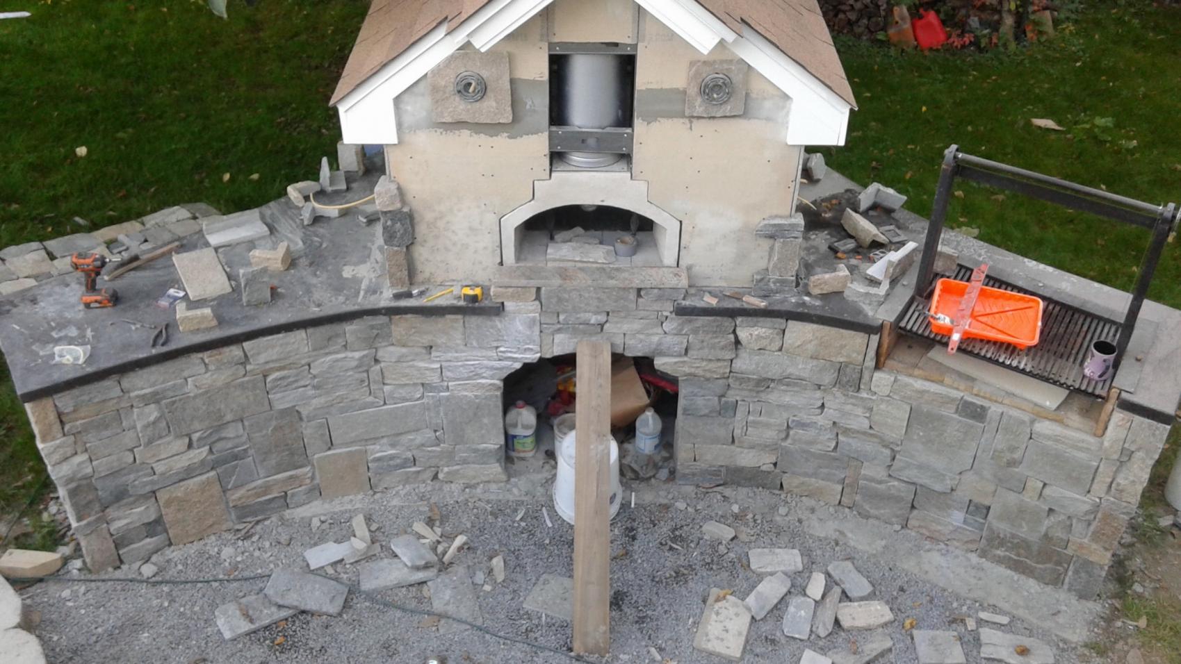

ID:	401941 The stone veneer is New England blend of three different cuts.

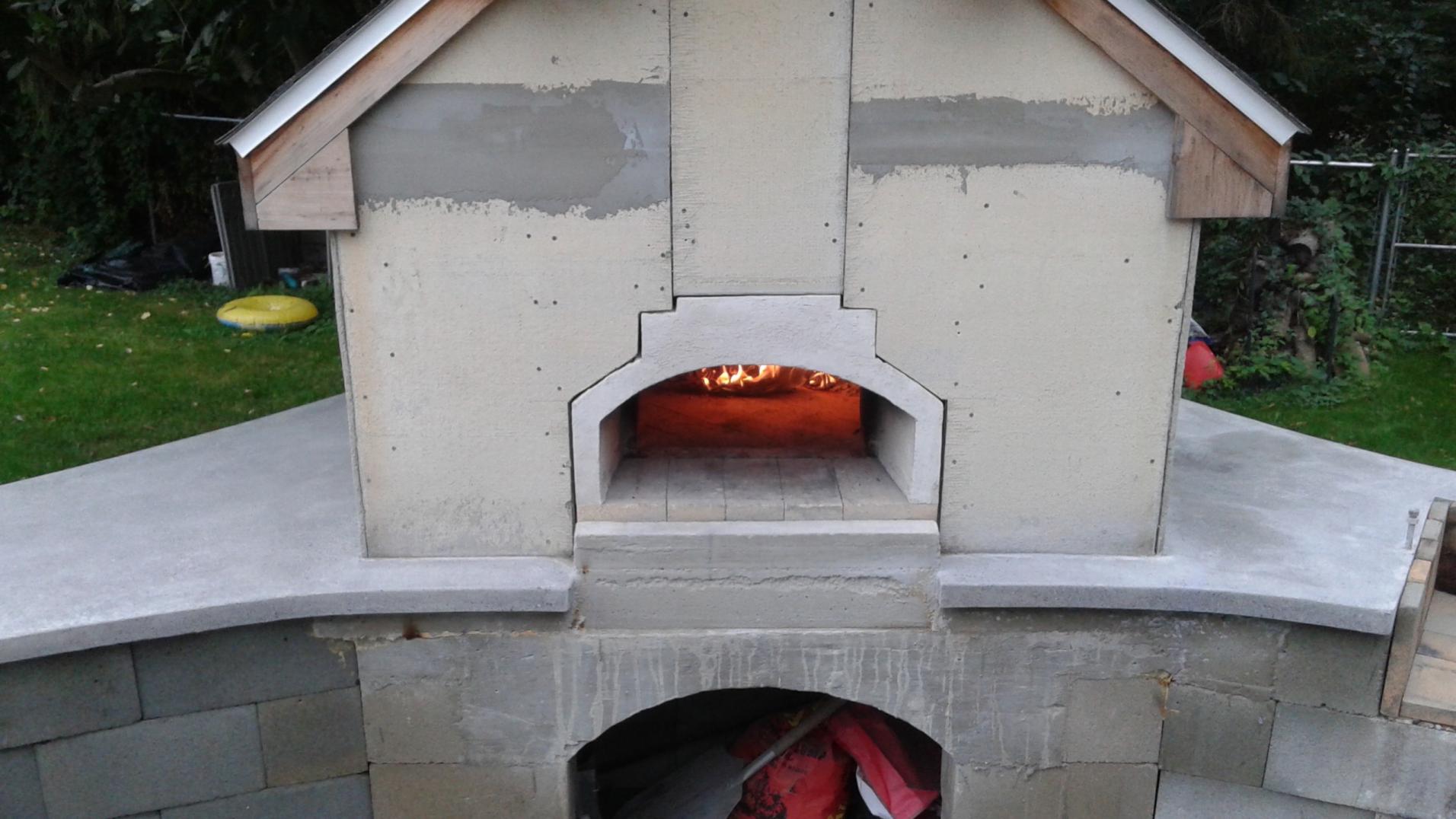

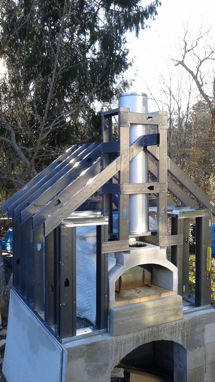

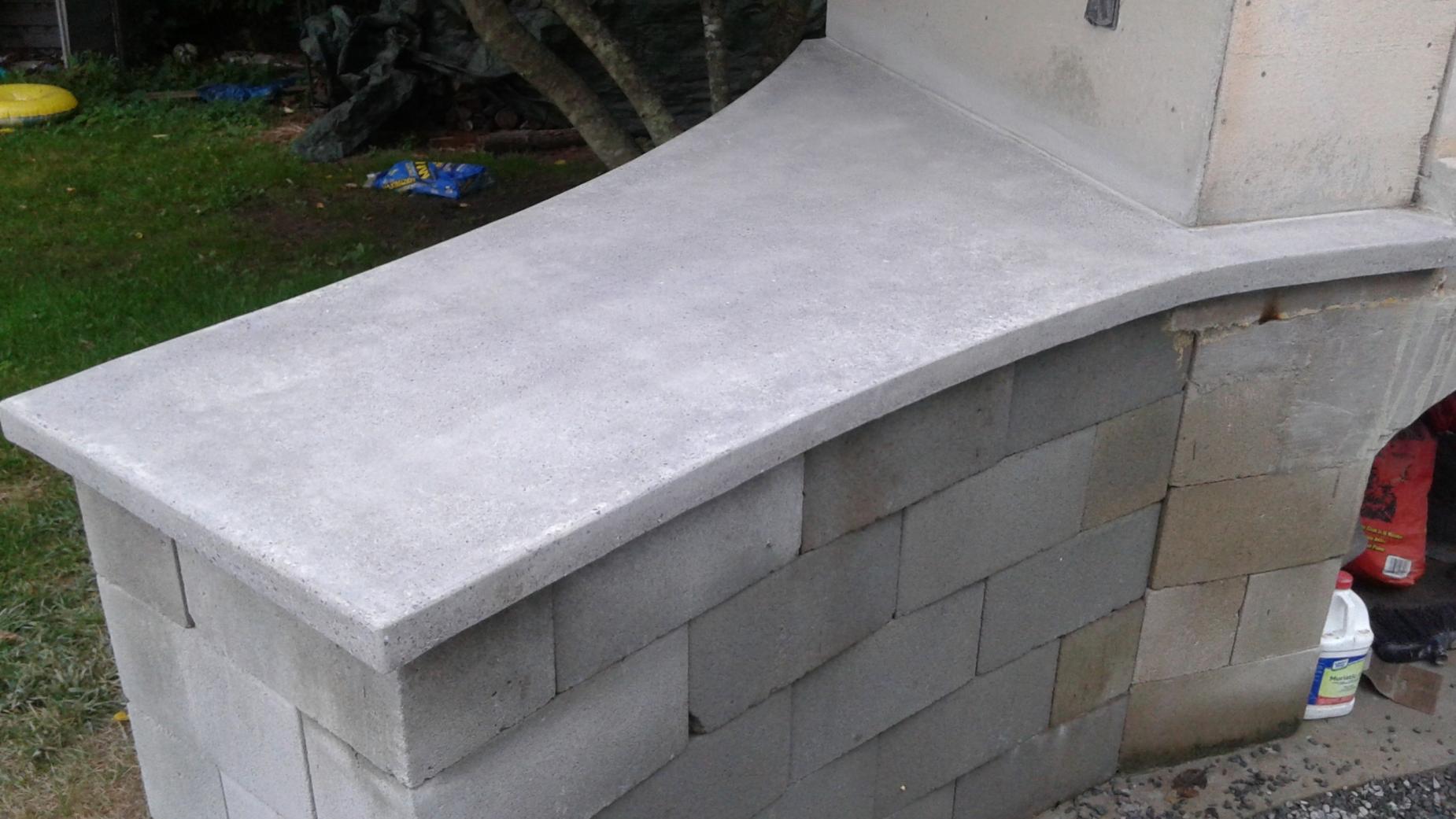

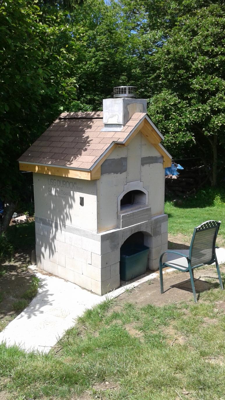

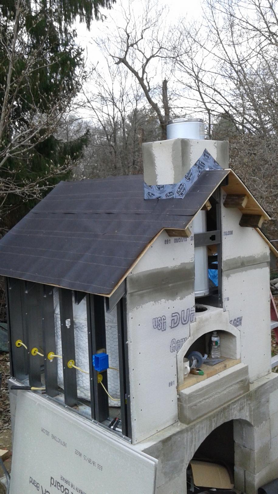

    Since my last post I have been busy with other projects so the oven took a back seat to everything else. I have made progress. I built a dog house around the oven using metal studs, covered it with cement board and put on a roof. I also added 2" concrete countertops. One side is a prep table and the other surrounds an Argentine charcoal grill I built with a buddy. The countertops have been polished and I'm waiting for the stain and sealer to arrive.
ID:	401932Click image for larger version
ID:	401933Click image for larger version
ID:	401934Click image for larger version
ID:	401935Click image for larger version
ID:	401936Click image for larger version

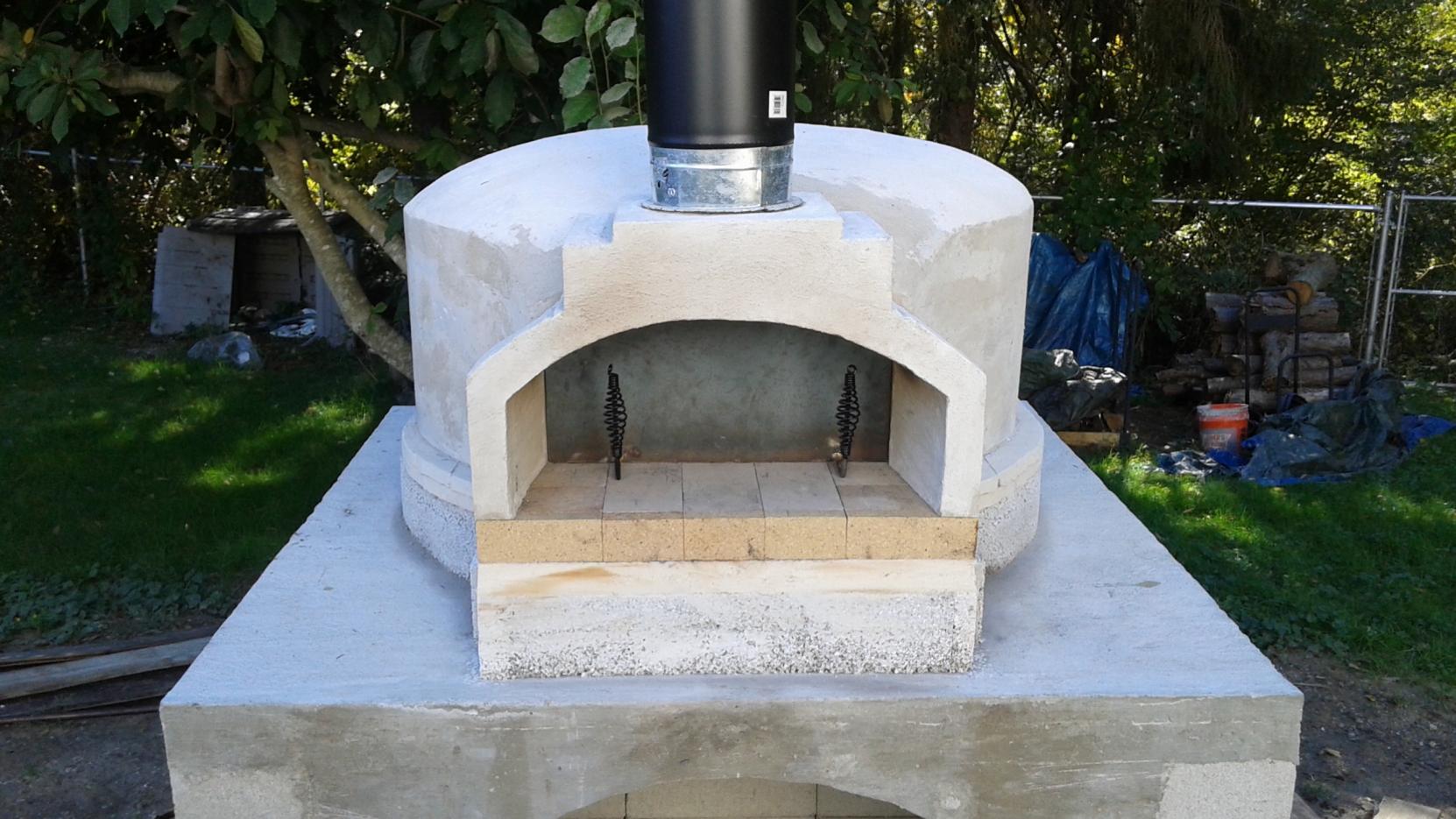

    I had to expand the perlite insulating area, it was too narrow. I also started my curing fires yesterday and added a thermal break using the ceramic fiber rope between the dome and vent and the floor.

    Thanks, I struggled with the design of the flue gallery. I thought 12" deep was too much but I needed it 2" thick on both sides of the 8" chimney pipe. I settled on cutting is down and having the 2" overhang the front of the oven.

    I noticed you have made the flue gallery much shallower than your original mould. I didn't want to criticize as you are doing such a good job, but you'll be glad you made it shallow it will be much easier to work the oven.
    With the Homebrew castable, holding the moisture in for a week after casting is a good idea.
