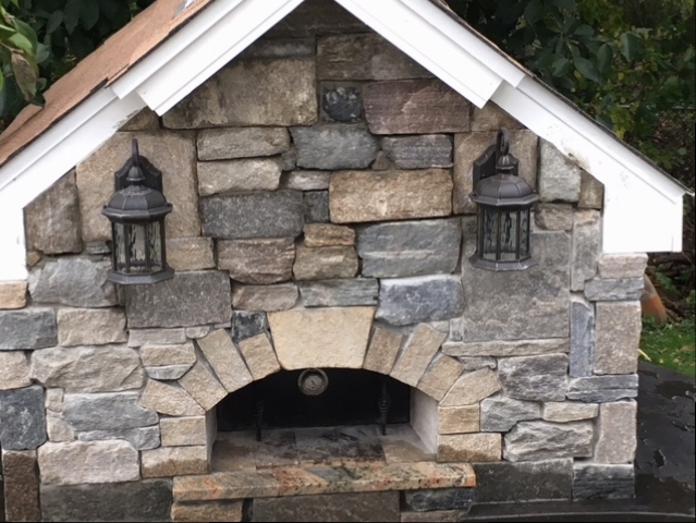

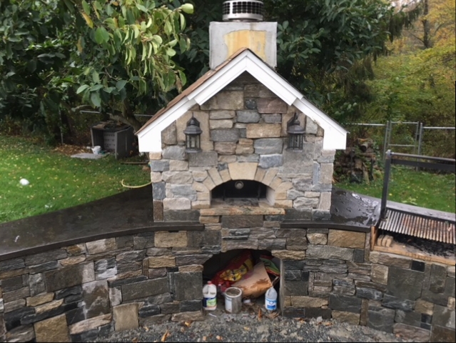

  • purplehaze
    replied
    Finished the veneer Click image for larger version
ID:	402002Click image for larger version
ID:	402003Click image for larger version
