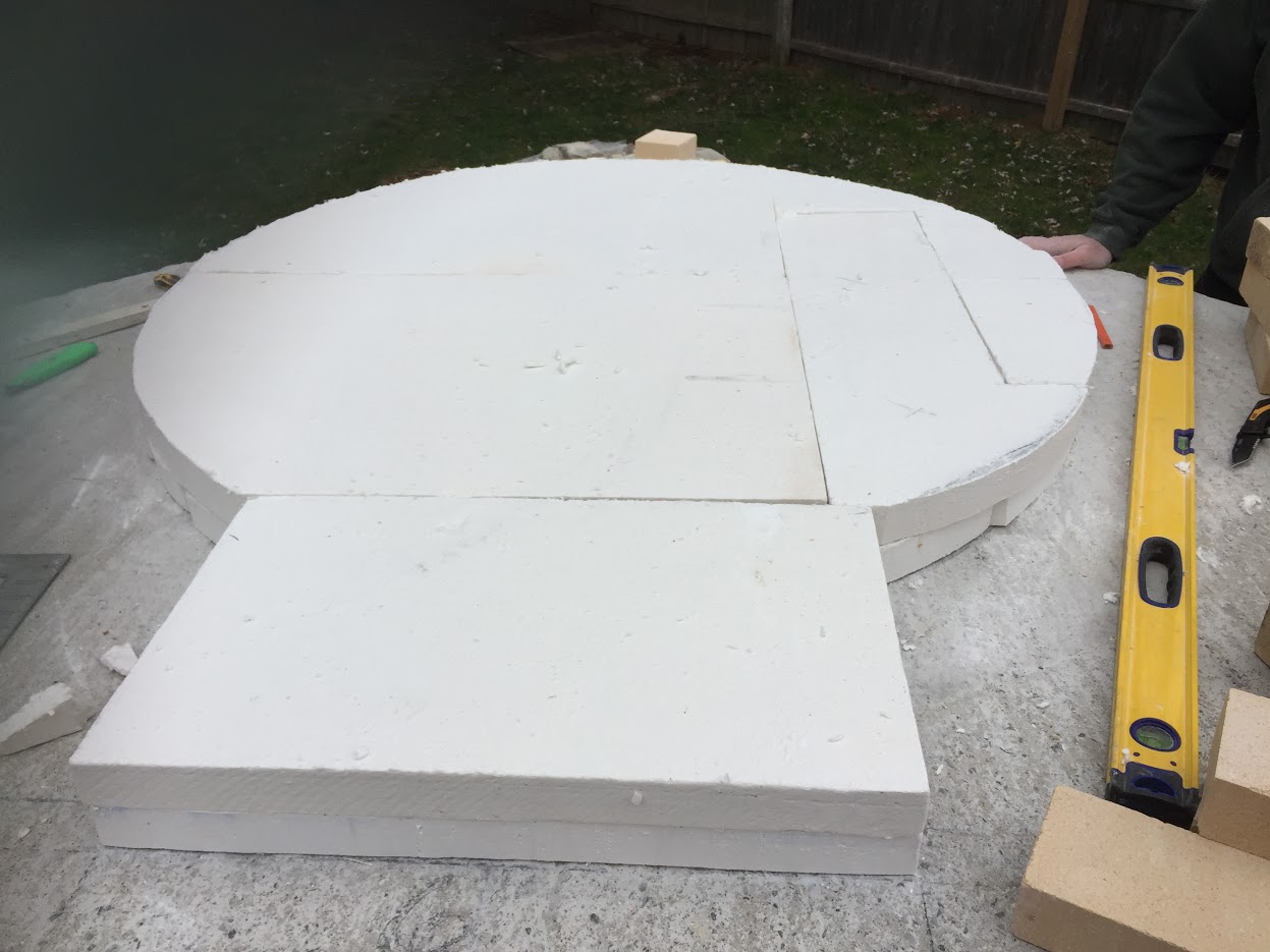

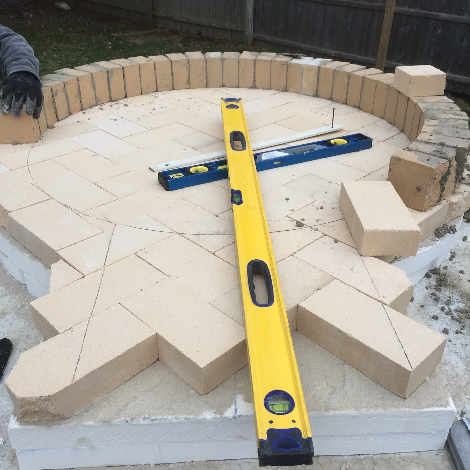

ID:	386412 so after all this talk, i somehow neglected to put the vapor barrier underneath the insulation, i have two options... 1. i redo it, 2. you guys convince me not to redo it because ________. 3. some other option/combo of the above.
        i wasnt planning on covering it with a 'dog house' or a roof over it. i put down the 4 inches of insulation, fireclay/sand, and laid the brick floor and completed most of the first course. not a terrible amount of work done, but i dont want to regret it in the future if i cant get the oven to get hot or hold temps.

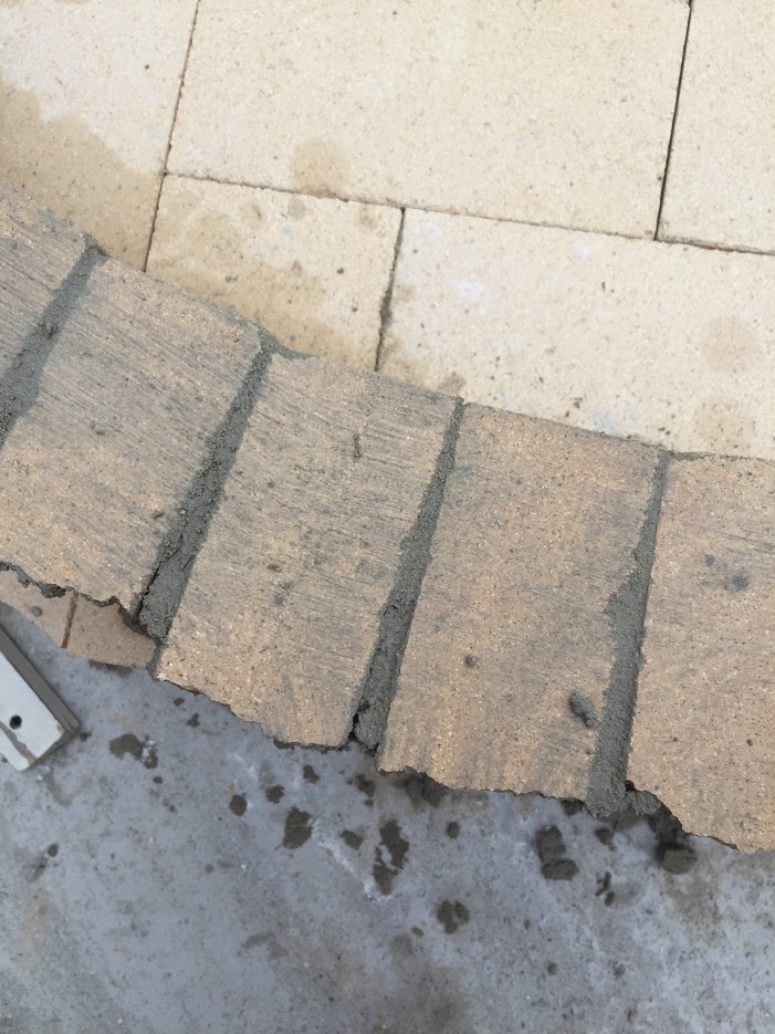

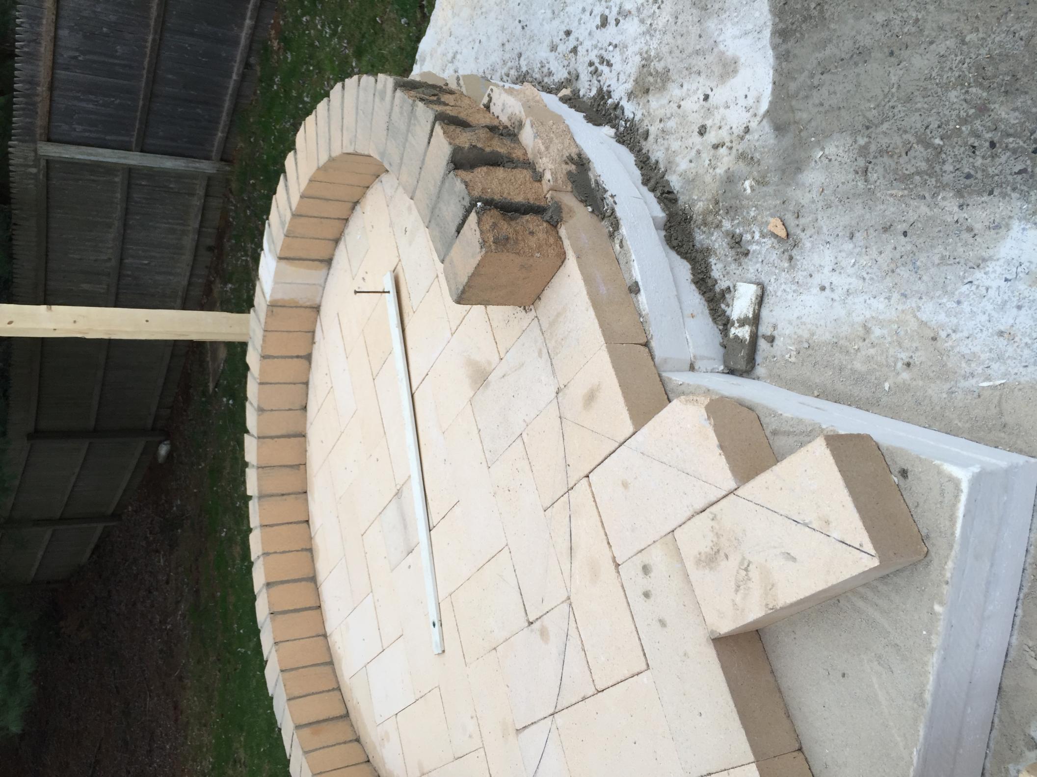

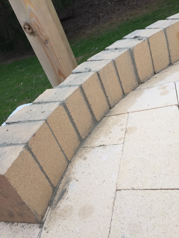

                here's what i have done this weekend. i dont think that i have gone too far to start over. i am still trying to 'wrap' my head around the vapor barrier idea. let me see if i understand this correctly. The VB prevents moisture from coming up from the slab, but if i waterproof seal the final coat of the igloo all the way down to the floating slab, will that do justice from regular rain? i plan on putting some sort of counter top down,(not sure which). if the slab gets wet, i am assuming that even though the outside is sealed, water will still saturate the insulation from the pad when it gets wet, right?
                and even if i don't redo it and just waterproof the outside, once the insulation gets wet, when firing up, the water needs to go somewhere, so does it take longer to heat up? or will i struggle to get high temps if the insulation is wet and can never really get it dry? what if i just drill three holes from underneath the slab to the top and carefully stop once i hit the insulation, will that do anything?
                if i put the VB down, drill a hole in the center of the floating slab and barrier so the water, if it gets in through the door, has a place to go.
                i figure i can break it down and put it back to where it is today in a couple of hours, i didn't get that far mortaring, my slab was level so only minimal leveling was needs under the brick. I am laying the first course on top of the floor and all the outside cuts are done with a chisel. didn't want to waste time making the outside perfect if it was going to be covered up.
