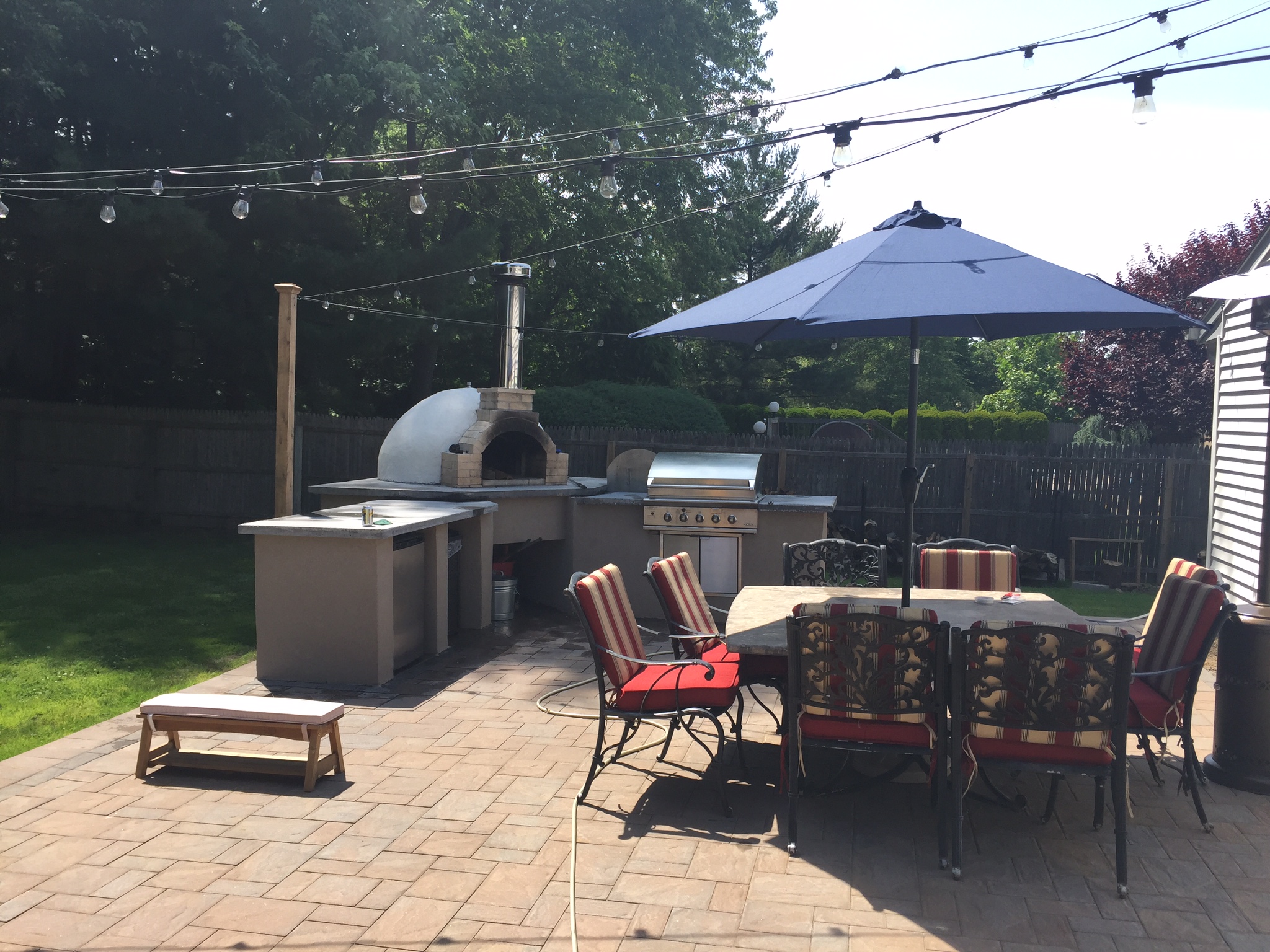

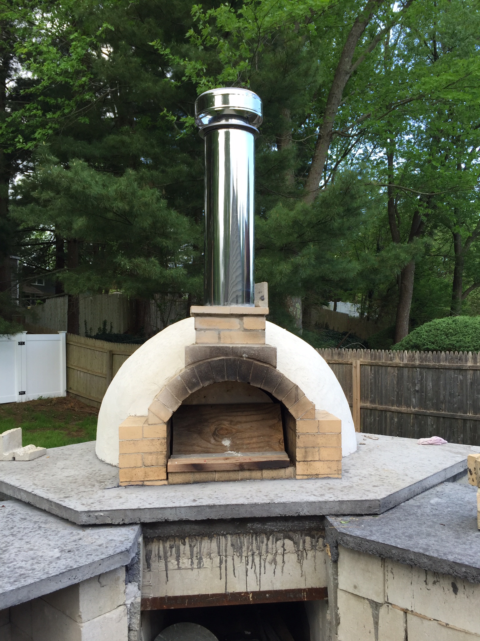

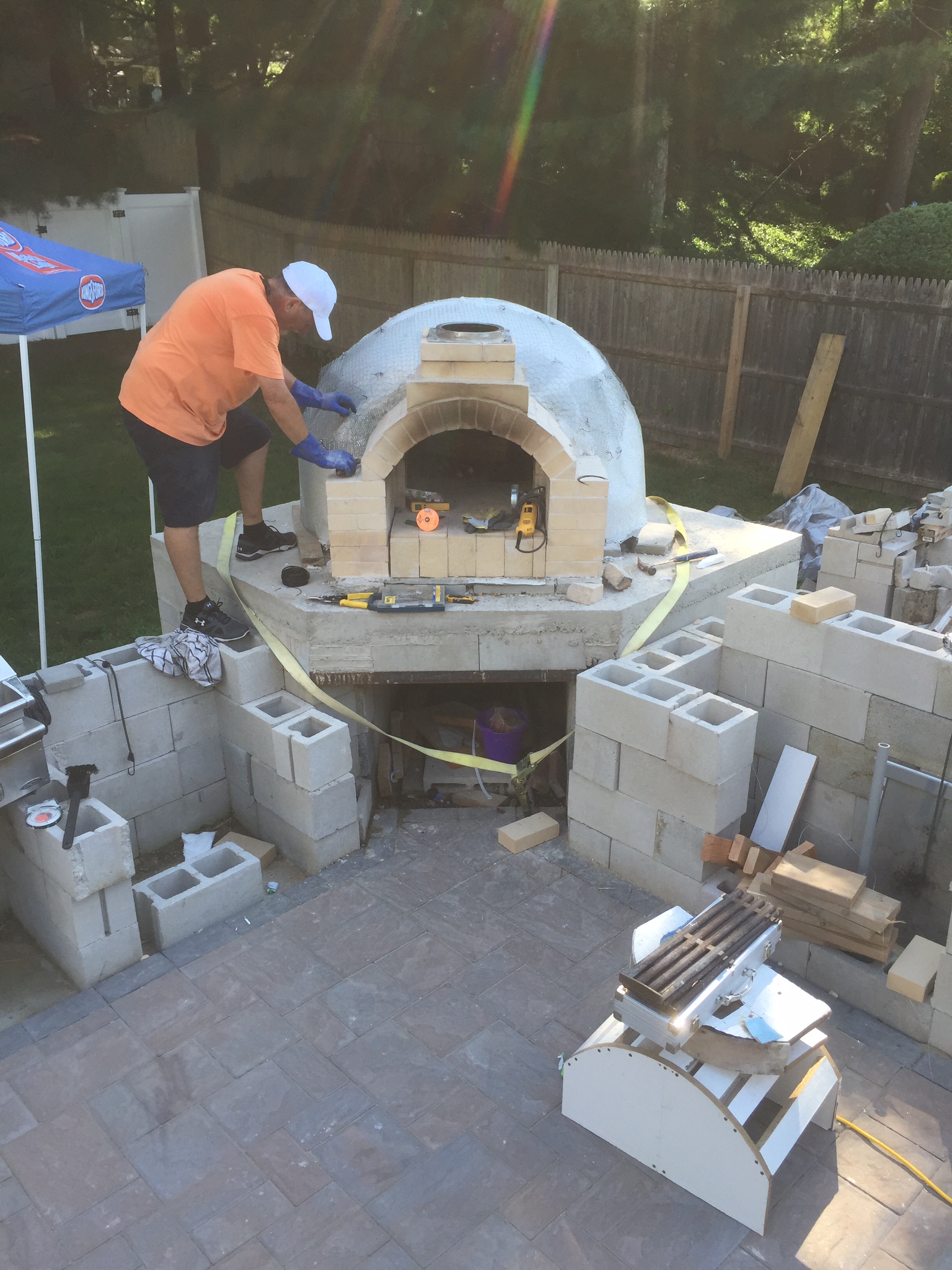

                              Bringing this one back to life. It’s been a while... I’ve come along way in the past two years Click image for larger version
ID:	404527Click image for larger version
ID:	404528Click image for larger version
                              • joeykramer
                                • Apr 2013
                                • 86
