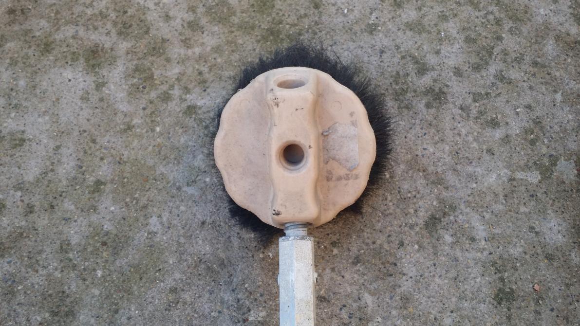

                        One more thing: I made a broom to sweep out a cool oven: a horsehair drywall stippling brush on a short painter's extension pole. It works really well for getting the floor/wall juncture of a round oven. Horsehair also does a great job of thoroughly removing fine ash due to it's length and softness. I'm sure someone has already thought of this, but I wanted to toss it out. I'm going to try to post a photo, but I sometimes have problems with that.

                          #72
                          Here it is! Click image for larger version
