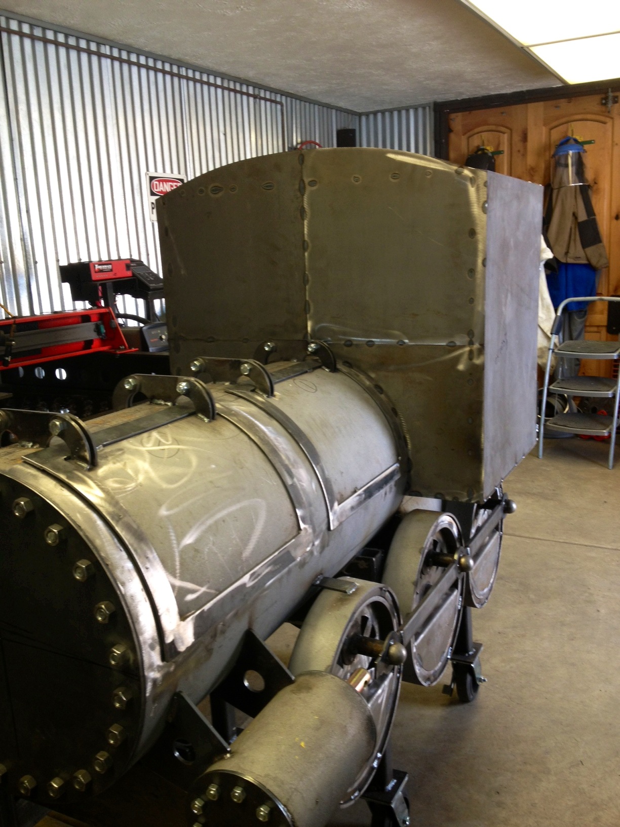

          Shish, I didn't even notice the second BGE. Then you will appreciate this. My coworker built this smoker from scratch, We were both in the pipeline industry and all the materials are steel pipe or fittings or plate.He by far is a much better welder than I, I was just an engineering nerd, but handy.

              Russell, I love that grill. Talking about craftsmanship!! WOW!! I assume the resemblance to a steam engine is intentional. I am a train nut too. No worries about the photos.

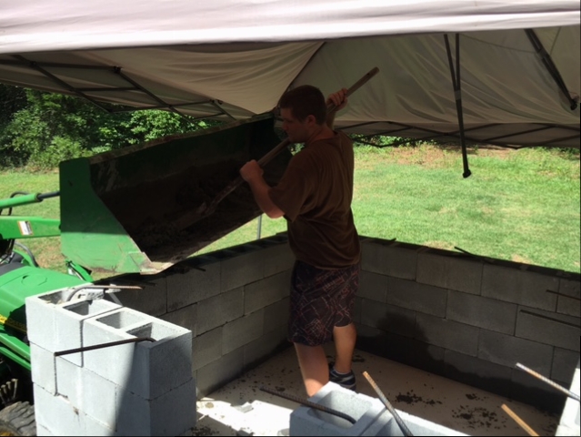

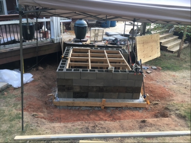

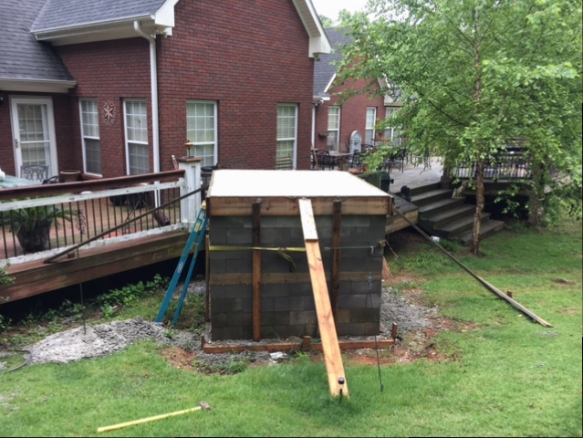

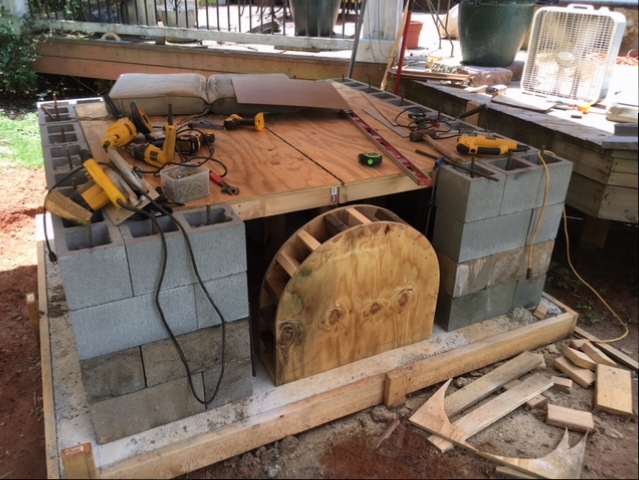

                      Wow, its hard to believe that it has been almost a year since my last update. I have progressed, though. All concrete and block have been placed. Poured the hearth slab this past Tuesday. Now the fun starts, building the oven.
                      Progress photos. Click image for larger version  Name:	IMG_0194.JPG Views:	1 Size:	287.2 KB ID:	398373
                      Click image for larger version  Name:	IMG_0198.JPG Views:	1 Size:	239.3 KB ID:	398374
                      Click image for larger version  Name:	IMG_0215.JPG Views:	1 Size:	199.7 KB ID:	398377
                      Dan
                      Build Log
                      Build Photo Album

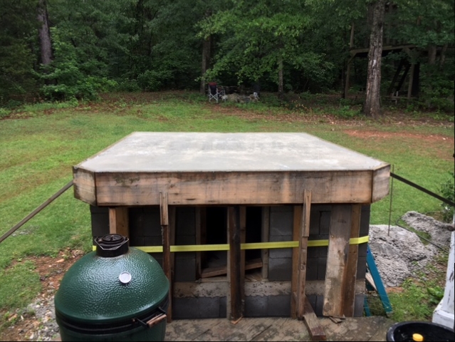

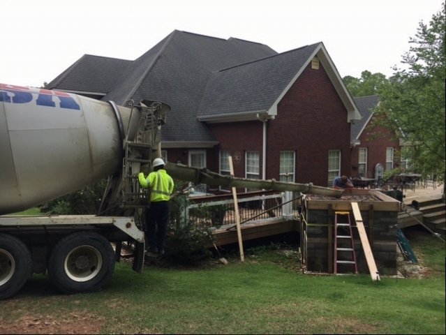

                          Current progress. Notice we finally got smart and just made a simple phone call to get concrete. Much quicker and less tiring.
                          Pulled the side forms off today. Will remove the interior forms at some point. Not in a real hurry to do that right now. The hearth slab ended up being 86" x 98" x 8". There is a 12" overhang on the front. Hopefully the oven itself will progress somewhat quicker once I get started.

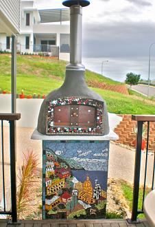

                                #30

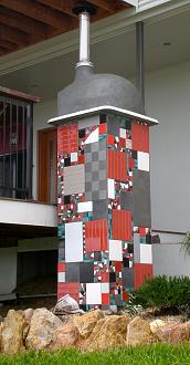

                                Here's one on a raised deck a lot higher than yours. The mosaic is of Positano
Name:	Ryan and Teena's oven.JPG
ID:	398390Click image for larger version
Name:	Ryan and Teenas oven.JPG
