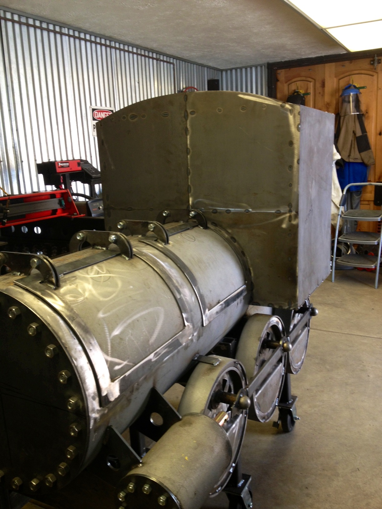

          Shish, I didn't even notice the second BGE. Then you will appreciate this. My coworker built this smoker from scratch, We were both in the pipeline industry and all the materials are steel pipe or fittings or plate.He by far is a much better welder than I, I was just an engineering nerd, but handy.

              Russell, I love that grill. Talking about craftsmanship!! WOW!! I assume the resemblance to a steam engine is intentional. I am a train nut too. No worries about the photos.

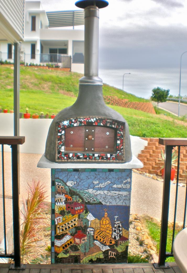

                                Here's one on a raised deck a lot higher than yours. The mosaic is of Positano
Name:	Ryan and Teena's oven.JPG
ID:	398390Click image for larger version
