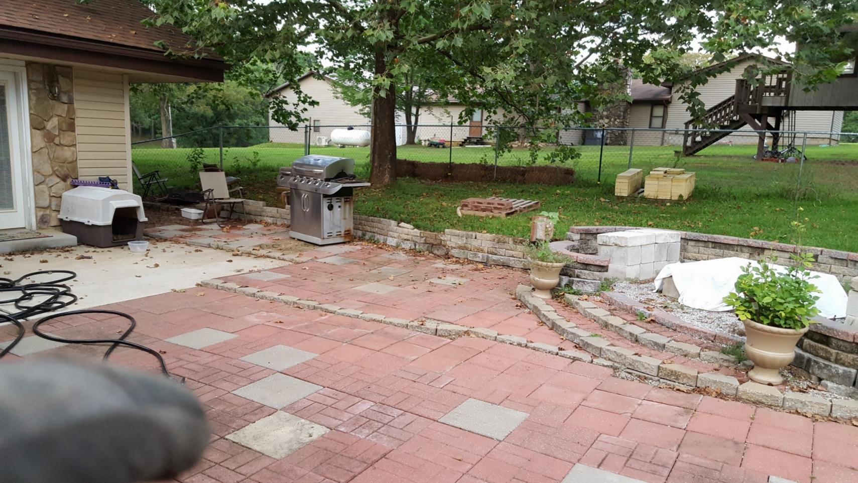

Finally got my build started. This will be a full outdoor kitchen with Pompeii 42 inch oven. I will be doing soldiers on the first course and I am interested in an indispensable tool if anyone has one. Due to the winter coming on this will set till spring if I cannot start and finish the dome in a weekend.

Looks like a great setup. One caution - unless you're an experienced mason, I would check your expectations about how quickly you can finish the dome. My experience, it is not a project that a newbie can finish in a couple days. I've only seen one dome on the site finished that quickly, and that was by an experienced mason.

Its pretty much on hold till spring if not early summer, based on my readings it is a slow process to build. Just getting to this point was a benchmark and I will do all my inside work. patterns etc and be ready for spring. We are finding that there are standard measurements for the base that allow for less waste and fewer cuts. thanks again for all suggestions.
