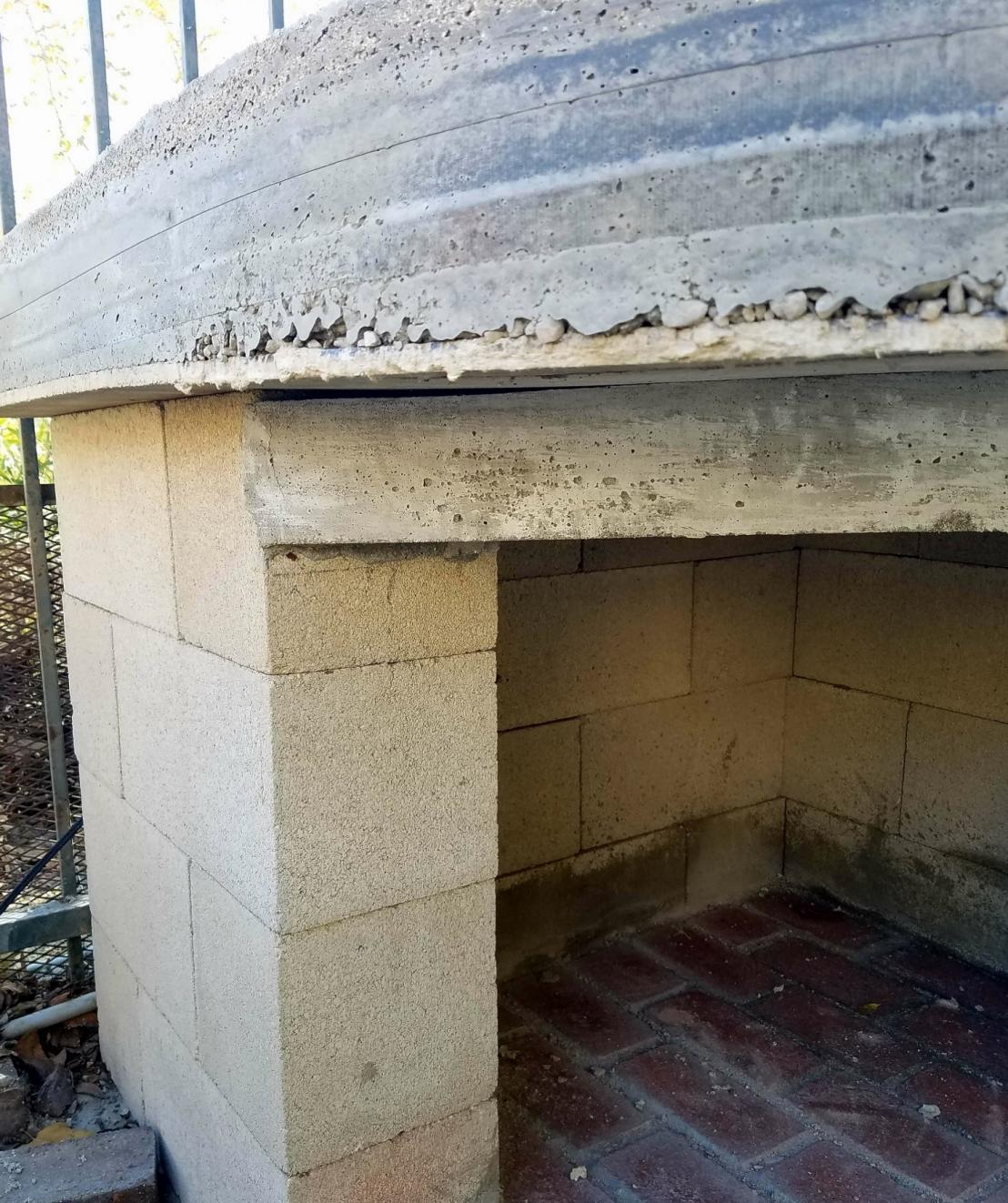

                    So fellas, I have built my slab out of 3" of reinforced concrete with about 3" of 7-to-1 Vermicrete on top. Now, I am concerned about water getting into the vermicrete due to rain, etc, and not draining well. Am I supposed to stucco the vermicrete slab before I build the brick floor and dome on top of it?
                    What are the pros/cons to stuccoing my whole base and slabs now (after allowing the vermicrete slab a week to dry)? Any downside to building the dome and pizza floor on top of stucco? I guess the alternative would be to build the pizza floor and dome first and then stucco the slab only in areas not covered by the dome.

                      #25
                      Why do you want to stucco the slab? Stucco isn't waterproof or structural, nor does it provide any thermal benefits

                        Deejayoh is right. You don't want to stucco the floor insulation. That will trap a lot of water in that would be very difficult to get out. Also, it would be best to wait as long as possible before building on the vcrete. The sooner you build on it, the more water that will be trapped under the oven floor, which will have to be delt with later during the drying phase. Just carve all the excess vecrete out down to the slab when you know exactly what you oven's rendered foot print will be. It wont be very difficult to carve. Protect it from the rain a;; through the build.
                        Just, for those future builders that are following this thread: It saves a little trouble if the vecrete is formed to shape before the pour.

                          #27
                          Gulf,
                          what would be the purpose of carving out the vermicrete from around the footprint? I haven't seen that done before. I can't leave it and stucco over it?
                          Also to the other gent that asked about why I would stucco, I just thought it would be nicer cosmetically and provide some water resistance.
                            #28
                            I haven't seen anyone carve it out either, except to anchor the bottom plates for an enclosure. I also haven't noticed anyone pouring the vcrete outside of the footprint of the oven for an igloo. I suppose it could be stuccoed over outside of the foot print of the dome. Provided that you contour the render from the dome over it and keep it sloping downward each direction to help shed water. Just keep it protected from the elements and don't stucco over it until it is dry or you will trap megga amounts of water.

                              #29
                              So, just to be clear... concrete isn't waterproof. Neither is stucco. And vermicrete is basically porous, and will fill with water like a sponge. All of that water is going to wick water under your oven and keep it from getting hot.
                              I see you're in SoCal (from your profile) so maybe you'll be ok because it doesn't rain often. But the design of having the vermicrete extend beyond your oven and be exposed to weather is not a good one. Stucco over it may look better but it won't do much good for waterproofing. Maybe an acrylic stucco will. But not cement-based stucco.
                              FWIW, 3 inches of v-crete is not very much insulation. It's about the same as 3/4 -1 inches of CF board. That is less than half to a third of what most builds on this site are using. You might want to think about adding a couple inches of CF board (maybe I just missed that)

                                #30
                                Ok guys, here is what I have so far. I am going to try to use an inch of ceramic board on top of the few inches of vermicrete I have so far in order to make sure the insulation under the oven is sufficient as some of you have mentioned.
                                As you probably know, the vermicrete is really crumbly and doesn't hold together very well. I would like to coat the edge of this slab with some standard concrete or stucco to smooth it out and create a firm finish. Right now it is easy to take a finger to the vcrete and crumble it away at will. I don't like that. Also, there is an ugly joint where my cement board meets the slab. What's the best way to get this done? Which is better to coat the side of these slabs, stucco or some other product?
                                Can stucco be used to coat the cement board underside of the slab as well?
