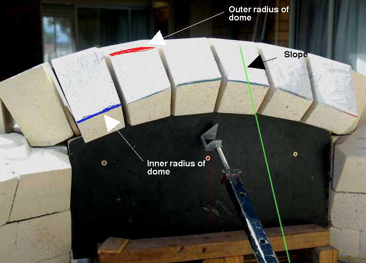

    Kid, without doing a layout I can't tell if the 20 inches you refer to puts the arch in the right location. It's important that your upper bricks fall within the curve of the dome so you can keep your shape round. Two easy ways to tell this - either do a full size layout (cad or paper), or place your arch form at the intended location, place a brick, and do some measuring from the center of your floor (I attached a cad snapshot and a view of a brick sitting on my form). There is some wiggle room here where you can move the arch in or out depending on how much room you have on your landing and if you want to use the arch to help support your vent (which is what I did).
    As far as size of the landing go, it is good to have an idea of how deep you want before you get too far, as it is sort of what sets the distance of the center of your oven from the forward edge. It can't be too short to accommodate the size of the chimney, and if too deep it will be harder to reach into.

      In the pic's, how much overhang is tolerable? For example you show the arch brick with five "sides". In the diagram I've sketched what is the maximum value of "x" in relation to a normal brick, or can it only be zero?

        Hi CK. I am just a few steps ahead of you and struggled with wrapping my head around the arch taper. This is the picture that Russel sent me that made the lightbulb finally go off in my head. To my understanding the Inner Radius of the dome should make the value of X from your diagram zero or close to it.
        https://picasaweb.google.com/1029081...00165373509921
          CamK,
          The X as D419 said should be 0 in a perfect world. this face is the inside diameter of the dome. The height placement of the pivot point of the IT will affect the X distance, ie if the pivot point is exactly at the floor level the X will be close to zero assuming the fore and aft of the arch is correctly places. You will need more the a half a brick for a tapered arch with the Top Dead Center arch brick being the longest (use a whole brick and cut down accordingly). I suggest you have the from of the arch brick protrude out front so you have a better tie-in point for your vent/chimney arch section.

            First, I should have mentioned that the diagonal line on the right side of the brick in my first picture was drawn in error
            If you look at my second picture, you can "see" that the brick could be moved in and out of the oven giving less or more protrusion like Russell is talking about. More protrusion gives more brick to tie in your arch and more room inside your oven. I don't think you can move the brick too far forward though (making X=0) as you need room to inscribe the inner radius on the arch brick as shown in my first picture. If I had moved the brick much more to the right I would have a "step" above the arch where the radius was not continuous.
