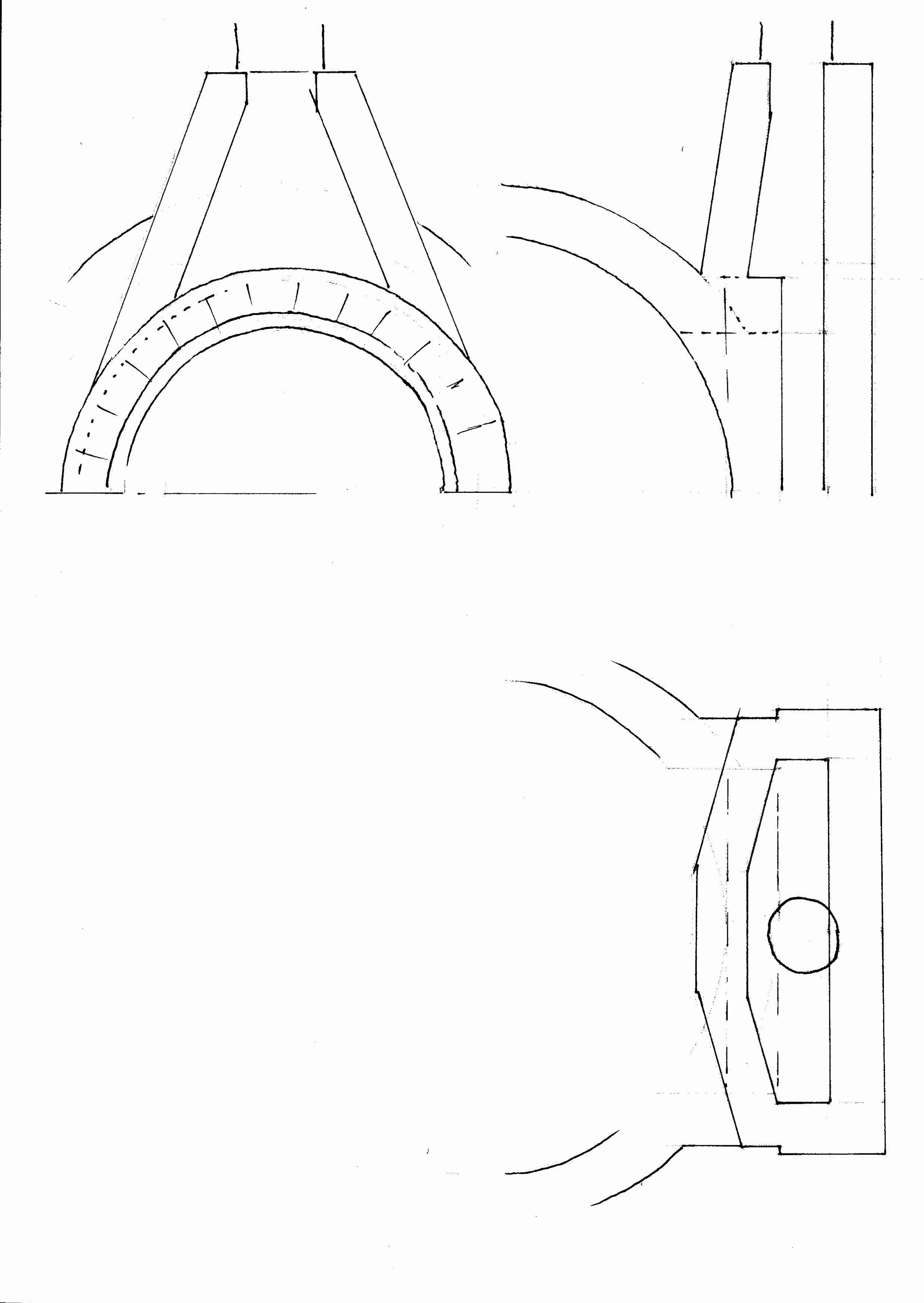

        Jas0ny, I would have answered sooner, but I didn't totally understand your question. I also wanted to keep my landing a brick and a half deep, and learned from the forum (thanks to Gulf and others) to move the chimney back over the top of the inner vent arch. Some build right on top of the inner arch, others (like what I copied) build an inner vent arch with a heat break and then build back over that arch. I'm posting one of my cad drawings that shows what I did. I had roughly a 7 inch opening in my vent arch, then opened it up mostly to the rear to give me an 8" depth. You can see it is very similar to what DavidS is showing above but done with bricks. Let us know if this helps.
