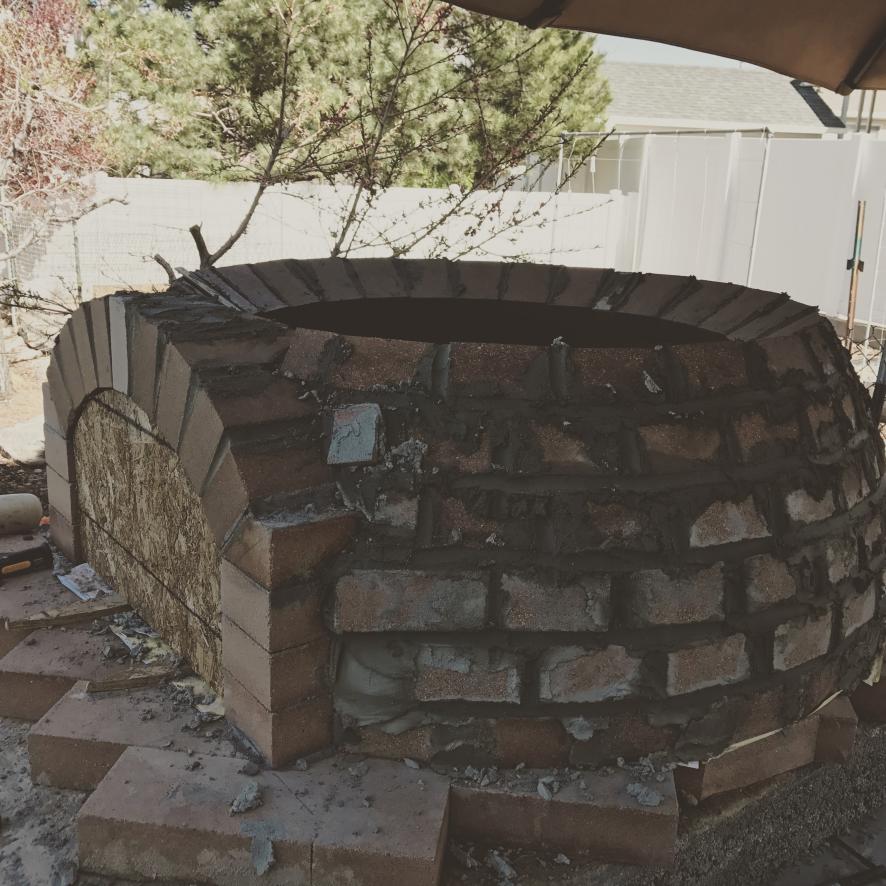

    replied
    It gets a little tougher as you go up and the bevel and angles increase. Just cut 4 or 5 pieces to verify you can make your radius without too big of gaps or overhangs and stay with it. Seems like you are moving very fast, so should have the dome enclosed in no time.

  • Roland Deschain
    replied
    Any advice on the next courses?
    Ive been using half brick up to this point. Ive cut each brick on one side to eliminate and inverted v.
    Leave a comment:

  • Roland Deschain
    replied
    Hard day today figuring out arch to dome transition. I took a lot of creative licensing. Click image for larger version
