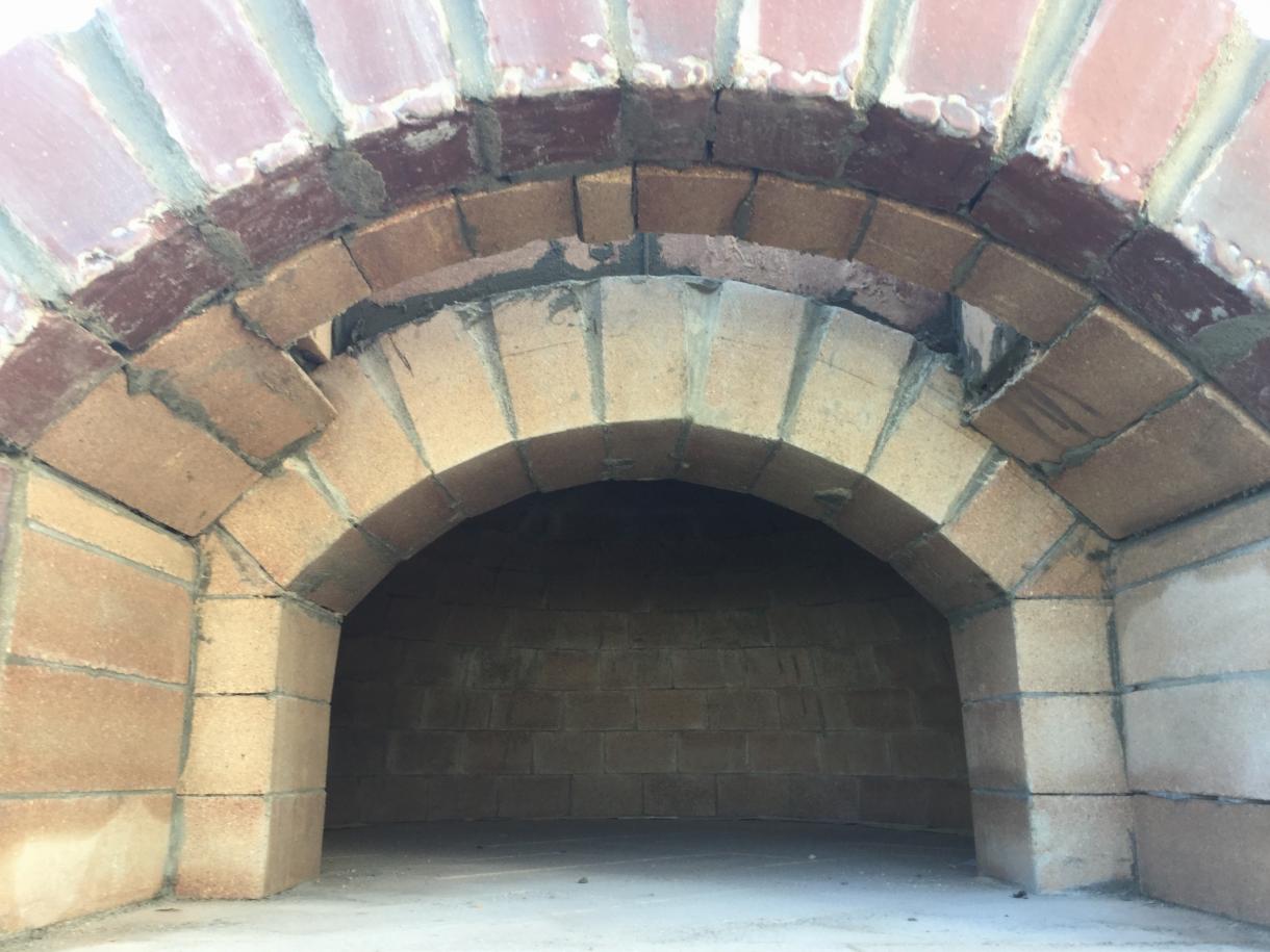

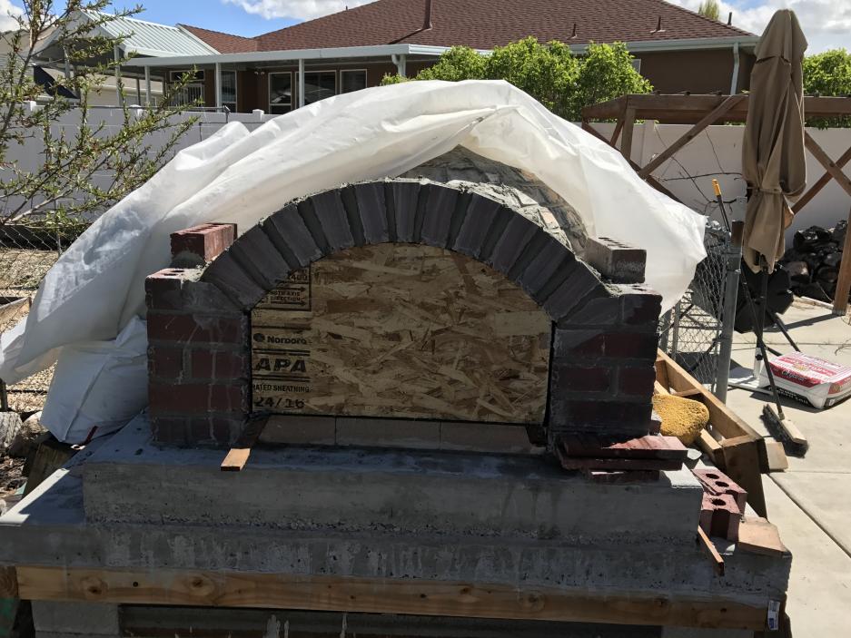

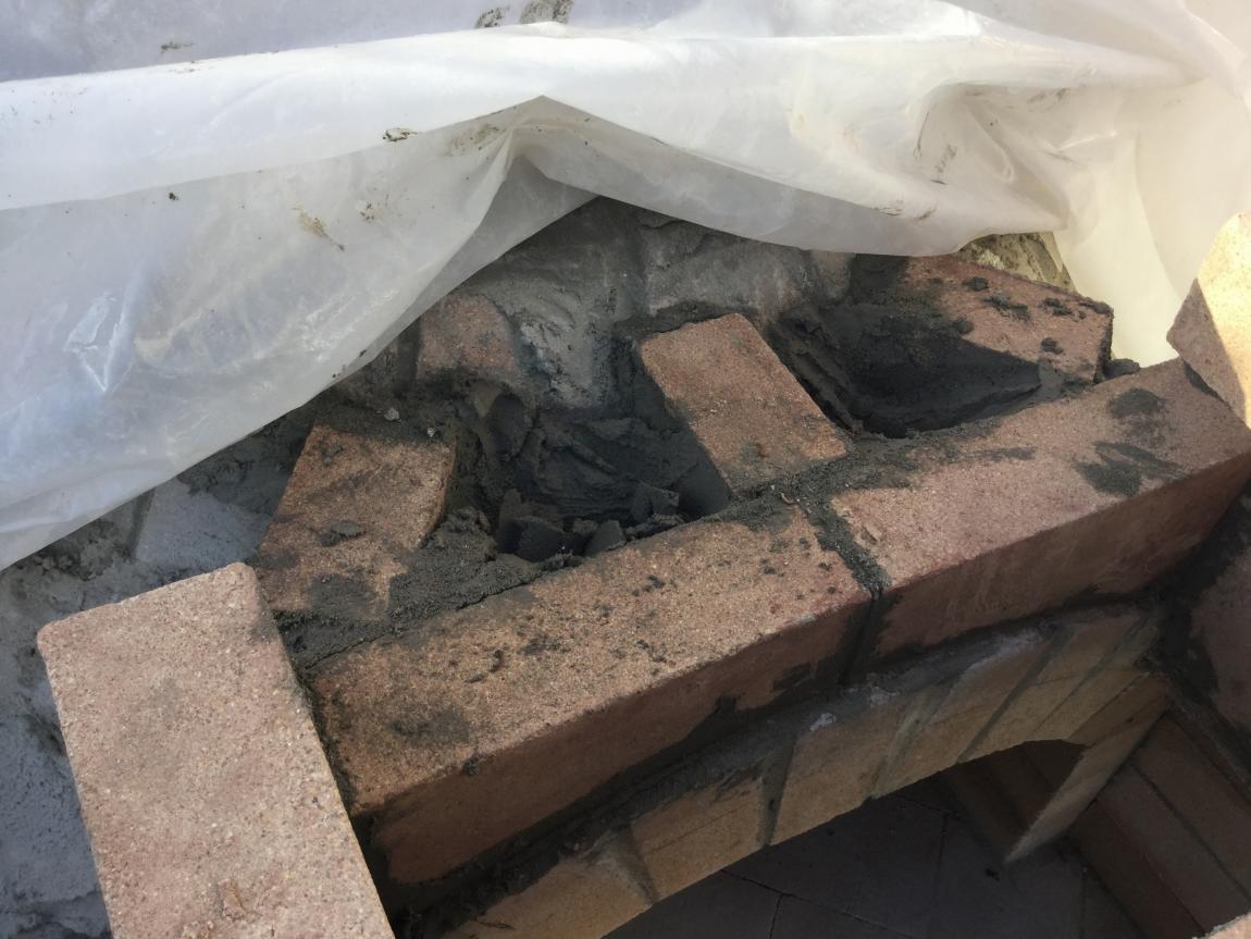

    The last of my brick work. And flue adaptor work.

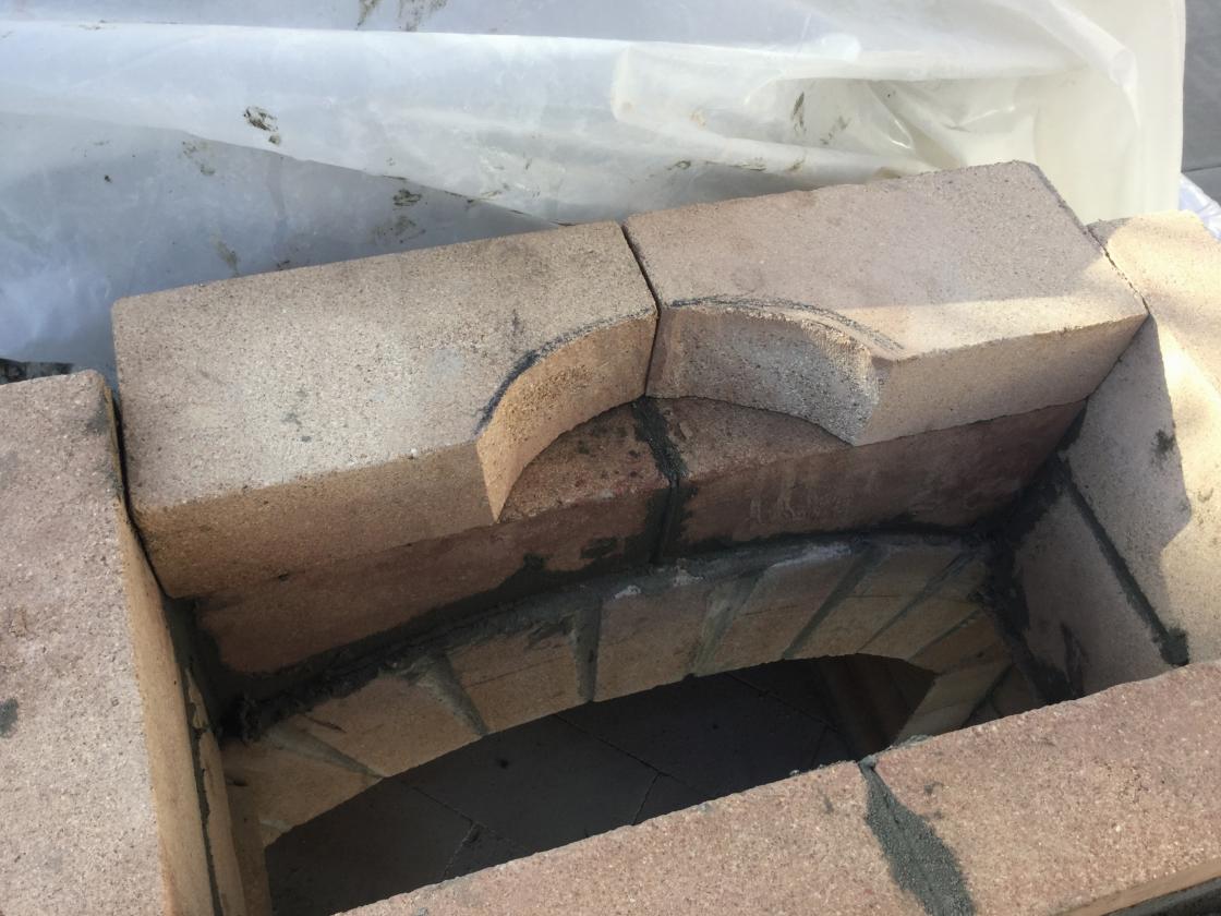

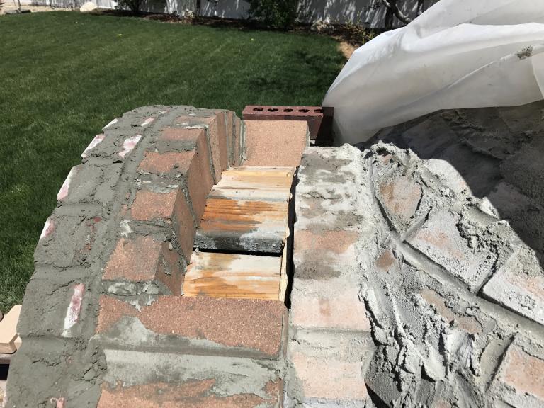

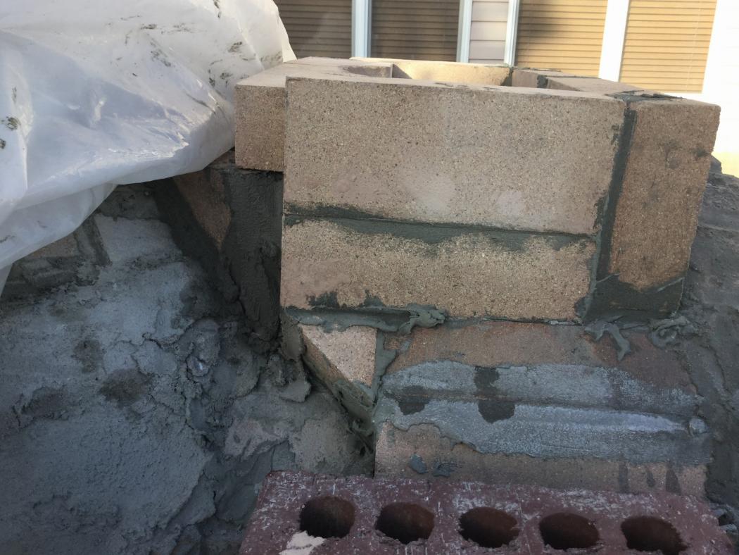

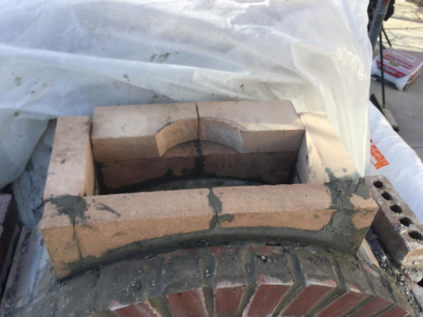

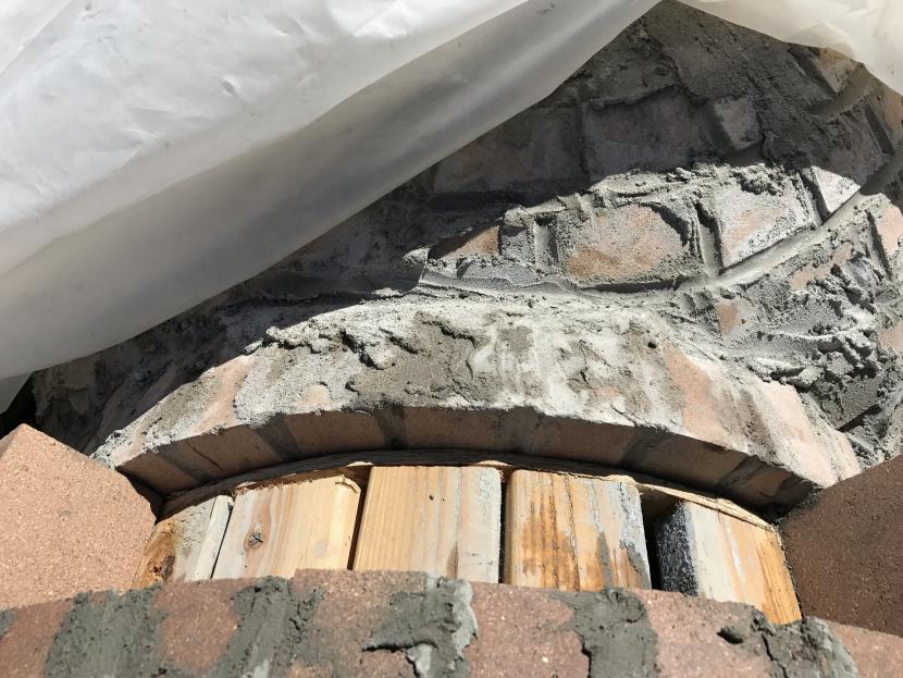

    More pictures of the front arch and flue smoke chamber up to this point. I still need to clean up a bit etc. Its still a work in progress. Click image for larger version

    I worked a couple hours doing the finished brick arch and some firebrick arch behind it. Ill figure out the rest tomorrow.

    I like to call it the serpentine (s curve) vent. I copied it because I liked the look and was able to "wrap my brain" around how to build it, unlike some of the other configurations that didn't click with me. I think that design really lends itself well to hemispherical arches, but I'd have to think about how to make it work with the flatter arch type you are using. There are quite a few ways to go, and the forum has plenty to look at. It'll be interesting to watch your build further reveal itself

    Yeah ive been reading your thread as i build. Saw the pics of the pipe.
    Im debating on how to build my flue chamber. I was wondering if your inverted funnel is worth trying. Currently i will have a six by sixteen inch opening to start. And then who knows how it will end up being built to the adapter plate. I wont know until i start building in the morning.
