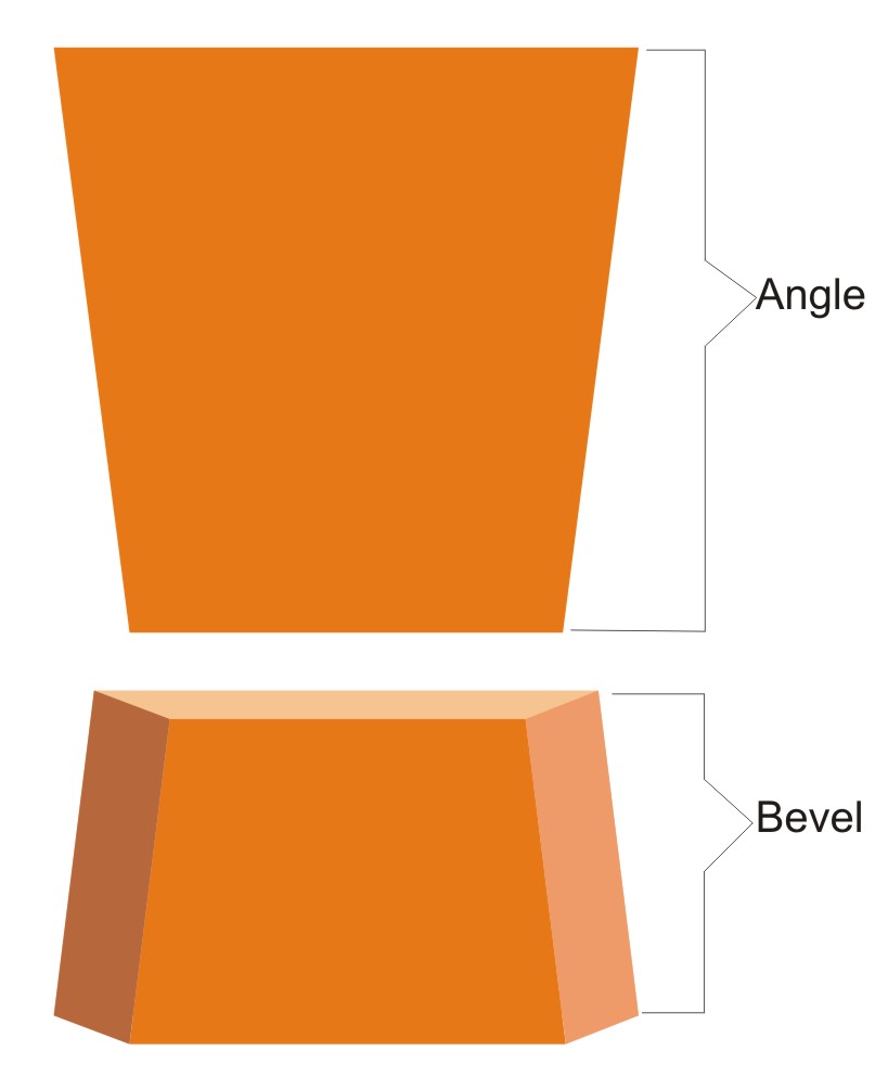

        Thanks - is there a big disadvantage (structurally, cooking, heat retention, etc..) to these big joints? I guess the way to reduce them is to taper or bevel the bricks?
          #34
          There is no disadvantage, you could reduce the side mortar joints by a taper or angle cut, which I did on my build, IMHO, it is not worth the effort, save your time resources for other activities. However, you will need to start doing a bevel cut fairly soon in order to minimize the Inverted V joint. You do not have to bevel the whole side just enough so the Inverted V does not take place. Use a rubber mallet to help set the bricks in place, you still should strive for tight joints on the inside of the oven.
