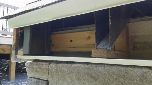

      Pictures after the first two layers of insulation were applied to the dome. I added three more on top of this, extending down to the concrete slab for the rest. I ran some metal hanger strap over the dome to hold everything in place, though it doesn't seem inclined to move. Construction of the "little house" out of steel studs is underway. What a pain (literally and figuratively) they are to work with. Despite gloves I have multiple cuts, and the methods I've come up with for attaching rafters to the walls seem pretty hokey. I have no good ideas for how you attach a facia board to the ends of the steel rafters.

        I removed my facia board and took a photo of how I did it. Its not pretty but it works
