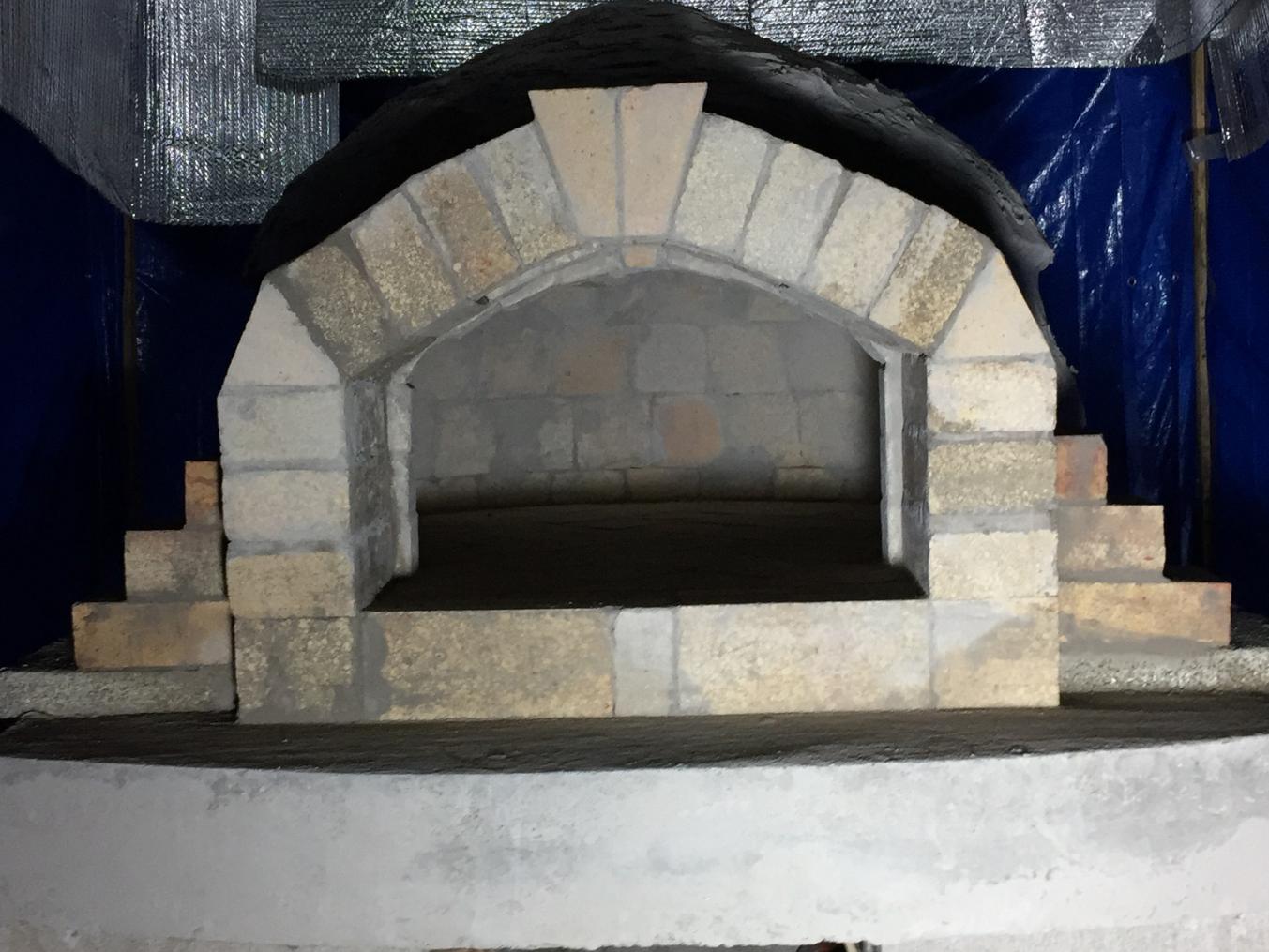

    The weather has turned cold so I had to take a weekend off and build a shelter around the oven. That done, I have resumed building the oven. Managed to get the first course above the arch complete. All good so far.

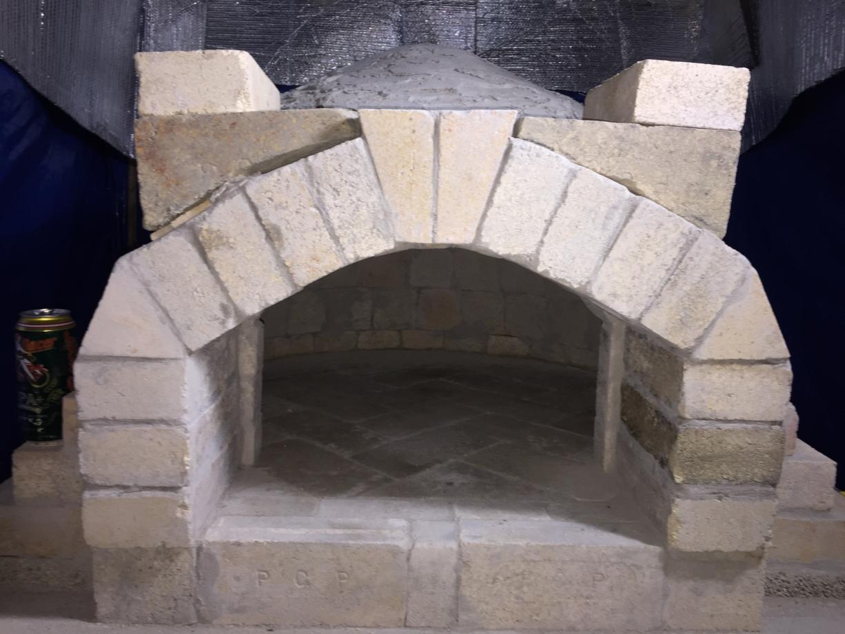

ID:	409567 Although winter has arrived, I am still moving forward with finishing the dome of my 36” Pompei oven. I can see the finish line. Once I get the dome completed would it be harmful doing the curing fires in subzero temperatures or should I wait for spring? I used Heat Stop 50 as a mortar. Thanks in advance.

        Dome and entrance done, chimney next.
        Looking forward to getting some curing fires going and seeing how it holds up given the modified dome design (aka: Dunrobin Dome).

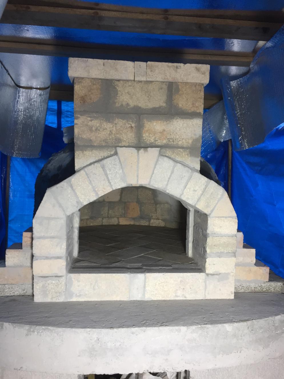

              I am starting to build the chimney for my 36” inch Wfo.
              The flue opening is 15” inches X 5” inches but it will narrow as I taper into the SS 6” inch ID chimney anchor plate.
              I am using a Selkirk 6” inch” ID chimney with 2” inch “(each side - 10”” inch OD) of insulation but I am struggling to make that fit over the flue / entrance which has a depth from front arch to dome of ~ 12” inches. The brick chimney I had planned would have been 16” inches square. I will have to redesign and see how it looks. The brick chimney was to be 16”” inch tall and the Selkirk chimney needs to be 8’ feet tall to meet local code. If someone has put on a similar chimney with such a small entrance please send me a link to your build for more ideas. Thanks in advance all.

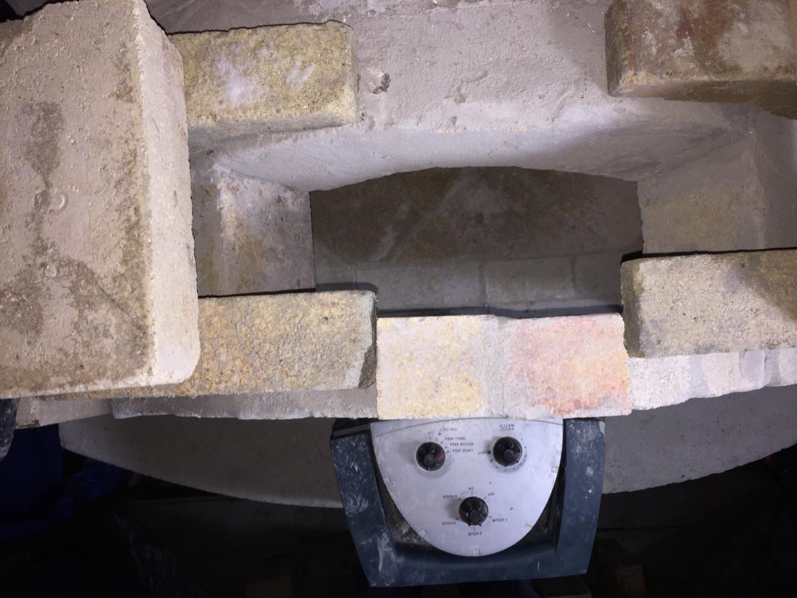

                    #24
                    Glad JR's thread helped. In looking at your dry stack, I'm a little concerned about the arch pressing down and out with the extra weight. I put some brick buttressing (with pieces of rebar mortared in the aligned holes of the common bricks) on the outside of my arch(es) to counteract that outward pressure. I've attached your photo with the red force lines and position of suggested buttressing. The top brick(s) with the dot would be optional.

                      #25
                      Yeah, it does look top heavy.
                      I have some buttressing in place ( see attached) that I had thought should hold it but after dry stacking it looks SO heavy. I could remove one layer of chimney brick and still meet code with the stainless chimney sections that I had planned to use. Adding more bracing would be easy at this point. Thanks for your help. I find it challenging to get my little shelter warm enough to curing the mortar.

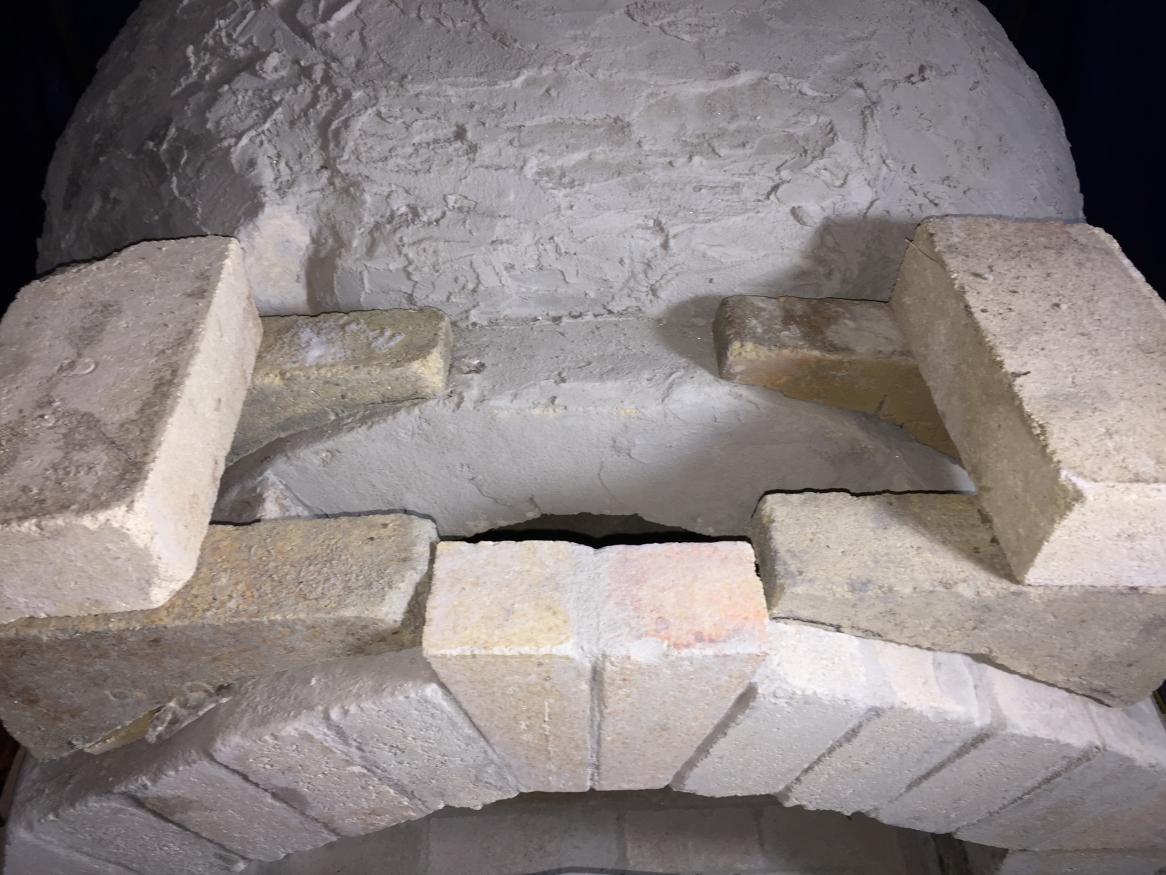

                          #27
                          Waiting for the temperature to climb back up above 32 degrees (currently near zero). In the mean time I tried dry fitting the chimney with one layer of bricks removed. I think it looks more balanced now.

                            #28
                            Yes, looks like it fits much better!

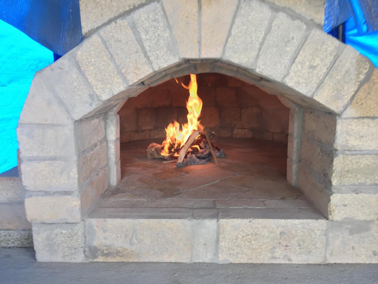

ID:	413301 Well, finally got back to the oven. I mortared the chimney, made a door and started my first mini fire. The door is a poured three ply 3” door. The inner ply is ~3/4 of Heat stop, the middle is ~ 1.75” vermicrete (5:1) and the out 1/2 in is regular cement. I’ll get a work out using this, the whole thing weighs ~ 25lbs!

                                #30
                                First fire. Click image for larger version
