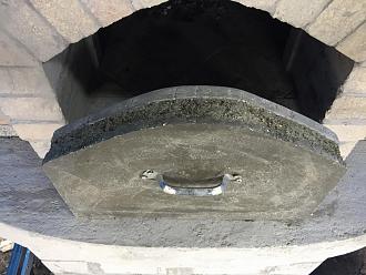

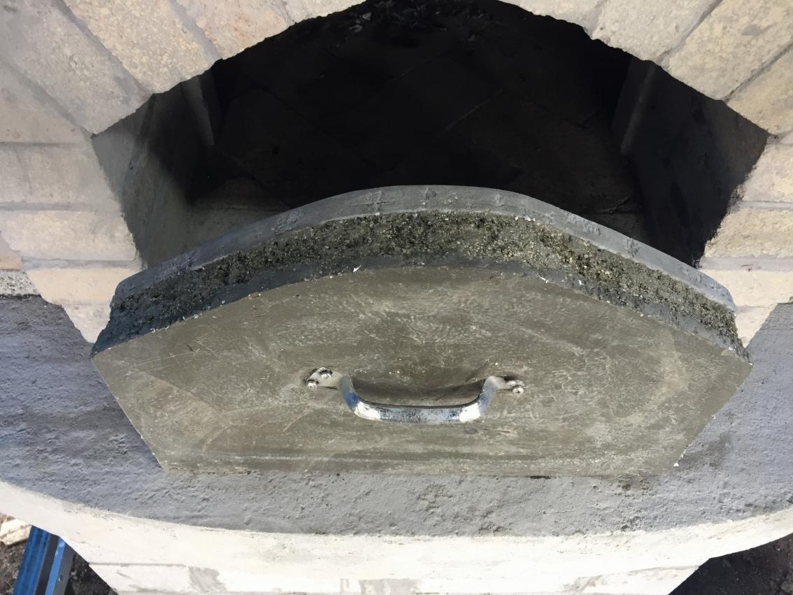

    My door - 25lbs!Click image for larger version
