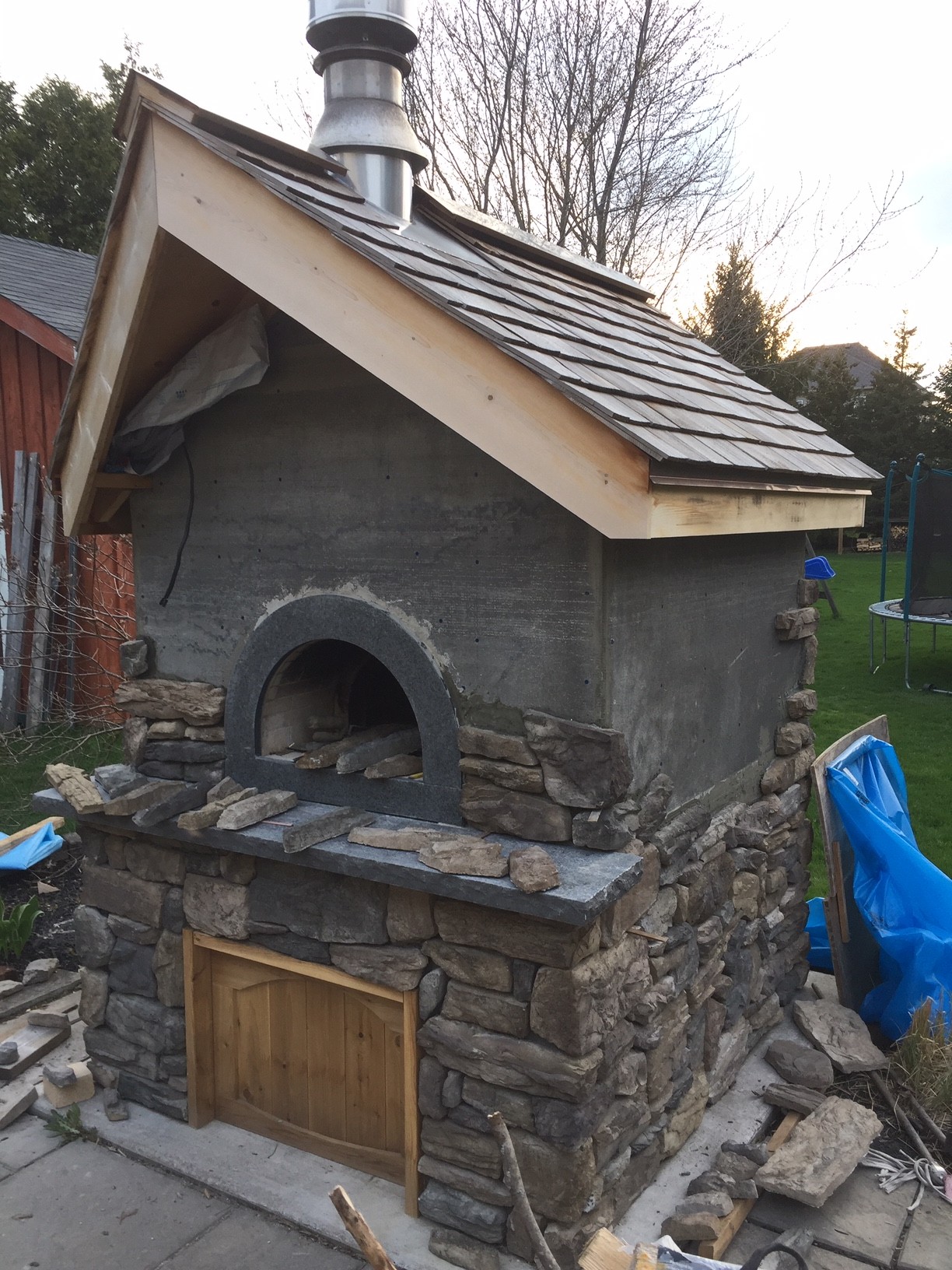

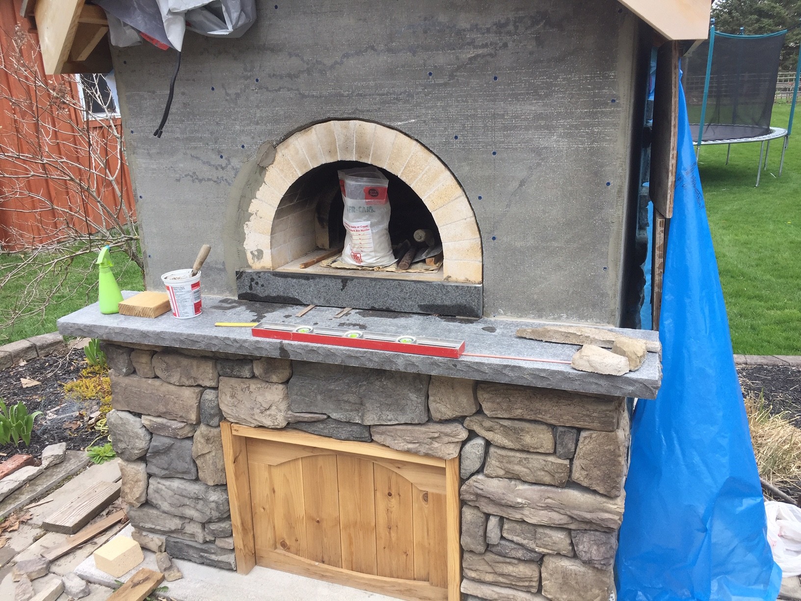

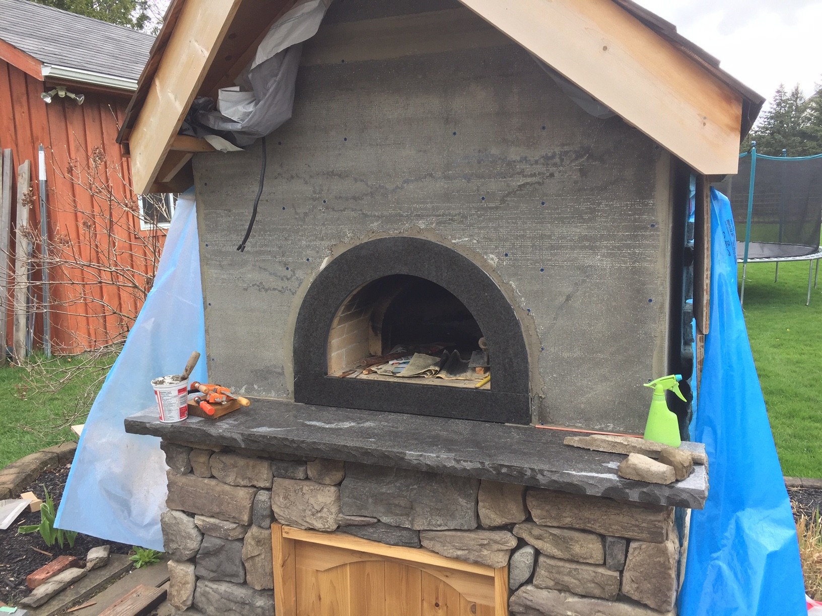

      Weather has finally improved up here so I’m back on to finishing the exterior. Picked up a coping stone to use as a ledge. It needed a little trimming but fits like a dream now.

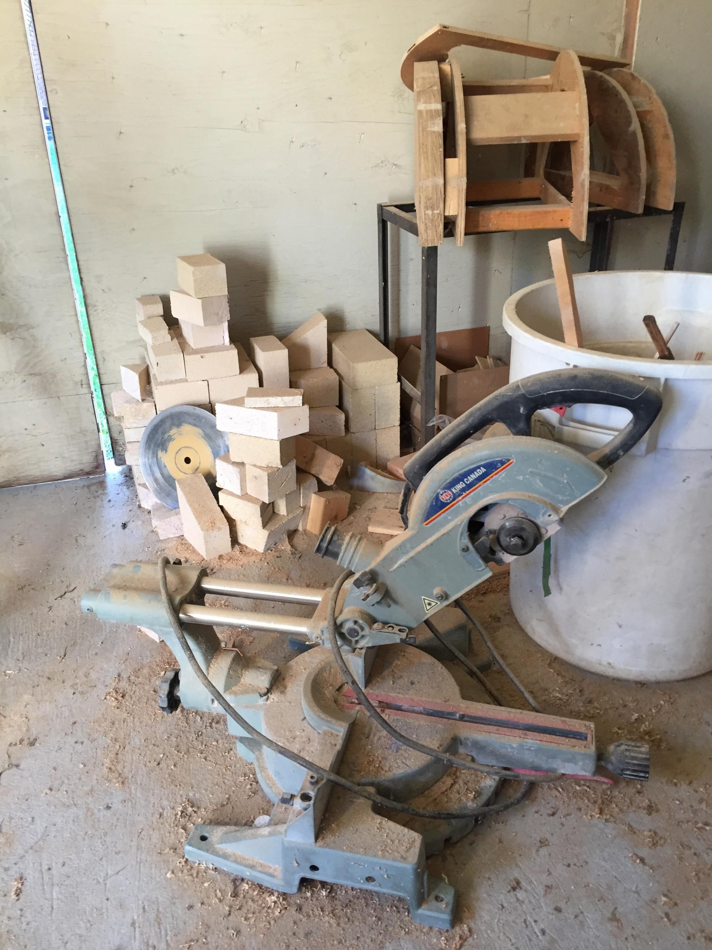

                      Finally - can you show me a pic of your saw? I have a 10" Dewalt non-sliding compound saw and a 14" chop saw - not sure which to use/which would be best with diamond blade. Any advice here MOST welcome from your experience.

                        I got the foam glass from C&I Crossroads. They have locations throughout Canada. Closest to me was in Kitchener. As for my bricks I ended up calculating each level of the dome and used a compound slide mitre saw to cut all the compound angles. It was a lot of work and probably a little overkill but Now that it’s done I’m forgetting how frustratingly challenging it was.

                          looks like that saw took a beating!

                            Actually the saw held up really good ( it’s just covered in sawdust). I purchased it used for $40 and it was already in rough condition but perfect for a job like this. I tried making my own compound angle jig but it was not rigid enough to give repeatable results. This saw saved me so much headache because I could trust the angles and making minor adjustments was a snap.

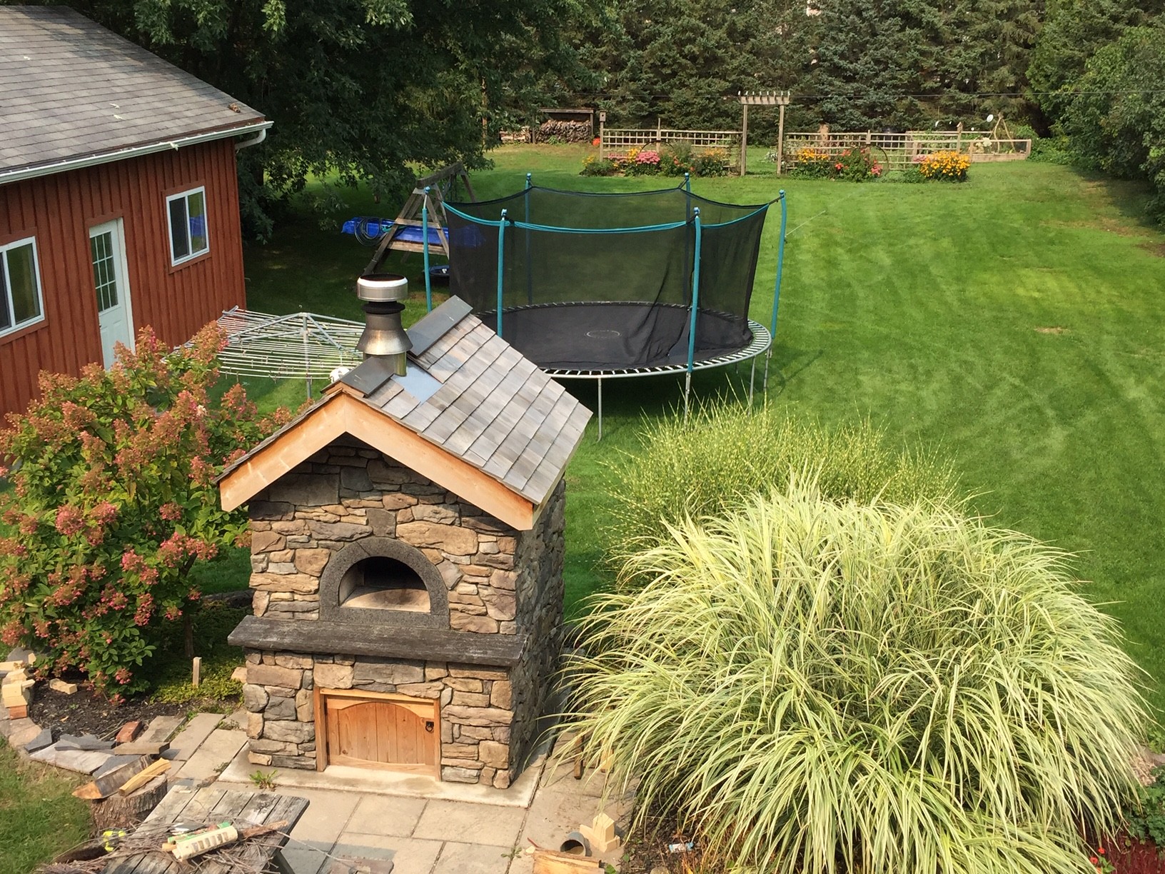

                              Finished one of the last tasks on this project! Finally! It has been quite the journey and I wouldn’t have been able to do it without all the great advice and experience I was able to gleen from this group. Thank you all so much!
                              I am still hoping to make an insulated door over the winter so we can expand the types of food we can cook but for now I am just happy it is done - and so is my wife
                              cheers to all and may your cheese never run out
