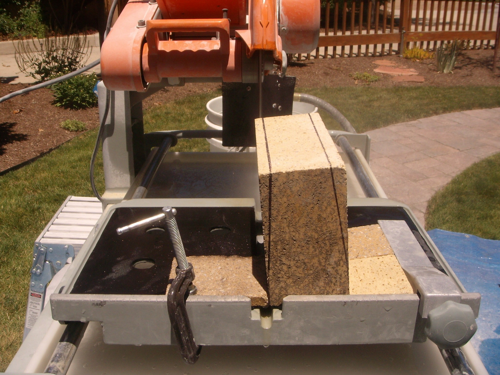

                          Got it... gracias!!! In looking at the 1st picture in your last post... the face of the arch where the door will contact... those look to be tapered too (template)... is that necessary for the build to be strong or for aesthetic purpose. I understand that the inside is tapered to make the intersection cleaner and easier.
                          My Oven Build
                          https://community.fornobravo.com/for...mx?view=thread
                            • 5264
                            #73
                            I did taper the arch bricks so I would have uniform thickness mortar joints also my bricks were 5.5" wide vs 4.5" std bricks. That said, you do not need to taper the arch bricks but you will end up with a fairly wide mortar joint on the OD if you do not. There is a program link on the forum somewhere called the Angleizer that will calc the brick size, number based on arch size and joint width. You will have do a search to find it.
                            • modified9v
                              • 191
                              #74
                              I’d really like to taper them too... I have the angle figured out just struggling with the jig. 10” blade is an issue... pretty sure I’ve seen some killer jigs out there on the forum. Looks as though if I can get them cut I’ll have a solid arch that works out well mathematically. I think I also saw that some have used wedges of brick to fill the monster void as well. So little of that mortar wedge would be visible, but I’d much rather have brick than mortar in this critical location.
                              Thanks again for the help today... Mike V.
                              My Oven Build
                                • 5264
                                #75
                                I used a 10" HF saw and a simple jig. You need to cut from both sides and use a angle grinder with a diamond cup to smooth out or feather on the wet saw using the side of the blade. Click image for larger version  Name:	34 Inner Arch 6.18.12.JPG Views:	0 Size:	647.4 KB ID:	416857
                                bricks cut offs under the brick for the right angle and a flat piece of brick on the left to hold brick from moving laterally.
