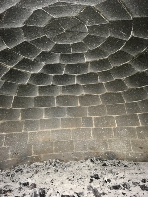

    Ok I will cut the parts around it as what you see it’s just a 3mm coat of refractory mortar that I’ve put around the dome. Which in fact today I had to remove it cause I started curing the oven and I noticed various cracks around the dome so I wanted to see well what was going on.
    I noticed even some smoke coming out from some cracks. Is that normal to happen or did I do something very wrong ? What do you suggest I do now put some refractory mortar to fill in the cracks ? I was planning on keeping the WFO burning the whole day today slowly and tomorrow fill in the cracks and put the insulation on. Is that ok or do I need to wait more in these passages ?

    • #32
      I installed my blanket insulation, a vermicrete layer, and the stucco before starting the heat drying process. I still have cracks. But, there was no turning back for me. Imo, the only ovens that don't have cracks are those that haven't been fired. You don't show a pic from the inside but, I bet it doesn't look that bad. Remember, the dome can't fall in on itself. I have been firing my oven for 7 years. My advice is to insulate, take your time on the further drying fires, and enjoy your oven .

        The inside of the dome seems fine, today I will proceed with insulation ... thanks for the encouragement..
