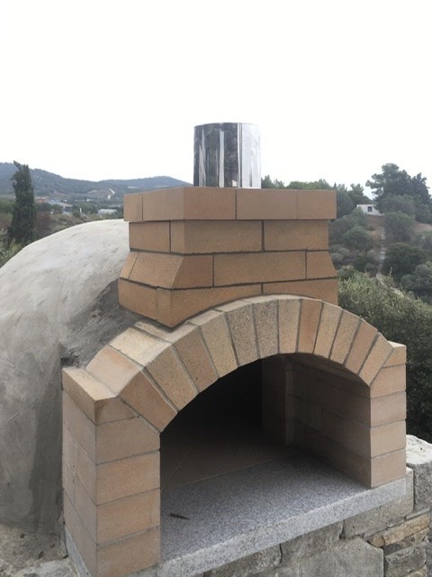

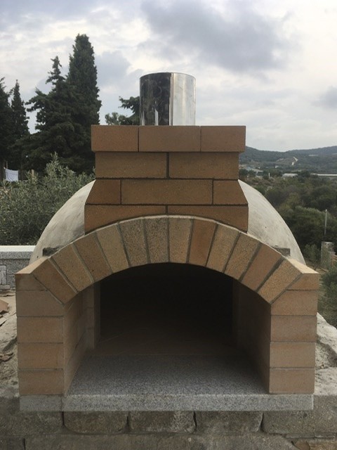

    Coming to my dilemma, do you think I might need buttressing for my wood oven ? The dome is 36” and I am planing on building a 3 feet round brick chimney with a 6” ss pipe inside using firebricks cut in half ( lengthwise ).
    i would like to avoid it if possible mainly for aesthetics.. but I do understand there will be quite some extra weight on the two arches.
    Looking forward to hearing your opinions..

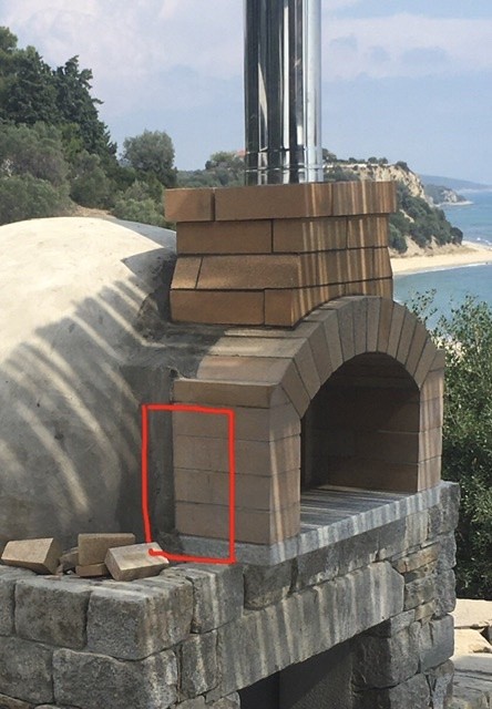

          I am thinking that adding one brick thickness would be sufficient buttressing, but you may need to pour a little bit of support under the landing and where the new outer walls will rest as it looks like your landing is hanging off the edge of your hearth. I am not sure how far forward your chimney will be, but I think you will want some more reinforcement under the landing if the front wall of your chimney will be flush with the front of your arch.

              If you were just install a 6" ss chimney, I would say you were okay not buttressing the side walls of the arch. That said, masonry chimney weight add us quickly and the configuration of the outer arch will see substantial sideward loading where the arch and vertical walls meet. You can accomplish buttressing by adding another vertical course butting up against the existing arch.

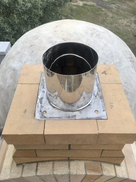

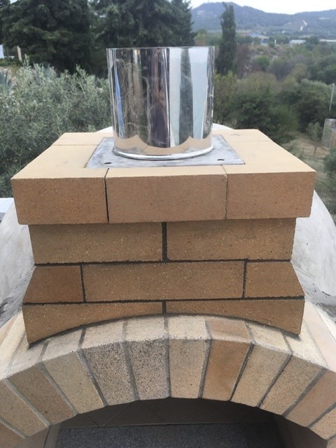

                Ok so do you think i can use the same firebricks to build these two extra walls in the sides ?( as I have some already ). And is it ok to build the line of bricks from half way backwards only ?( see photo ), because the rest of the structure is protruding in the front by half brick almost.

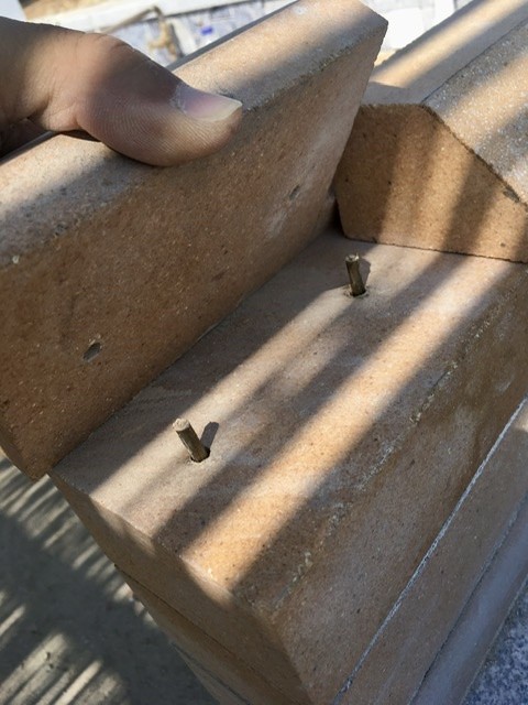

                When I placed the last layer of bricks that support the arch I had this idea of putting some brass small rods inside for extra strength ( I hope that won’t be a problem with the difference in thermal expansion. Now I have the flue gallery and chimney base ready ( very similar design to the one of UtahBeehiver, thanks by the way for the great and detailed photos you shared of your amazing work ). I am going to wait before I start building the chimney around ss pipe until I figure out the buttressing. Finally is it ok to use the half firebricks build vertically or shall I look around for normal bricks? As David s points out the porosity is not such a big problem, maybe just the fact that they weigh more than normal clay bricks that’s all I can think of.

                  I managed as you see from the photo above to make the base of the chimney so that is not completely flush with my front arch cause I wanted to be able to see part of the arch from the side.. regarding supporting it underneath I might figure out something but maybe it’s not entirely necessary as most of the weight is landing inside the hearth.
                    • 5264
                    In your original post, you said you were doing a 3 foot brick chimney. Based on the latest picture, the chimney is substantially shorter and topped with a SS chimney. I do not think you need to buttress now unless you feel you need too. The chimney load is substantially less than original envisioned.
                      UtahBeehiver He is still planning to build masonry around the SS pipe. I think he will probably still want to buttress, but do you think his buttress walls need to extend all the way out to the front of his arch, or could he get away with stopping at the edge of his hearth? Look at the large picture in post #8 where he has outlined in red.

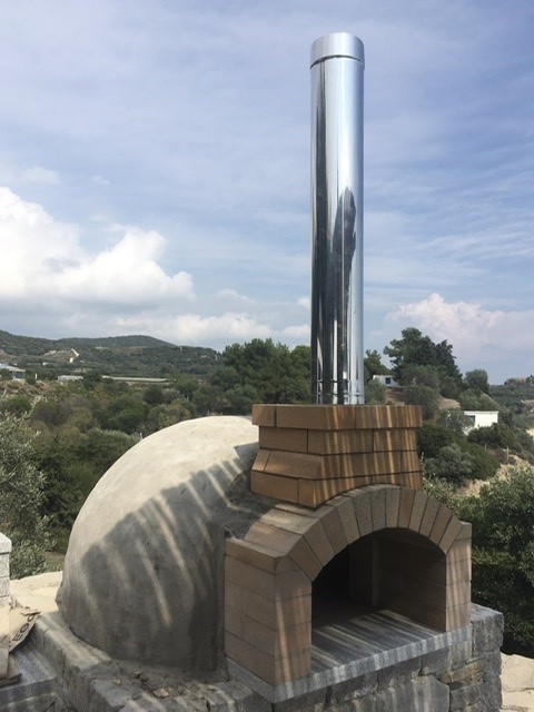

                        I am planning to build around the ss pipe ( full length photo below ). While researching on the net I noticed that there isn’t a single WFO with a round brick chimney out there, so I was wondering is there a reason for it( complications on building it ) or just a matter of aesthetics?
                          • 5264
                          There are a couple spiral shaped chimneys that use standard rectangular bricks in the forum threads. I do not know the links but it is an advance brick construction technique.
