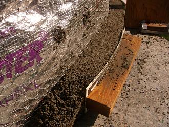

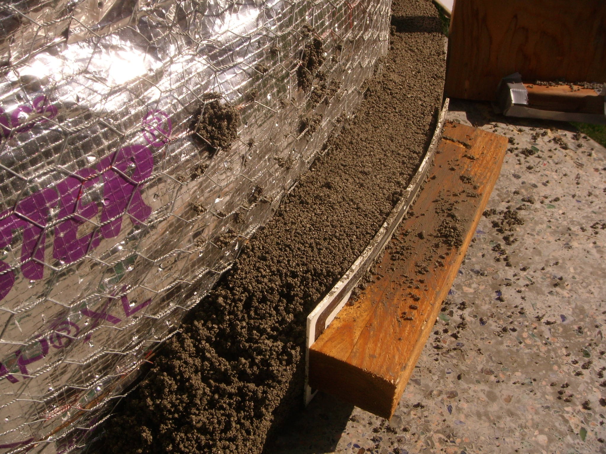

                Neat and tidy. To help place the pcrete on my done and made an adhoc curved trowel and held the pcrete in place until it self supported then moved on. Click image for larger version

                  #23
                  Cool idea, and with a spherical dome it works vertically too :-)
