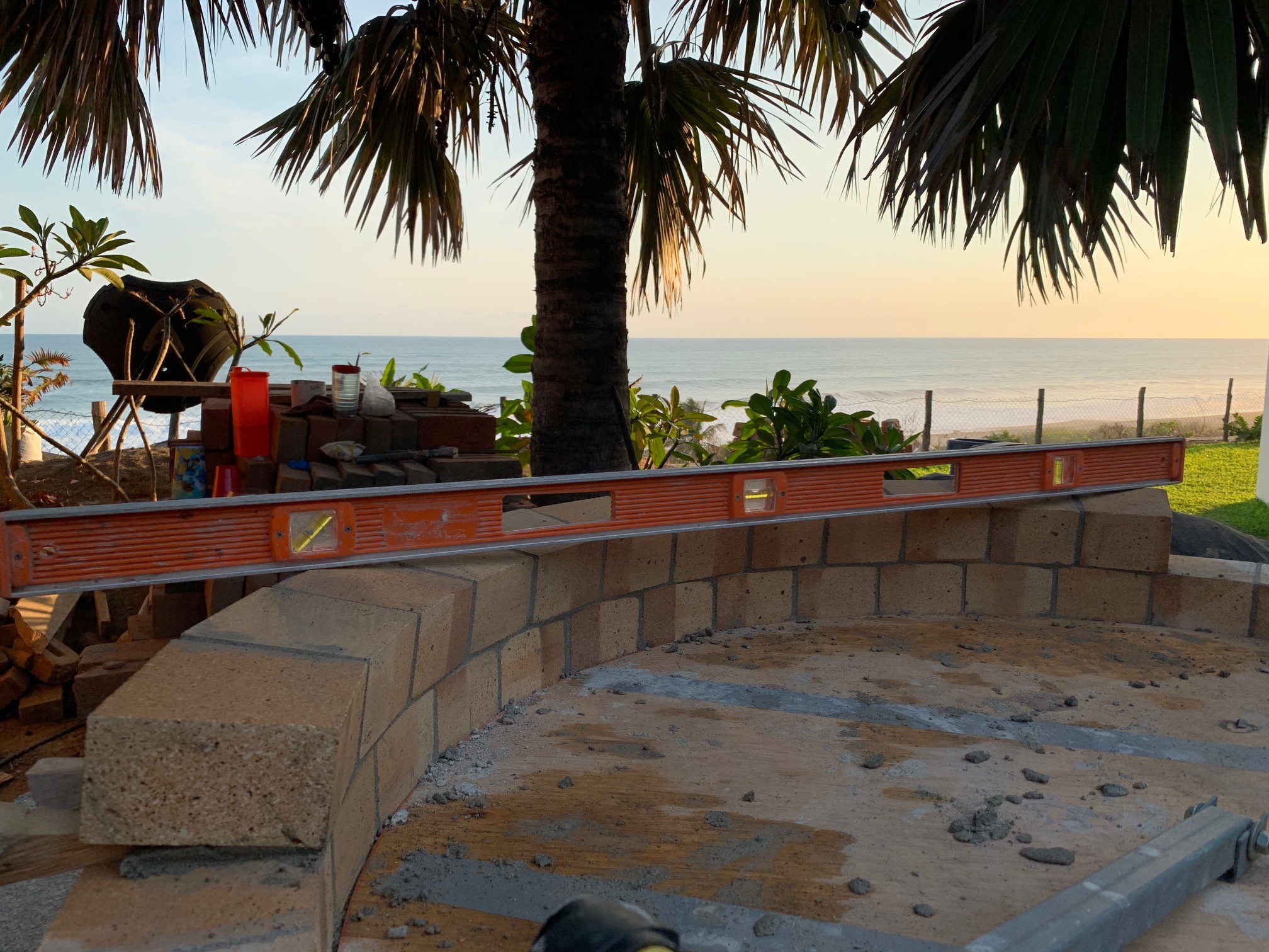

      Most of the construction in Mexico is done with solid red brick however I did find a place the had blocks. The only problem is that the blocks are 16" x 6" x 8" so we had a lot of cutting to do the make them fit correctly.
        Here you can see the hearth block stand complete and laying the block for the rest of the outdoor kitchen.

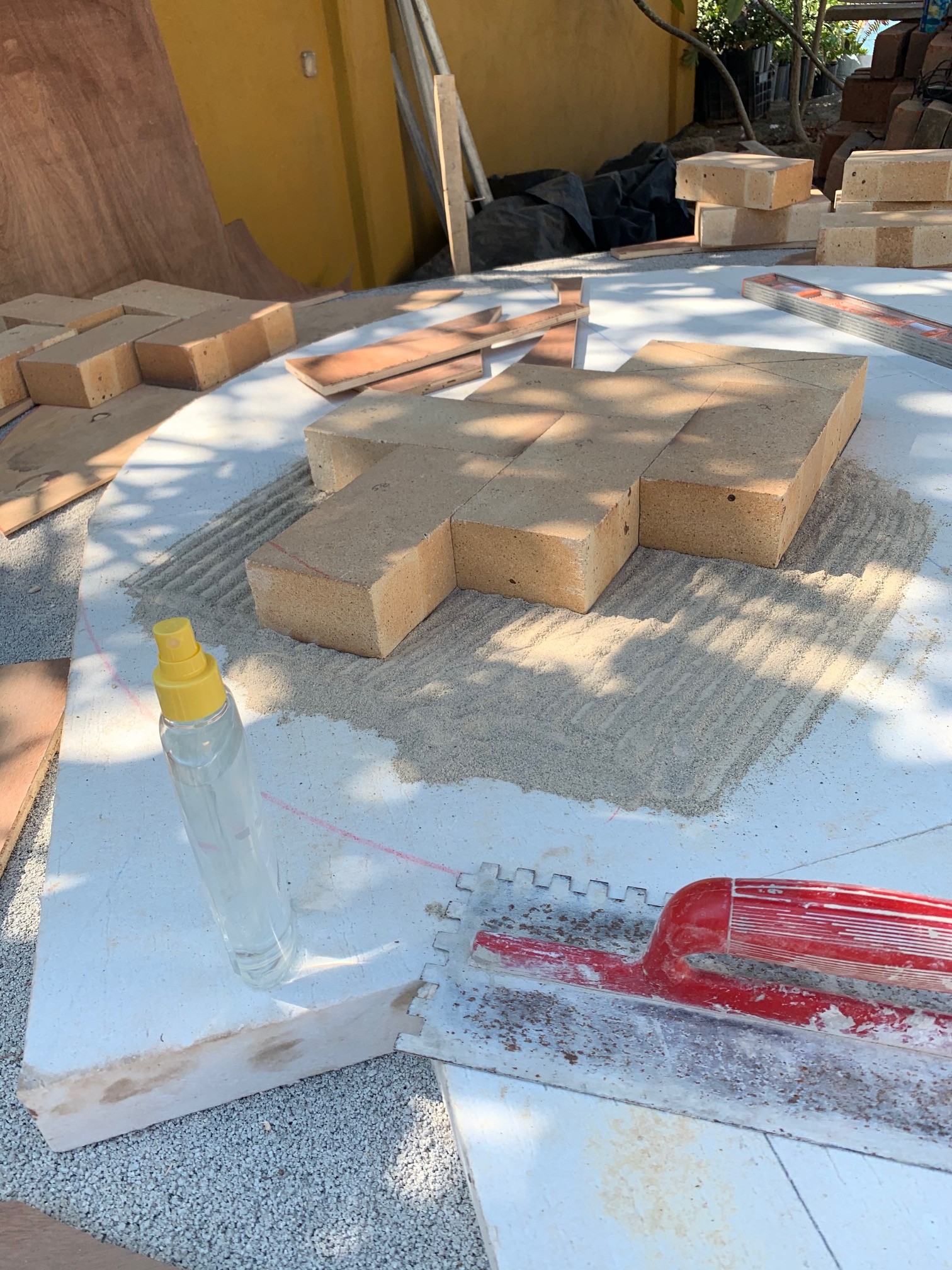

              So today is day 21 since the pour so we decided to start cutting the floor brick. Its amazing how much Im finding out that I dont know. As we move forward things are becoming clearer but man I feel like im winging it at times. I was nice to finally get the saw set up and start cutting fire bricks.
              • #8
                Since you are enclosing oven anyway dome on fire brick floor is actually easier. You can rough cut floor bricks, leave proud because won't be seen once enclosed

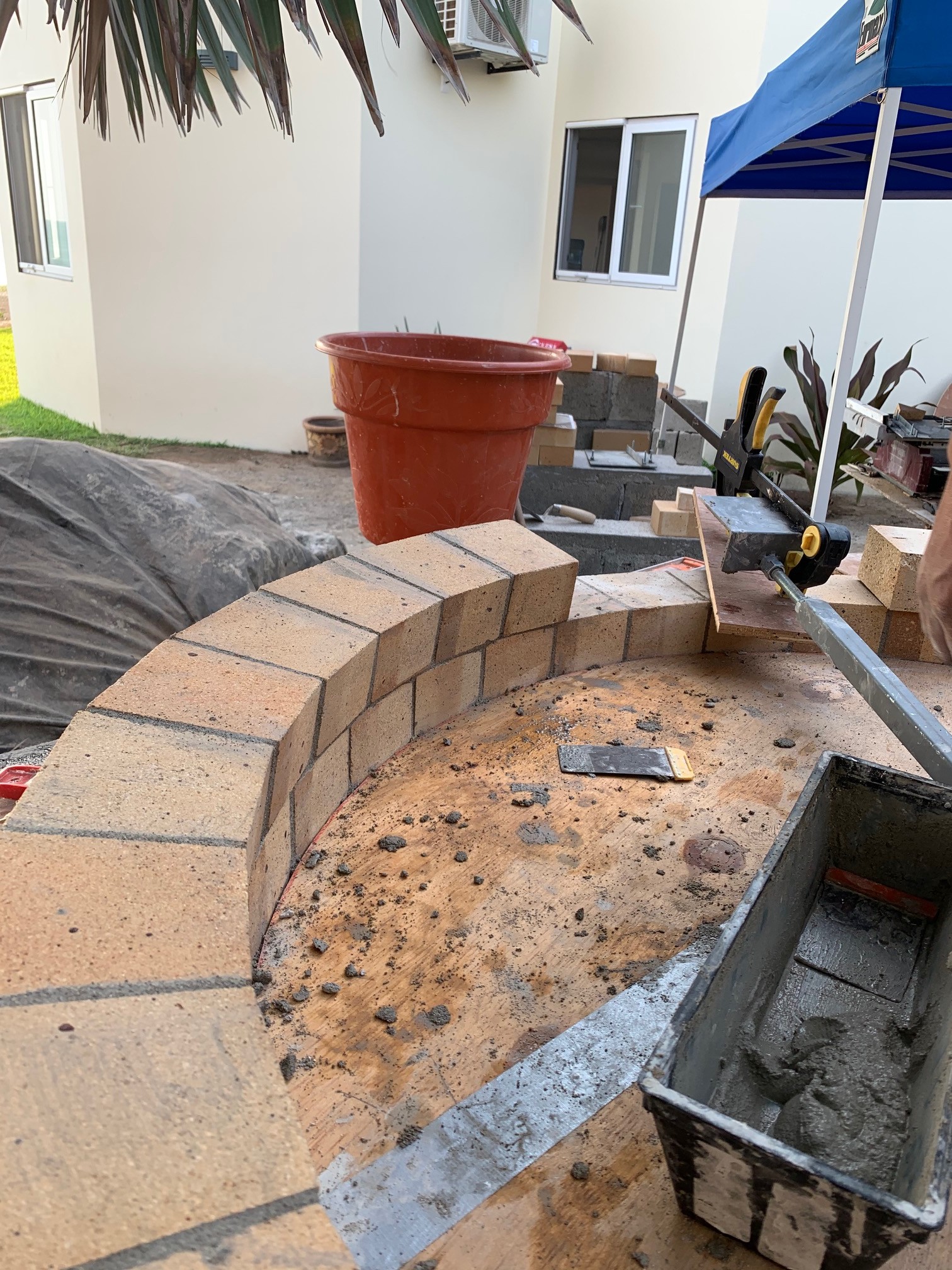

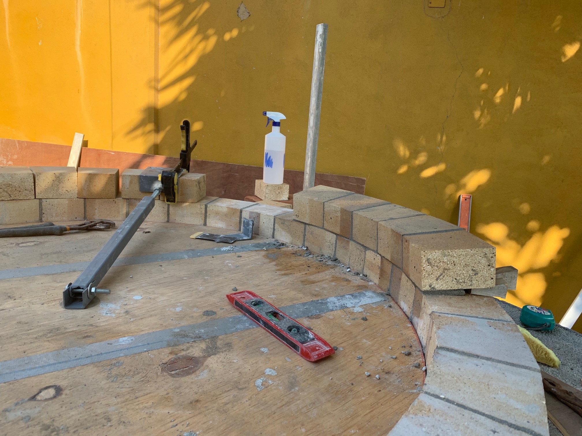

                        I ran into a few issues that slowed down the progress over the last two weeks but now that those issues are resolved we are starting to move forward again. The first issue was that a part of the ceramic fiber board Im using got wet. It took a few days to dry out before I could set the floor. The second issue was the brick cutting jigs I had made were not square and had other flaws so I had to have new ones made. The new ones work well so Im back to cutting brick. Today we started the second course which was much harder then I had expected however after learning from a few mistakes it seems to be getting easier. Im not sure if its because of the hot tropical enviorment here but the home brew mortar is drying out so quickly that its hard to make adjustment necesarry to keep things level and inline. Each brick is soaked in water until no bubbles appear and the previously set brick is sprayed with water until the mortar is applied. Even doing this the bricks still soak the water out of the mortar within seconds. Is this normal?
                        • #13
                          Here are some photos of the progress to date
                          • #14
                            Great photos and start with the build. About your homebrew drying fast - I dunno your local climate but it looks warm and sunny. What I found, and others too I think, is to keep the mix on the wet side. I.e. actually soupy and sliding off the trowel when you check it, then even with wet bricks and sprayed area, if in the sunshine, this will still work well to lock the bricks pretty fast but just be easier to work with and stay workable for longer.

                              Thanks for the advise Yokosuka. Temperatures here during working hours are high 80's F or about 32C. Ill keep the home brew on the wetter side today and see how that goes. One quick note on the home brew, I am using the mud, run through a fine screen, from the fire brick cuts instead of fire clay. I was finally able to source some fire clay and it should be here in about a week but I didnt want to wait to get started. Regarding the insulation, I added 4" of Vcrete on top of the hearth and then added 2" of ceramic fiber board on top of the Vcrete. The fire brick floor sits on top of the 2" fiber ceramic board. When I layed out the floor to cut it, I layed it on top of plywood to prevent damage to the Vcrete. I then remove the plywood for the final install.
