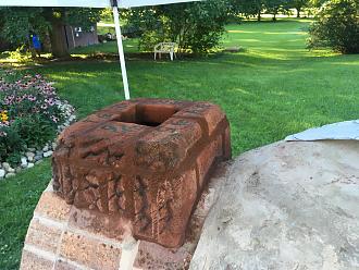

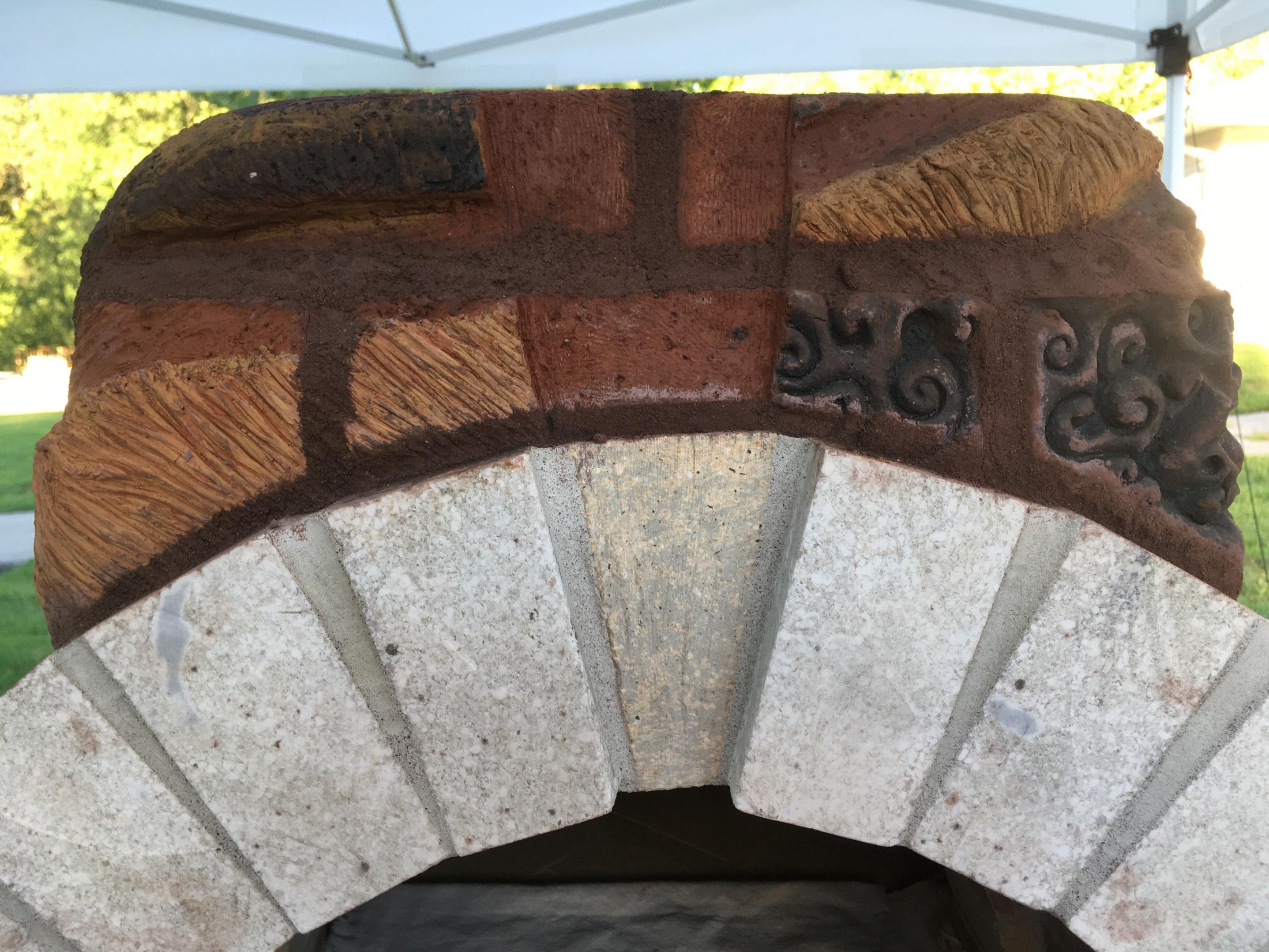

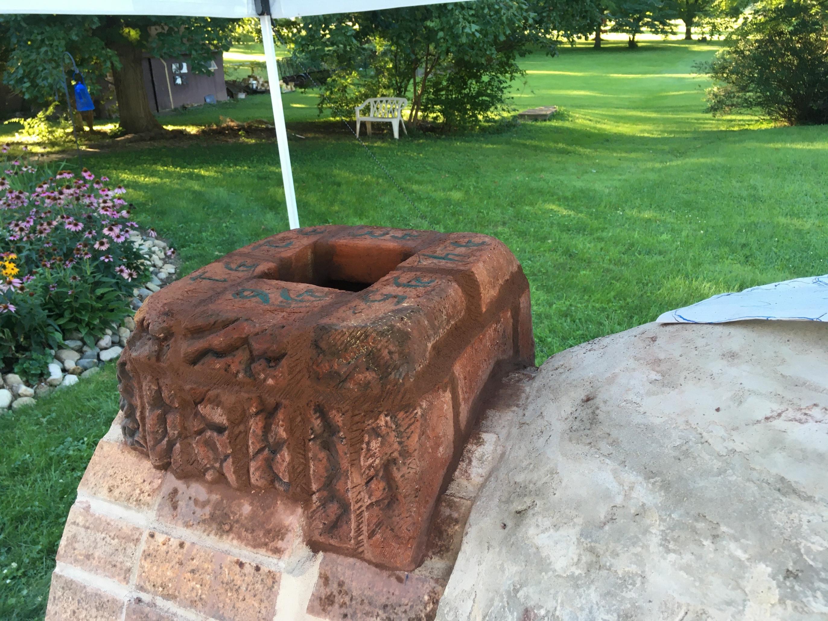

                  Moving along on the kitchen build. I poured the grill hearth at about 3.5 inches with weep holes and 1/2" rebar. Then placed fire blanket on and started with the walls of the enclosure. I also got the roof trusses made. Also, I have a 250W lamp in the oven for 3 days which peaks at 150 degrees. I will start with banhxeo76 method of slowly curing the oven with sterno cans this week. Getting pretty excited to start cooking soon!
                    #39
                    Charcoal briquettes work very well for the first few fires, heat is transitional and low (200-250 F) and you can do a dutch oven while you are at it.
                    • artistadimattoni
                      • Jul 2019
                      • 33
                      #40
                      I am at a similar place with the chimney base set up on the vent arch. I plan to reinforce it a bit under the base before installing the 8" (6" inside diameter) clay flue liner. I could use some direction in the best procedure for installing the flue liner. I plan to use two or three 12" sections. What is the best install for these? I will have bricks surrounding the first 1 1/2 feet of the liner and decorative stoneware cylinders above the bricks for a total of about 3 1/2 Click image for larger version
Name:	Chimney Base Front.JPG
ID:	426801 Click image for larger version
Name:	Chimney Base Top.JPG
                      ARTISTADIMATTONE Google Photo Album-https://photos.app.goo.gl/jdqojBBCZxazcJ3A9
                        #41
                        You probably need to insulate the clay liners since they are prone to cracking due to thermal differential. Pcrete will work or left over ceramic blanket between the liner and outer brick/clay vessel.
