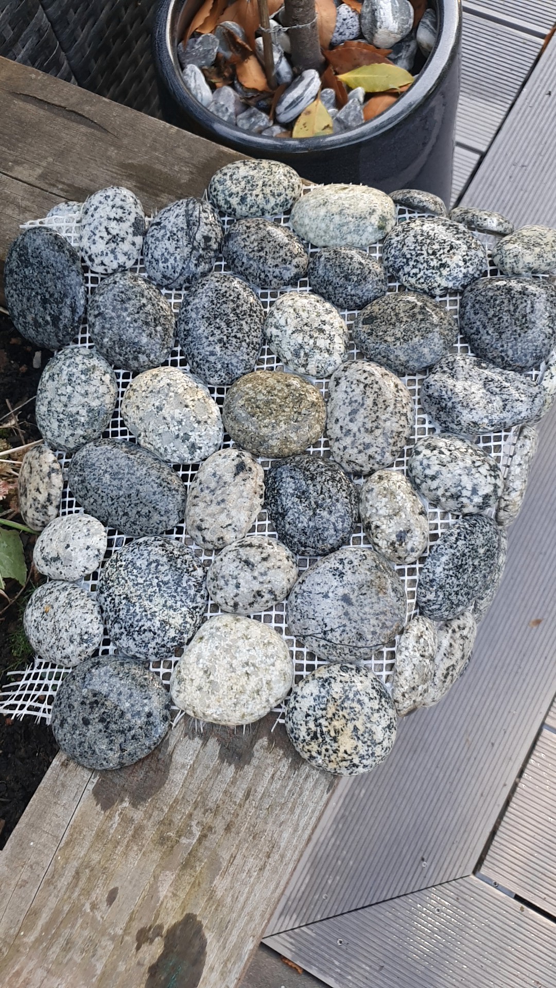

          took about 5 - 6 hrs to do the dome. I'm pretty sure it will be ok for tiling after i read up a little, it will have another coat of acrylic primer before tiling nex weekend. The pebble tiles will have a silver glitter grout for a bit of added bling.
          Very excited to see it finished!
