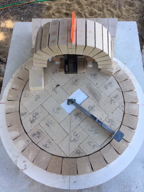

    Hello Kvanbael! Thanks so much for attaching that link. That looks really interesting and will be good reading this evening. And thanks for your sketch. I think I understand what you're saying about the tapers and how they align with the curvature. The bricks do have different degrees of taper which I tried to design with how they would sit with the curvature in mind.
    I did spend the day fiddling with the arch bricks, cutting some back and reshaping a bit and being a little more meticulous with laying them out on the form. I feel a bit better about how they are arranged now. There are still brick vertexes that don't necessarily align with the brick below it, which gets back to my post #69 post with the colored areas. I'm feeling like that is okay as when the dome bricks mate in those areas with those arch bricks, the dome bricks can then be shaped as needed.

    I did spend the morning checking over the arch brick cuts made yesterday. Found some of them to have some high spots as noted in photo with rule (that brick actually wasn't too bad, some others were worse off).
    I also put what would be a dome brick on the IT and wanted to see how it would sit on the arch brick. Lo and behold the arch bricks were a bit to long where the 16 inch cut would wind up. I used the IT with a pencil (the IT being set at the radius of 16 inches) and noted where they had to be cut back.
    I'm learning when you think you've got things laid out, recheck with another method just to make sure.

    I'm not sure I understand what you mean by "radially cut".... but I think what your'e referring to is the vertex of one brick does not sit even with the vertex corner of the brick below it? is that what you mean? If so, this is what I'm also questioning. Seems like they should and mine do not. Seems like the upper bricks are okay but as the eye moves to the bricks beyond that as you travel down the curve, they start to get out of whack. see attached photo. I'll look forward to hearing your (or others) thoughts. Thank you Kvanbael.
    This is because you have a complex arch curve where some parts have more curvature than others. Ideally, you would taper your arch bricks more in areas with higher curvature, so that the seams end up being perpendicular to your arch curve. Instead, you have cut all your bricks with a similar amount of taper, and hence when you align them to your nice arch curve, some bricks end up somewhat skewed.

    Are you bottom two/three bricks of the arch straight?
    They look like they angle the same way the course bricks will be, then you have used your IT to shape from the base. On your type of arch I don't think you need the IT to shape the vertical angle until about row 5, but can use it up to 5 on the inside to shape the circle to the rows.
    Hope that makes sense.
    You can see by this picture i have the bottom three rows straight and the bricks are smaller in length. As I got towards to top of the arch they were about 8.5" long.

    So, Cape. Since you are being so precise. I
    Couldn’t help noticing that your tapered bricks are radially cut, hence not always perpendicular to your beautiful non-circular arch-curve. That will give a bit of sawtooth on your “tunnel”.

    Going by how accurate your build is, I would suggest you redo the ones that have had the corners cut off. No-one will see it, but it will bug the life out of you.
    Out of my whole build so far, the triangle in the middle of the picture bugs me the most. It's actually the end of the angled brick of my arch but i cut it a few mm to short and looks like It's just filled with cement.

    I don't know what you have planned for your final lay, but would suggest marking the centre of the brick. Line your IT with the line to make a nice smooth arch.

    Thanks, Russel. When you say "keep the arch bricks ahead of the dome course" I'm interpreting that as, mortar the arch bricks in place as your move along with the dome bricks so the dome bricks can kind of be adjusted as needed (cut to shape) to mate with the arch bricks. Does that sound correct? Thanks!
    Leave a comment:
    replied
    Remember, no one really sees the front inside of the dome once it is dome is done. The tapered arch set-up looks like it is suppose to. When laying the dome courses, keep the arch bricks ahead of the dome course. It is a lot easier to tie the dome in or you can completely mortar the arch in ahead of the dome courses as well.

    Cut arch brick today. Was intending to mortar the half header row today but the arch has been weighing on my mind. It was kind of a leap of faith to cut the arch brick now as opposed to waiting till the rows butt into them and cut the arch brick then then. There are a couple of bricks I'm going to recut. And a couple I kind of accidentally cut the corners off. So still a "work in progress". I'm not sure how "perfect" it needs to be since there is the mortar that might cover up some sins, but will probably fiddle with it for another day. After just finished reading a book on Brunelleschi's Dome you kind of get inspired.

    To resolve the issue of not having room for mortar fitting between too tightly placed bricks for the half header row, I removed some material on each brick but left about 3/4 of an inch on each side where they touched on the inside next to floor bricks. This way still maintained brick to brick contact on inside circumference (that 3/4 inch or so) but opened up some area between each brick to fill with mortar on the outside. Hope to mortar these in place tomorrow.
