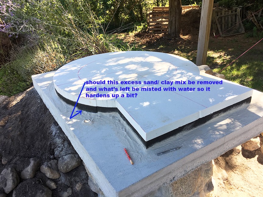

    Thanks Mongo for the follow up. I think I'll adjust a few of the bricks which will allow some spacing between the bricks to insert some mortar. Will keep the dome at 16 inch radius as I'm realizing the mortar will hold the brick and really doesn't matter if the corner vertex overhangs that space. Think I'll hit the corner of the foamglas with a little water mist and remove the excess sand/clay mixture.

    Not gospel, just my opinion:
    1) I prefer a bit of mortar, so even 1/8" would be fine. You'll still want the bricks to sit in their current positions (don't let the diameter or the ring increase), so you'll have to cut your last brick. Or, in a perfect world, all those eighths or mortar will add up to the width of one brick!
    2) I recommend keeping the dome diameter as planned. Any gaps, sweep some ash in them after your first fire.
    3) What you propose sounds fine, but without first-hand knowledge, I'll leave this one up to the judges.

    Couple of questions before I move forward. Hopefully someone can offer some insights.
    1) I'm planning on mortaring in place the first row tomorrow (the "half header" row). As you can see from the attached photo the joints are kind of tight. The bricks butt up one to the other with
    little to no room for mortar. Would it be advisable to leave a little more space between each brick so there could be mortar between each brick (even if its only an eighth inch or so).
    2) There's another photo showing a brick on the IT positioned in place. The vertex edge of the brick is kind of hanging over the space between the floor bricks and the half header bricks (like where the
    cardboard spacer is). Would it be better to shorten the IT a bit so the brick's vertex sits on the floor brick?
    3) Asked this before but not get an answer. I'll ask again. Is it a good (or not so good) idea to mist spray water around the outside of the foamglas where the 50/50 mix of clay and sand is to kind of solidify it
    (cure it) so it hardens up. Or just leave it be a powder?
    Thanks so much for any help. Appreciate it.
