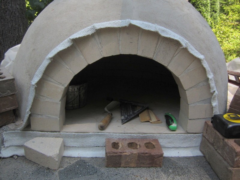

          Hello Lance and I think that pizza looks pretty darn good. When I build, I use the ceramic fiber tape to completely isolate the oven from any adjoining brickwork. It serves as both a heat break (I'm a big fan of those)
          and a control/expansion joint. After it's all done, I go back and seal it up.
