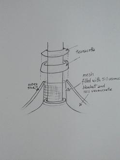

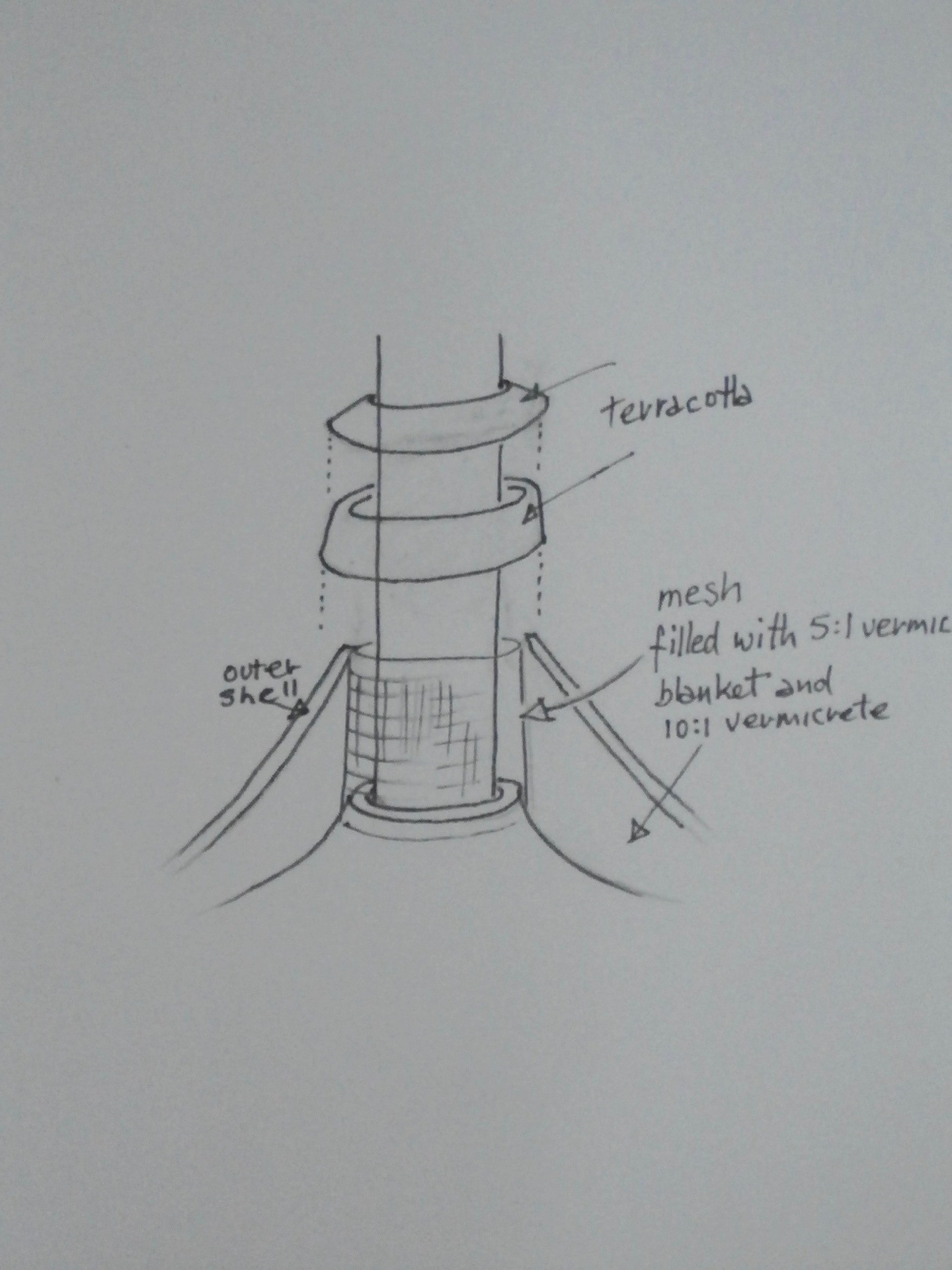

                              The vent can prevent pressure build up like a hole in a saucepan lid. I don't think its placement really matters although as the top of the oven gets hottest first and also driest first and any steam generated moves away from the heat source hitting the cook outer shell, condensing there and running down the sides, it is the base of the dome that remains the wettest, so drains there would be more appropriate. In this case any pressure build up would actually force the steam/water out the drains in a more efficient manner just as drain holes in the supporting slab under the floor insulation do a similar task. My experience firing new kilns where water dripping from the lower front corners of the kiln, once it reached around 400C, taught me this. I have a drawing somewhere explaining this principle, but can't find it. Another rather elegant solution would be to drill some holes in the base of the flue pipe that is surrounded by insulation so steam can pass into the flue pipe. This would then eliminate any external vents on the outside of the dome. My system is something like this (drawing attached)
