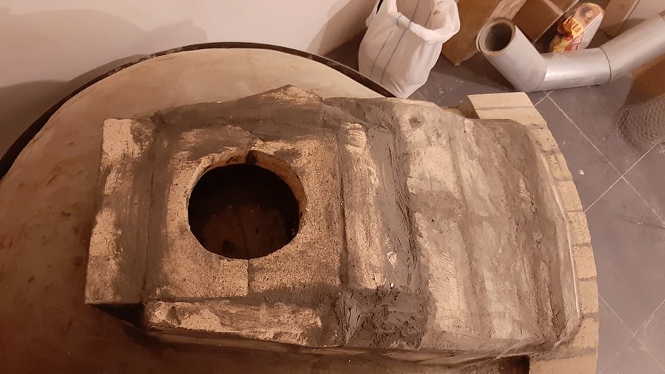

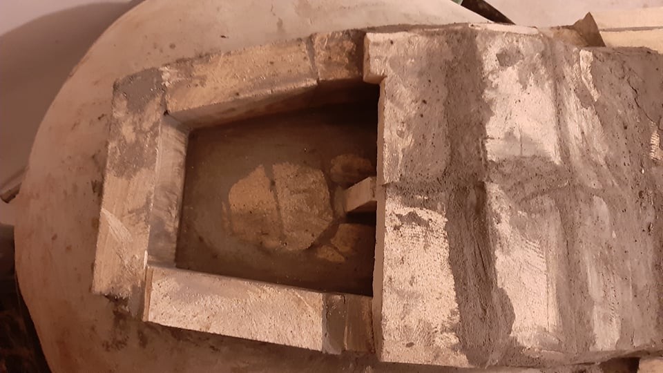

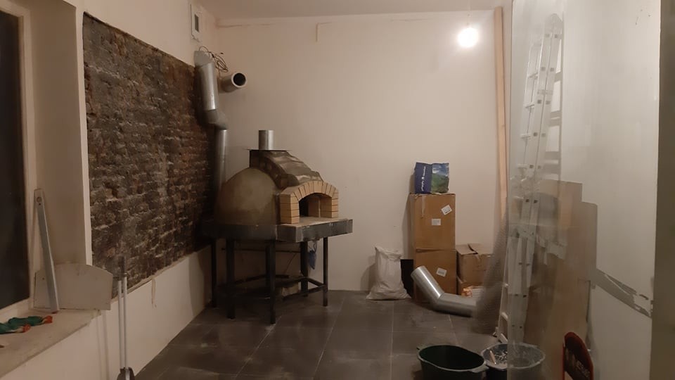

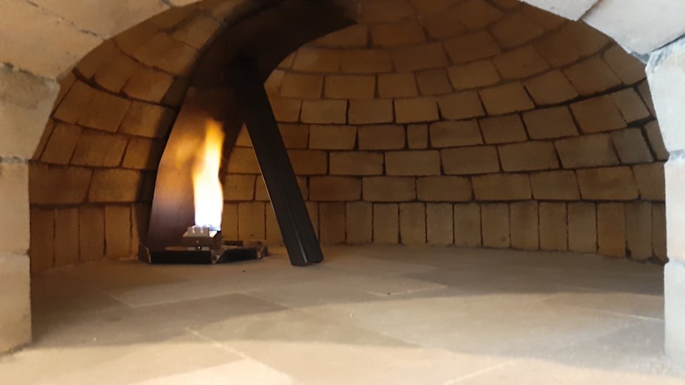

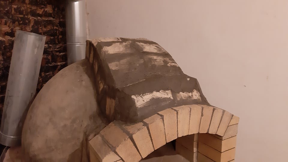

    I have been working again a bit! I'm pretty satisfied with the result, but it was a lot of work to make every stone fit. Inside where the air flows it's pretty clean and aerodynamic :-)
    Now i'ts only about mounting the pipe. I think I have found a good solution. Since I have a double wall "home-made" pipe the inner pipe will go into the whole which you see. The outer wall will be on the bricks. Additionally the outer Pipe will be held by a slightly bigger pipe which I will (somehow) attach to the bricks.
    Shall I use fireproof silicone for that? or drill into the stones?
    I would not like to put any additional bricks to be honest.
    cheers, Marvin

      #77
      It is recommended that no more than 45 degree bend should be used as the draw becomes severely compromised. A horizontal flue pipe is likely to create smoke issues, which in your case, being indoors could become a big problem. once your flue is heated the draw won't be an issue, but at light up it's likely to be a problem. Some folk install an electric fan in the flue to overcome this problem.
      • MarvinG
        • Oct 2020
        • 77
        #78
        Hi david s

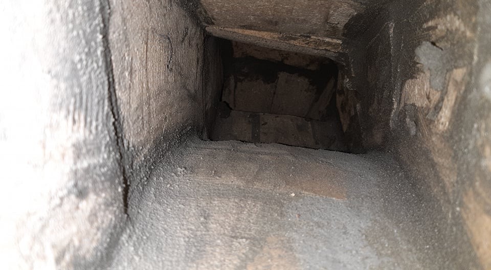

        Yes, I see what you mean. To attach the oven into the wall pipe (which is horizontal unfortunately) I will have a pretty big 45° +45° angle.
        However what you do not see, is that after the 1.5 meters horizontal, there is another 3 meters vertical through the chimney (not perfectly sealed attached) but it should help create some draw as well.
        In the end that is the max I can do with the given situation. I keep you posted how well it goes. I hope to be able to adjust the flame with the gas nicely to start slow. In the mornings of the next day, the oven should still be warm, so I usually do not start from zero...
        Thanks!

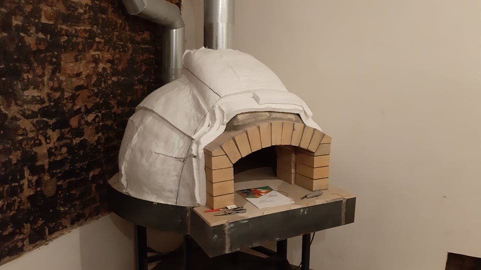

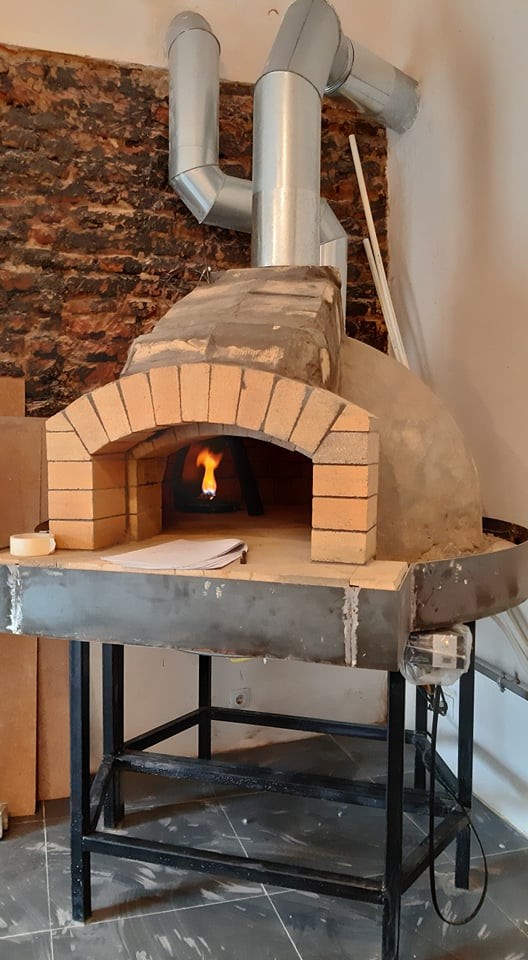

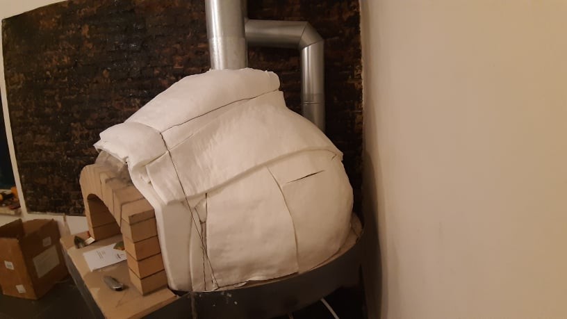

                            • MarvinG
                              • Oct 2020
                              • 77
                              #89
                              Good Evening
                              It's been quite a while. The gas is installed by the governmental gas company, the pipes checked that they are all sealed well. The burner works well, as well as the security measures. Means when the flame is too small that it goes off it instantly starts to ignite again. If it starts to rumble because there is too little gas or it creates a constant backfiring it creates an error, and the burner closes the valve. Independently I will have an additional "gas fitter" look over the whole set up. If you wanna see more pictures of the burner or infos I'm happy to share.
                              I have burnt the oven for about an hour during the past few days. Therefore I built a provisional heat shield since the flame is not in the middle. Today I started to add the insulation.
                              I have researched quite a bit when to cure the oven. Old method, new method. Did not really understand what is better. But I learnt that I should take it easy to heat it up properly. I'm waiting for my infrared thermometer - before I have this, I will not go crazy withe the temps. So far I could still put my hand in it (top of the oven inside). Was pretty humid every time - you could basically see how the oven was sweating.

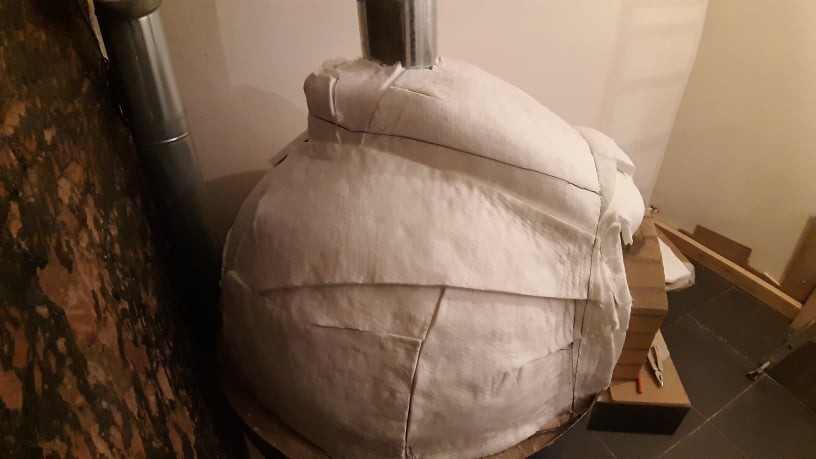

                              Since I have a bit insulation material left I will put a 3rd layer on the upper part of the oven.
                              After all the insulation is there I will put around a chicken wire to give it some additional stability.
                              One question has come up though.
                              When I will switch off the oven and close it over night to keep the heat: Will I not loose quite a bit of heat through the squirrel tail, because I have a constant small drew through the chimney? Would it not make sense to close the pipe as well somehow? Otherwise the oven receives constant cold air to the highest part, right?
                              below some pictures of the latest progress:
                              cheers, and happy new president guys! ;-)
                              Click image for larger version  Name:	140453015_508178256825714_807610717765182285_n.jpg Views:	0 Size:	52.1 KB ID:	434954 Click image for larger version  Name:	140304204_1181503862279271_547019270277249118_n.jpg Views:	0 Size:	107.8 KB ID:	434957 Click image for larger version  Name:	140680242_456382698875726_2933472596049919138_n.jpg Views:	0 Size:	67.3 KB ID:	434955 Click image for larger version  Name:	140393586_411418946748649_4284271804994079211_n.jpg Views:	0 Size:	49.8 KB ID:	434956 Click image for larger version  Name:	140734245_161910495447968_2892508301620037644_n.jpg Views:	0 Size:	43.9 KB ID:	434953

                                #90
                                That's looking good. I've not noticed that the top of my oven (where the squirrel tail is) loses more heat than the sides. I suspect it is because my door seals quite well and my door is quite thick, so it effectively blocks the chimney throat too. While some heat must be lost with convection, I do not see this as a major problem. A flue baffle won't hurt, of course, but it's one more moving part so more to go wrong in my view.
