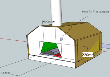

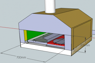

                    I'm at the final design stage with my fabricator and he's having a little difficulty with the front of the oven. Everything on the oven will be locked into place - no welding whatsoever. I want the front to be insulated but with the cutout for the mouth of the oven - this is a little challenging without having gaps and sharp edges which is a definite no no.
                    He suggested we close of the height of the opening to 200mm (Oven Internal Height is 340mm) and leave the full width of the inner dome as is - see the 2nd picture of how it'll look. My question is, is the width of the opening as important as the height is? Heat Loss is always a concern and I'm trying to avoid that altogether. Picture 1 is what I originally had in mind.
                    Please advise me - I'm so confused as to what to do.
