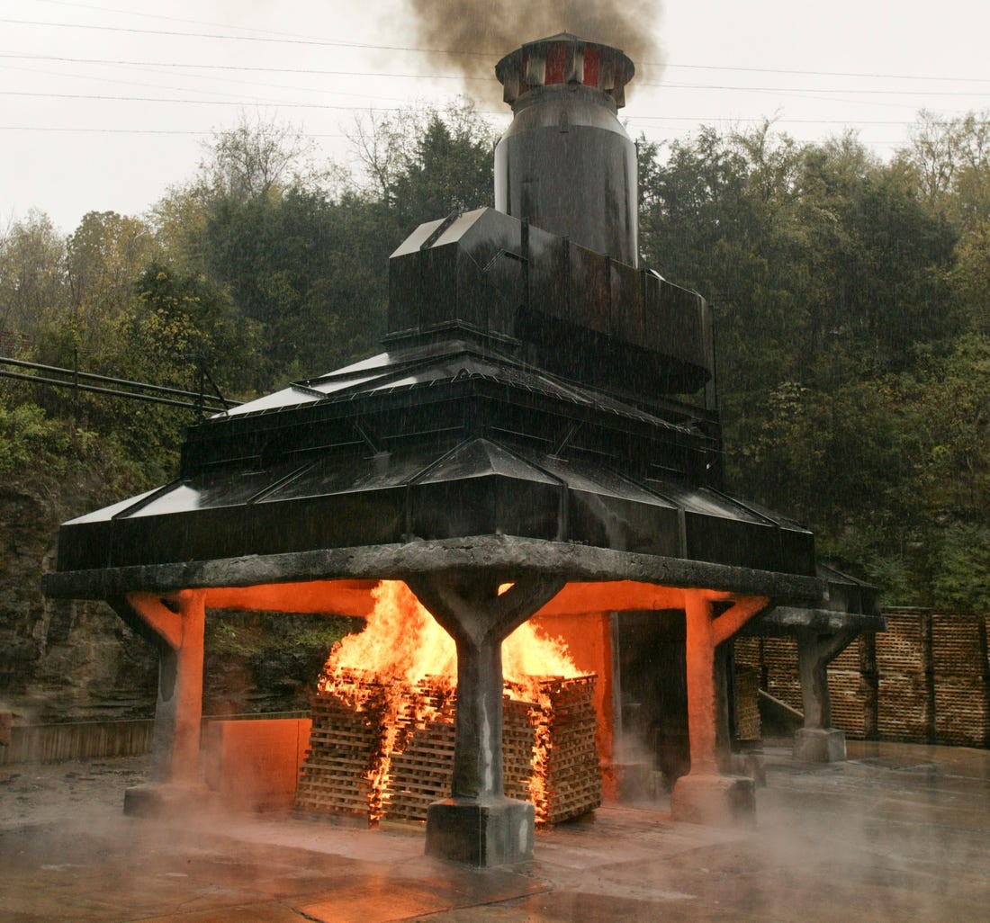

      I have always used a top down method, starting under the chimney vent then when drafting pushing into the main dome. I saw this supersized top down method at Jack Daniels in Lynchburg, TN. It was a dry county back then only offering Black Label and Yellow Label at the end of the tour (Coffee or Lemonade) LOL. Since then you can now sample the real stuff.

        Thanks for the replies, Russel and PurpleHaze. Just finished splitting some wood...pretty frigid out there. I'll do the top down method, warm up that flue pipe and then push back into the dome....hopefully won't match the Jack Daniels size, although that does look warm. Thanks, again!
