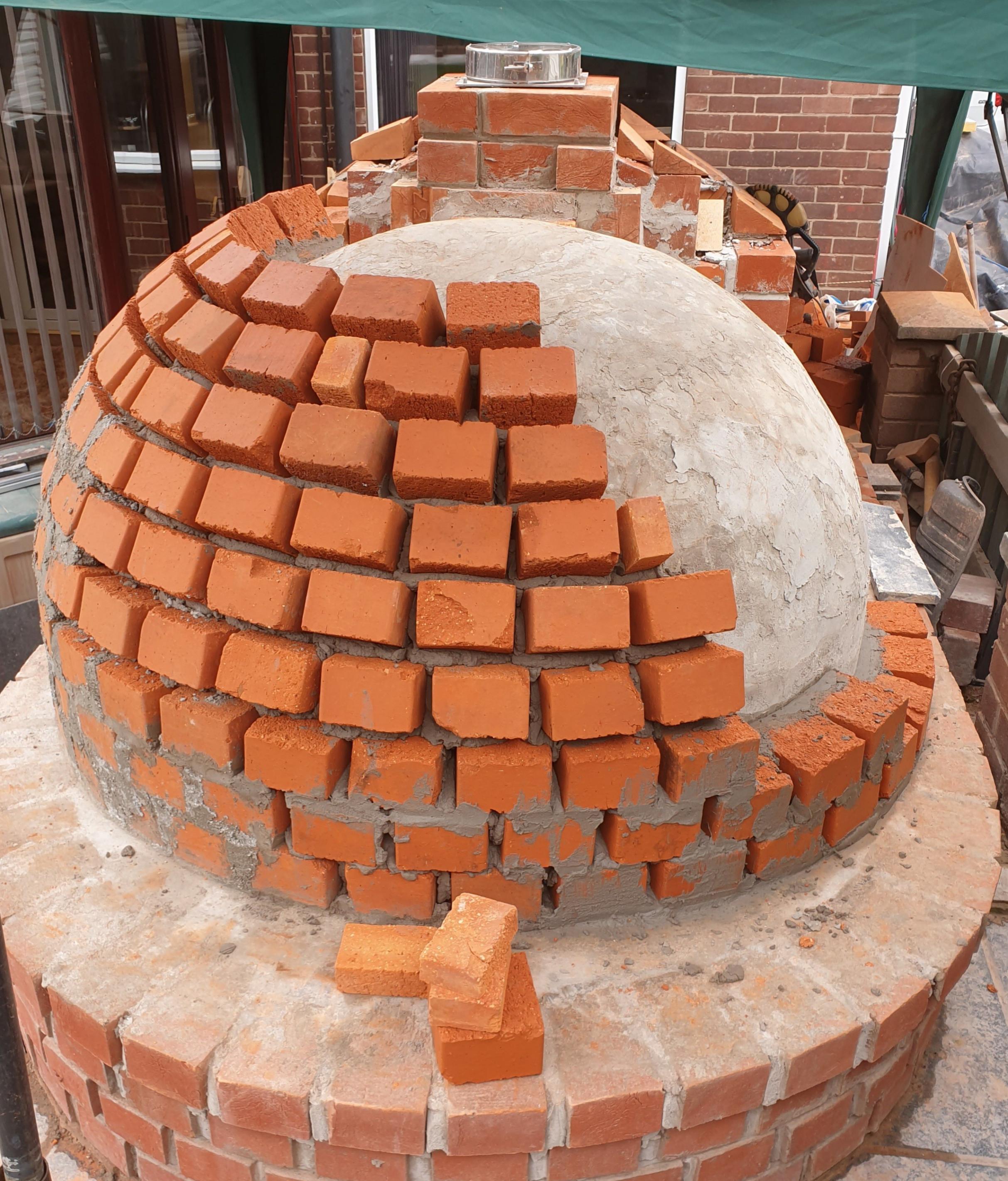

    Hi Ian, I didn't exactly finish my outer dome in brick, however, having built the inner dome, fitted 50mm (2× 25mm with heavy foil vapour barrier) rockwool insulation which was then caged in chicken wire. I did a vermiculite/perlite render before completing an out dome with insulating firebrick and pointed these with a vermicrete mix. I then did 2 or 3 cement screeds before tiling with 10mm thick mosaic granite tile.
    For anyone wishing to finish in normal clay brick it would be similar process for outer dome build, pointing up with homebrew fire cement or regular mortar. I must say, the outer dome goes up an awful lot faster than the inner dome.
    Please see attached picture of outer insulating firebrick dome. No reason same cannot be done with regular clay brick so long as you have properly insulated your dome. When my oven is 500°C plus (temp gun only goes to 500°C), the outer dome is reading 4°C same as outdoor temp at the moment.
    Hope this assists, feel free to ask anything else, i'm sure there will be other far more experienced members will assist wherever possible. I can offer little really but will always try.
