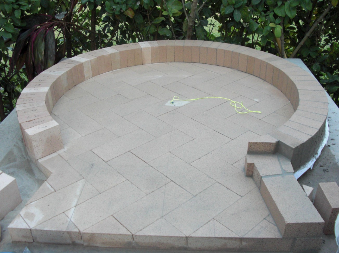

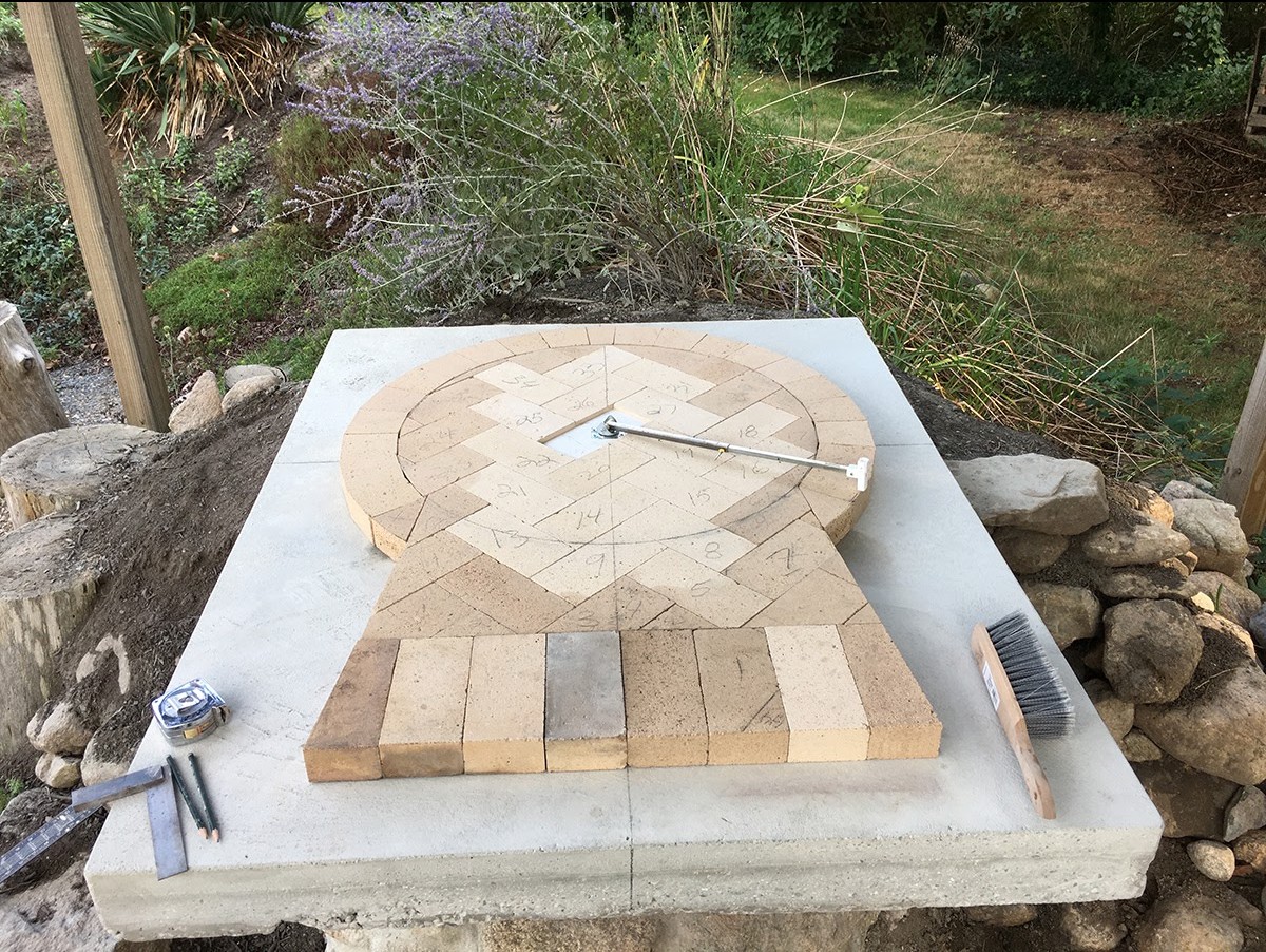

    Hi All,
    I'm building a 36" ID pizza oven. Are there any advantages/disadvantages to cutting the floor brick to a 36" diameter and then laying the first course outside of that, versus cutting the floor brick to 40.5" diameter and laying the first course on top of that? Please see photos for reference. It seems as if the latter would have more of a seamless transition.
