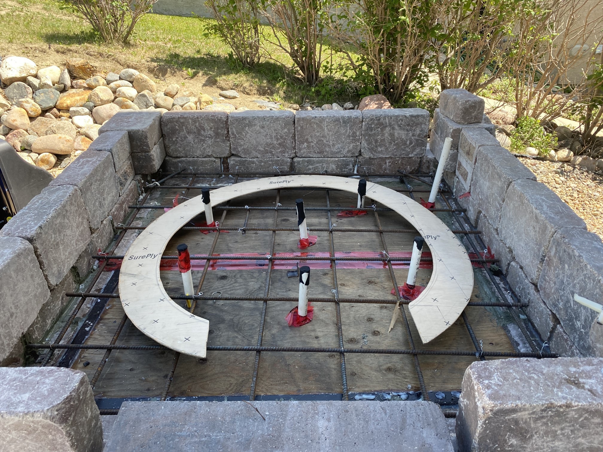

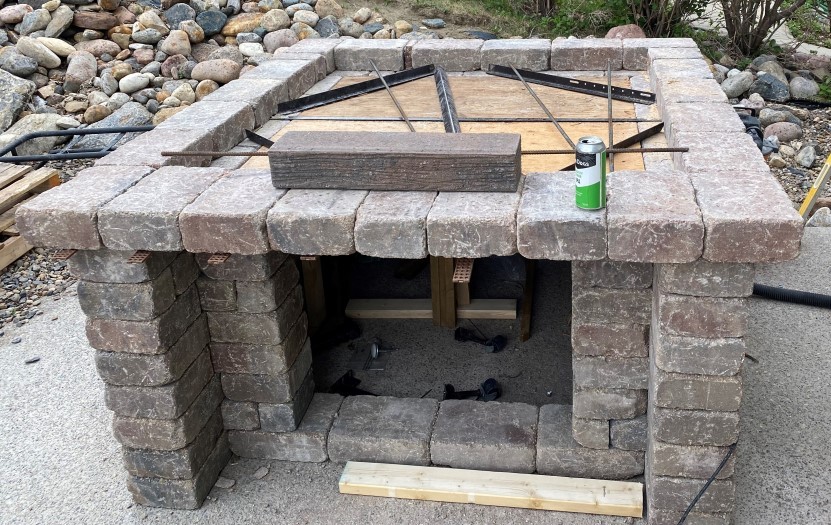

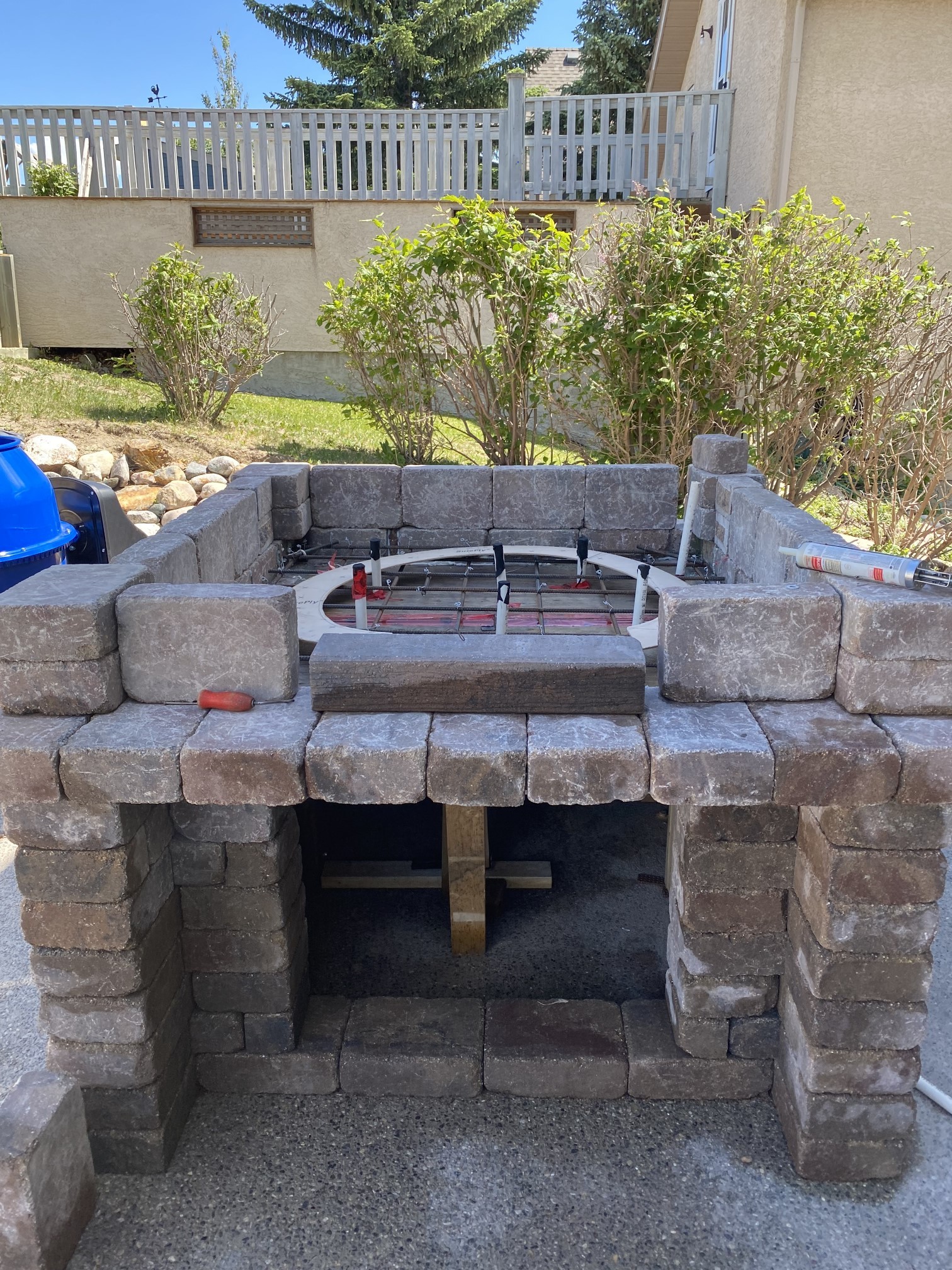

After months of lurking, I finally started my 36" build at my cottage. Since I'm only there on the weekends for the most part I used landscaping blocks to speed up the stand build. I'm about to pour the concrete for the hearth. I have 8"'s to play with for the concrete slab and perlicrete base. I was planing on 4" concrete and 4" perlicrete. Would it be better to go 3.5" concrete and 4.5"'s of perlicrete to maximize my floor insulation? Is it better to add slab strength (69"x 54") or floor insulation?
