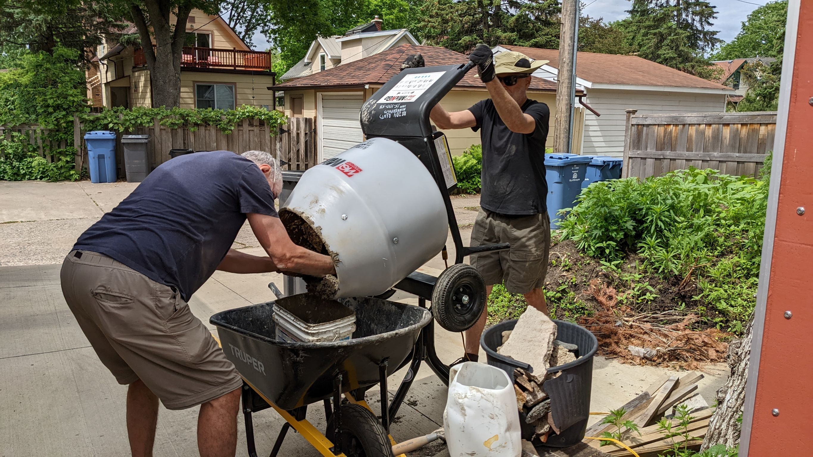

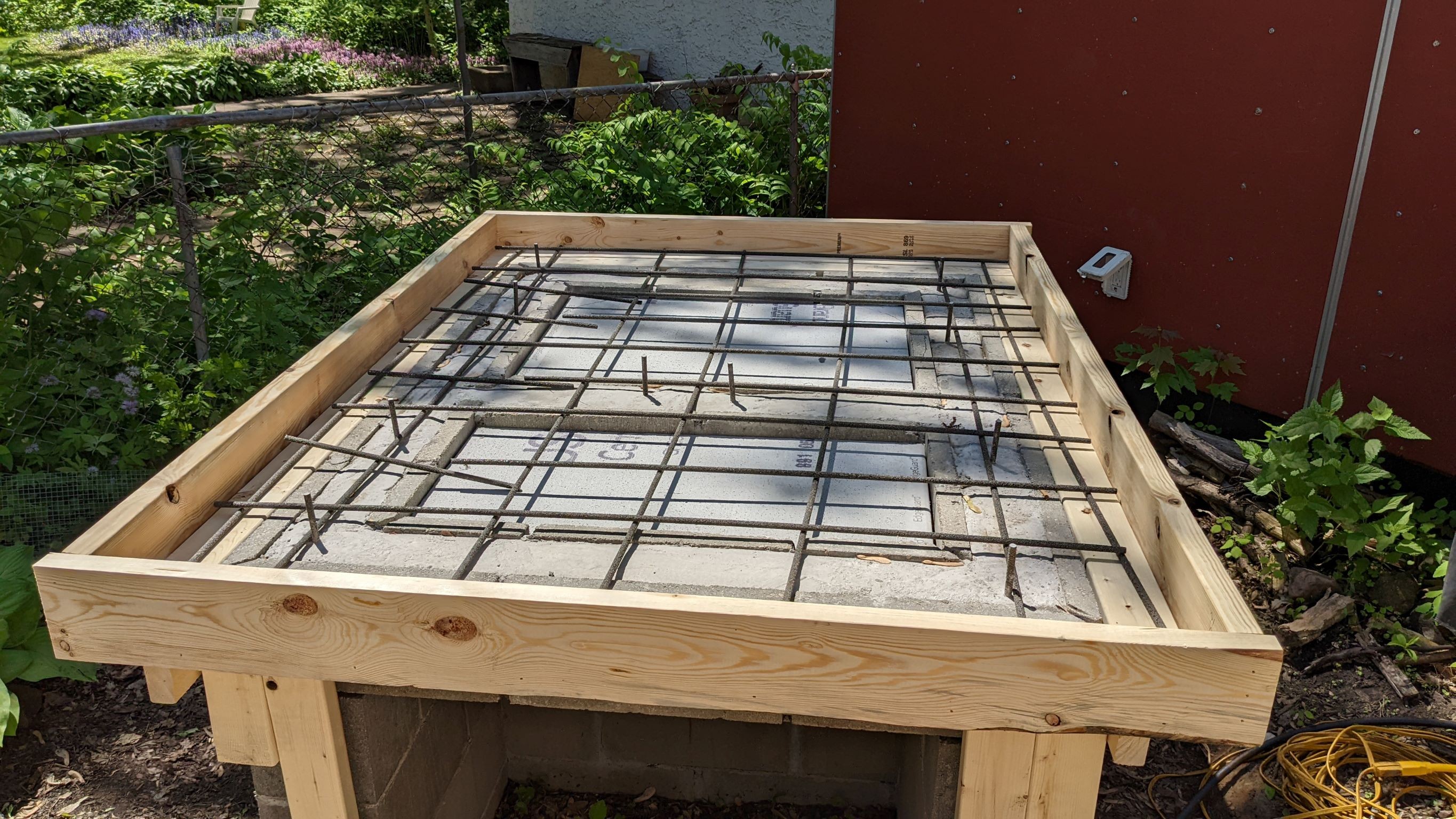

    Back at it after a long winter hibernation... I'm the one with the mask, trying not to breathe cement dust.:-) Sixto. It was great to have my pal come over to help, not just for the muscle, but also for the cool italian vibe he brings to the party.
    I used fiberglass rebar, to avoid issues from water seeping into cracks and rusting the rebar down the road. I also wove the bars together instead of wiring them, and waited till I had 2" of concrete cover in the forms before placing the grid and continuing to fill the form.
    The first photo shows the two wood storage compartments (One faces the back) I wanted to have a wall in the middle to tie the two long walls together, and take up some of the weight of the dome. The front and rear lintels are made from lintel block chamfered at 45d with an 8" diamond blade mounted on a grinder. (needed a spacer to fit right).
    I also placed 4 vent holes (about 1" diameter Vinyl tube for stiffness, filled with a length of thick foam backer rod. (in case the vinyl tube doesn't want to come out)
    I rented the mixer at 8:00 a.m. and returned it at 3:30 pm (with a lunch break and a quick trip for 6 more bags) Total was 22 bags of 60# ready-mix (3,000 psi) Slab is 4" thick x 6'-2" deep and 4'-7" wide, I did chamfer the back two corners about 9" to get more clearance between the garage and fence.... it's a bit tight walking back there.
    I will post photos of the finished slab after it's cured and I've pulled the forms. It's now curing under wet canvas...
    Click image for larger version  Name:	Slab Formwork2.jpg Views:	0 Size:	1.03 MB ID:	446909 Click image for larger version  Name:	Formwork with Rebar2.jpg Views:	0 Size:	1.06 MB ID:	446910 Click image for larger version  Name:	Mixing Concrete2.jpg Views:	0 Size:	1.19 MB ID:	446911
    Click image for larger version  Name:	Pouring Slab2.jpg Views:	0 Size:	1.08 MB ID:	446912 Click image for larger version  Name:	Slab and Rebar2.jpg Views:	0 Size:	1.28 MB ID:	446913
