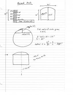

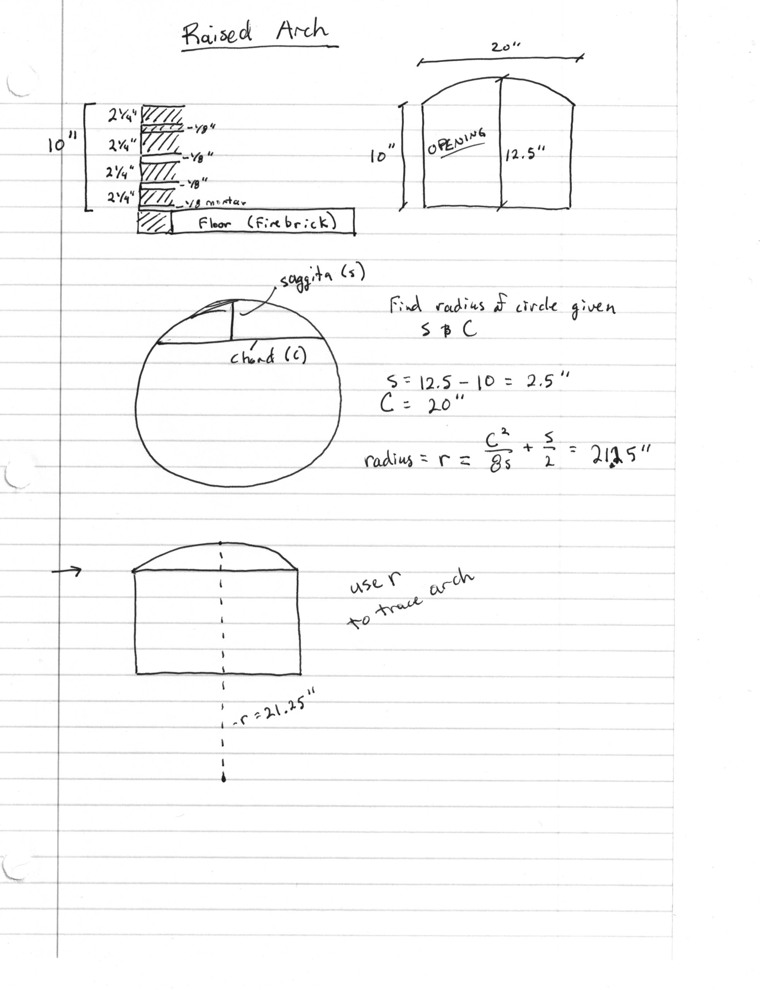

                      Russell, I'll try to remember to take a picture of my IT after work today. Here are some calculations I did for determining my raised arch curve. Hope to put together a template tonight.

                        12.5" is right in the range for a 39" ID dome. Rule of thumb is 63-65% of dome height so you are there. Depending on the type of chimney material, ie brick, double wall SS, etc. buttressing of the side walls may be required (tall brick chimney). SS should be fine sans buttressing. To help with the arch bricks on a axed arch I did a quick design using some software I have called the Anglelizer. It is no longer available from General but I think a forum member posted a link to a public domain software archive.

                          I built my 39" oven with a 12.25 inch high opening - a number I arrived at by interpolating the FB plans between their 36 and 42 inch oven recommendations. A 12.25 opening in a 39'er works out to be 62.8% which was close enough to 63 for me Also if you build a hemispherical arch (not what you are showing) the 9.75" radius that gives you a 19.5" opening sits perfectly on a 2.5 inch brick at the bottom of the arch.

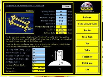

                              Click image for larger version  Name:	IT2.PNG Views:	0 Size:	28.4 KB ID:	440418Here are pictures of my IT tool. I just recently realized that I will need to cut off the bottom support so it is the same width as the top so that I can get a good profile to trace when doing the inside parts of my inner arch bricks, but I will trim those down when I get to that point. I was trying to get something that would work with what I had and in the end just had to buy a threaded rod for it. The bottom pivot is a 1.5" caster. I am actually going to do the full 42" oven, my wife wants to have the option of roasting a pig in it in the foreseeable future. I plan on adjusting the IT for each level taking into account the distance from the brick to the IT (1/2" plywood plus 3/4" to pivot of caster) to keep the radius close to 42" for the whole dome. Any advice on this? Would it just be better to dial the IT in and then just keep it at that length except when adjusting to use with a pencil? Thanks for your help.Click image for larger version  Name:	IT1.PNG Views:	0 Size:	27.8 KB ID:	440417
