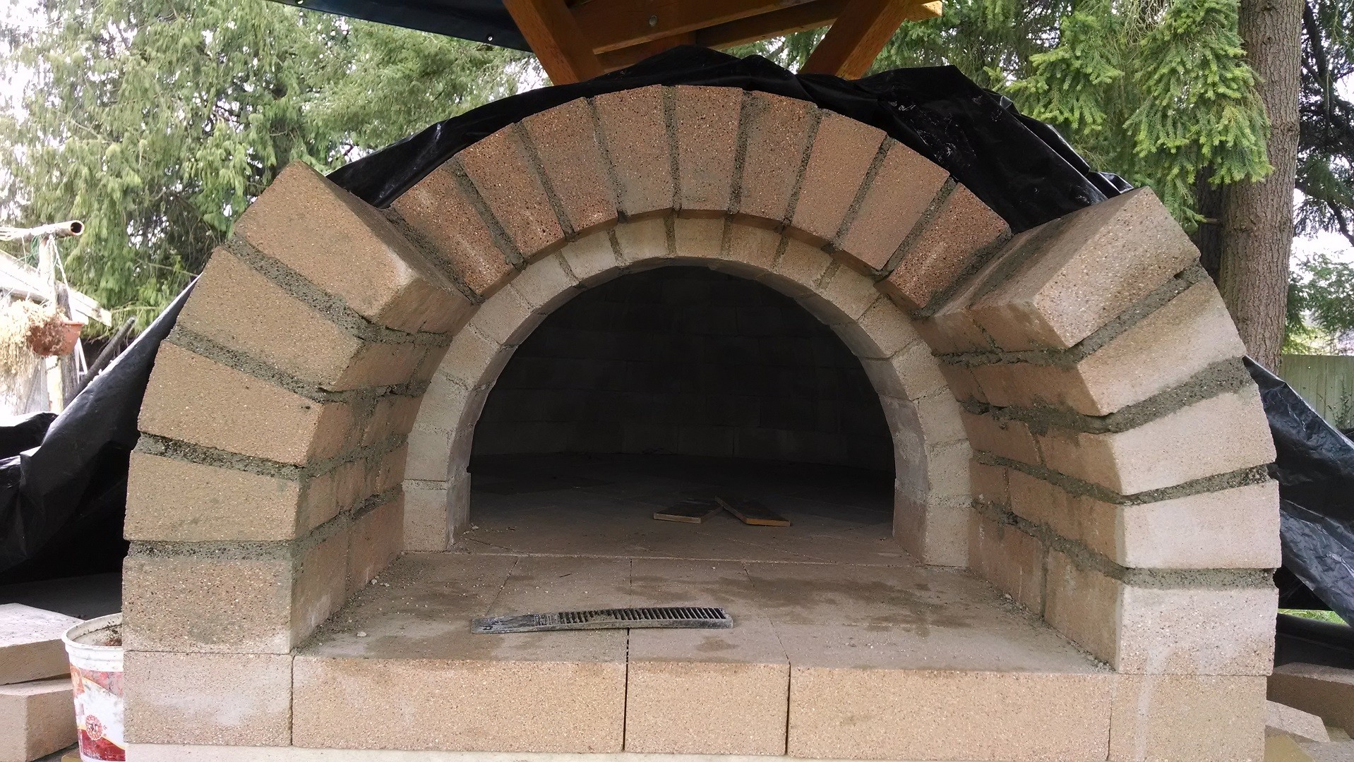

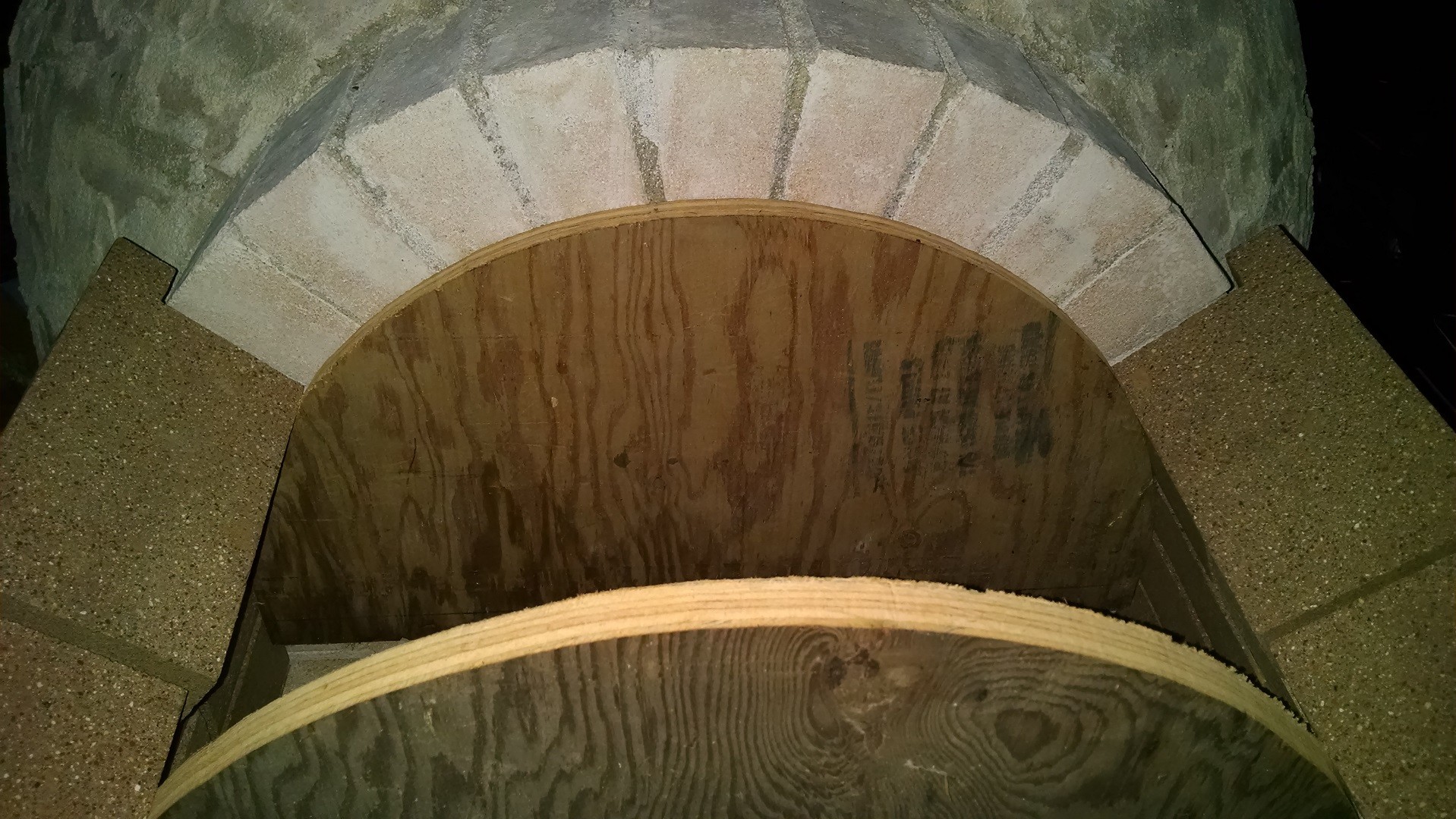

    Ryan, I think the lip you are talking about is called a "reveal" and most builders provide for one by making their vent arches larger than the opening in their dome arch, usually by an inch or so. You can see mine in the first attached picture. If you make a door slightly smaller than the vent arch is will slide in the opening and butt against the dome arch (second picture)

        Here is another shot that might help. When I built my rear vent arch, I put in a heat break and cut my bricks so that they would overlap my oven arch both providing a gap for the heat break and to raise the bricks so that some of the face of my oven arch would be exposed for the reveal. First pic shows how the rear vent bricks go up and over the oven arch, second is a little further along the process
