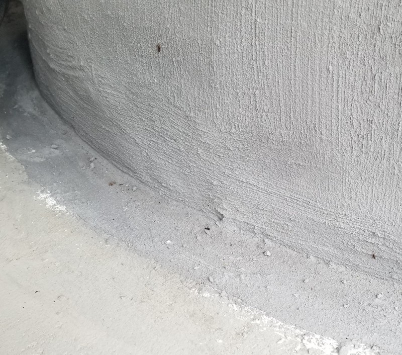

            Just for clarification, cement board is not waterproof. While the board itself will not be damaged by water, it can absorb water and if saturated, allow it to pass through. In shower construction that's why it's common to see cement board coated with a surface applied membrane; Kerdi, RedGard, Hydrodan, Ardex, etc. Or at a minimum to have a drainage plane behind it; tar paper or 6-mil poly.
            After I did my render, I treated it with a couple coats Thoroseal. It's a cement-based coating that provides protection from liquid water, but allow moisture vapor to pass through. That was my protection until I got the stone veneer installed. A 50-lb bag was around $35-$40, enough to do three, maybe four coats. I coated the dome and carried the Thoroseal out a few inches on to the slab. The stone veneer covers that return on the slab.
