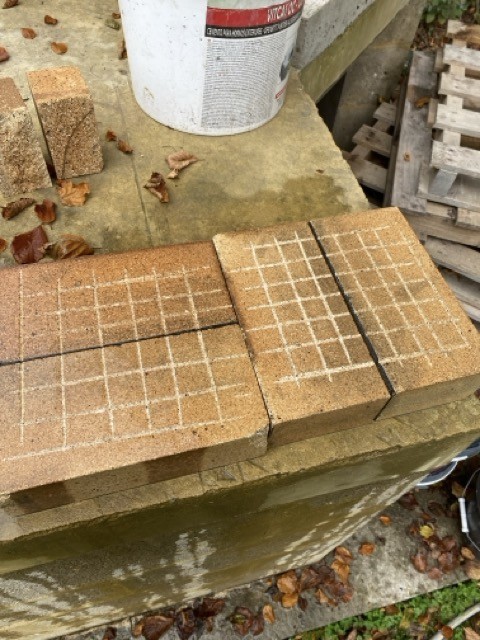

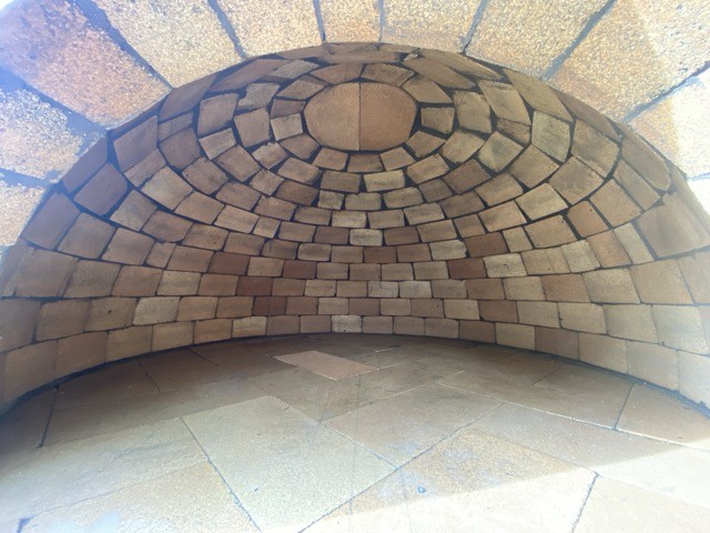

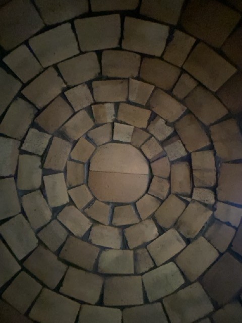

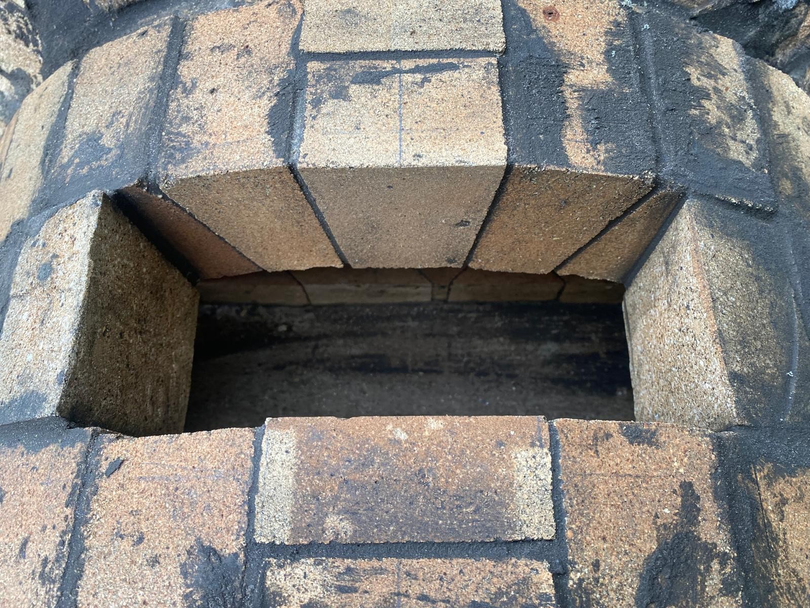

    Working only with a brick bolster and a 9” grinder has its limitations so my cuts are not the most accurate or clean. I’ve been getting by though, using wedges to plug big gaps between bricks in a course and sometimes between courses.
    on the last course I’ve tapered and bevelled the bricks but as we get closer and closer to closing the dome I’m afraid much of the material will be mortar or screed and not firebrick.
    Therefore I have lapped 2 layers of full bricks together in opposing directions to prefabricate a keystone. The bricks were ‘keyed’ before joining with mortar. I will cut the 4-brick block down to suit the final opening in an attempt to minimise mortar. Will it be okay?
    I plan to handle this keystone by drilling in plugs and fashioning a handle, the plugs later to be removed and mortared
    • #32
      Keystone has been marked, cut and trial-fitted.
      ready for aesthetic fettling and mortar tomorrow, and a few tapered wedges on the cardinals.
      • #33
        It's always a great accomplishment to get the dome plugged. Congrats in advance on getting that cap wedged and mortared in place.
        Just when you celebrate that feat, the real work begins!

          • #35

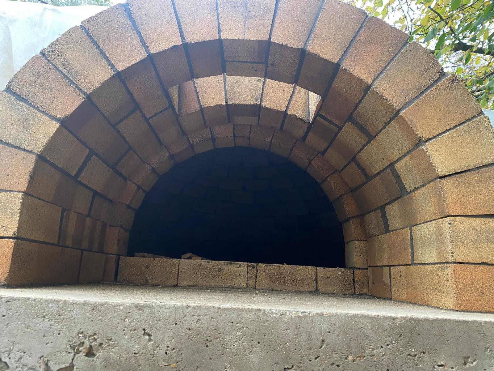

            Cleaned up yesterdays joints best I could - left them a little too long
            • #36
              Congrats on closing your dome!
              If the excess mortar is bugging you, scrubbing with vinegar and a wire brush can remove stubborn excess bits of mortar (one can use stronger acid, but using HCl or muriatic in an enclosed space gives me the heeby-jeebies. YMMV)

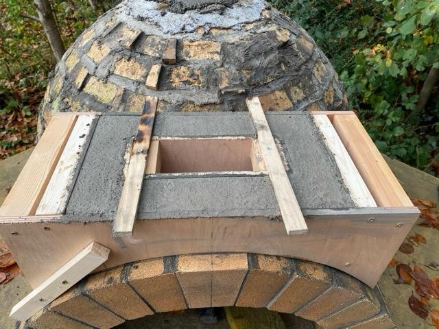

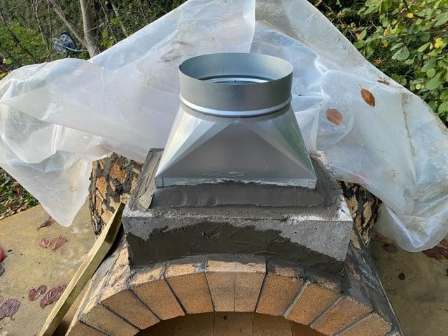

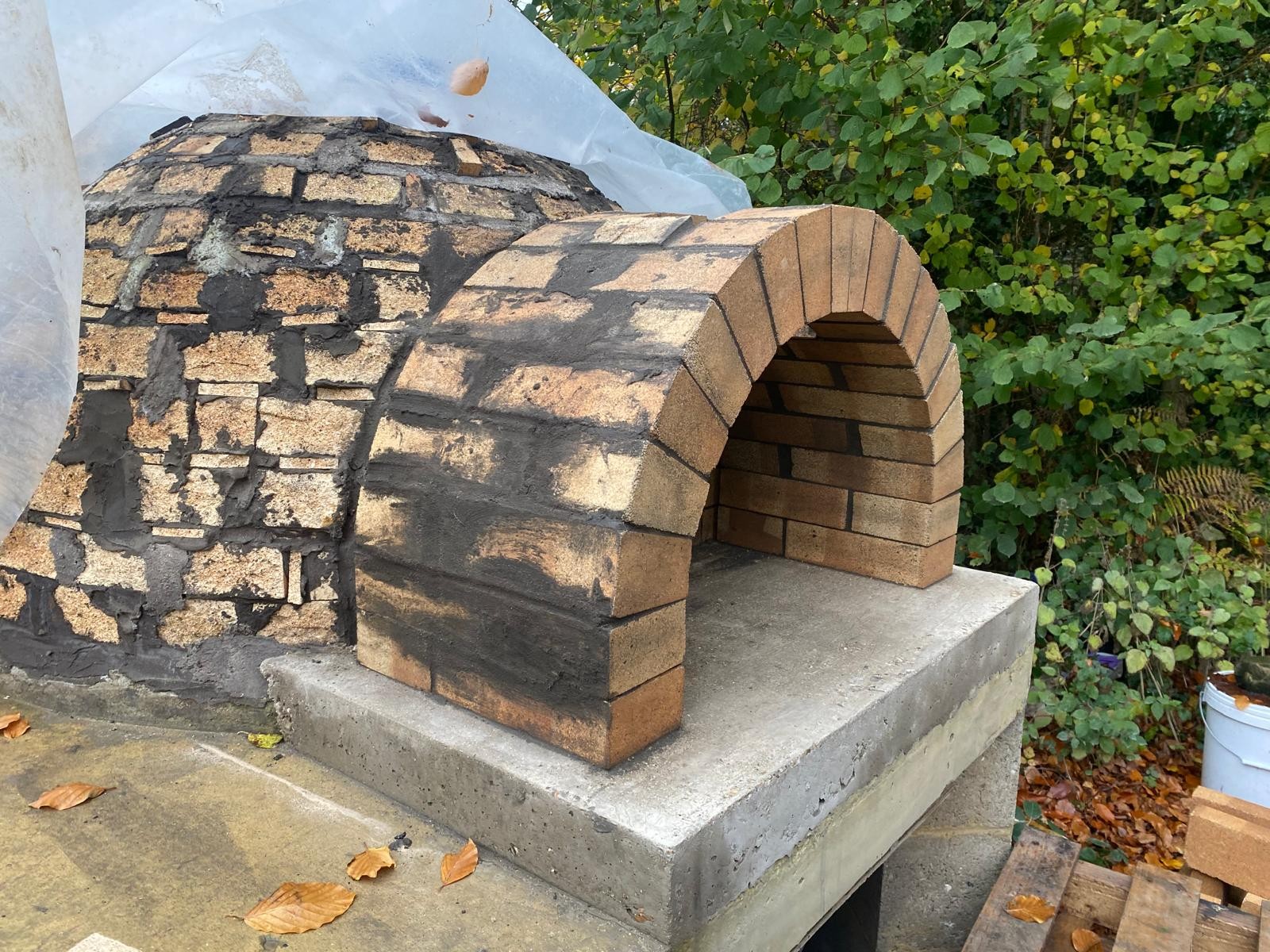

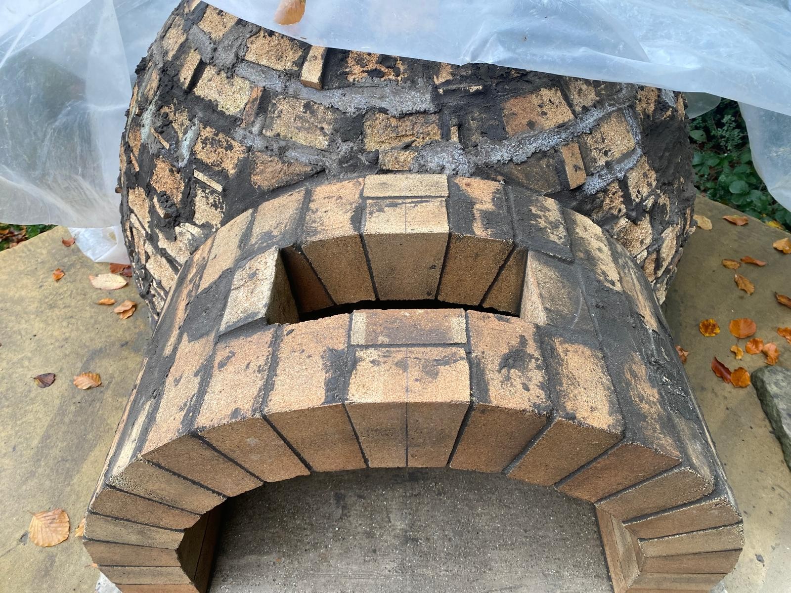

                I found a few hours last saturday and managed to build the outer arch.
                For the chimney transition, I was going to build a brick platform on top of the arch to create a level surface - HOWEVER, I just can't cut the bricks properly - so will save the remainder of my firebricks for an outdoor barbecue or firepit.
                Instead of the bricks I will cast a flat plinth in-situ using either Vitcas Heatproof Screed, or Refractory Castable.
                Then on top of this, I will place my transition piece.
                The transition piece will use a rectangular to round duct converter as a form, making the transition out of castable refractory.

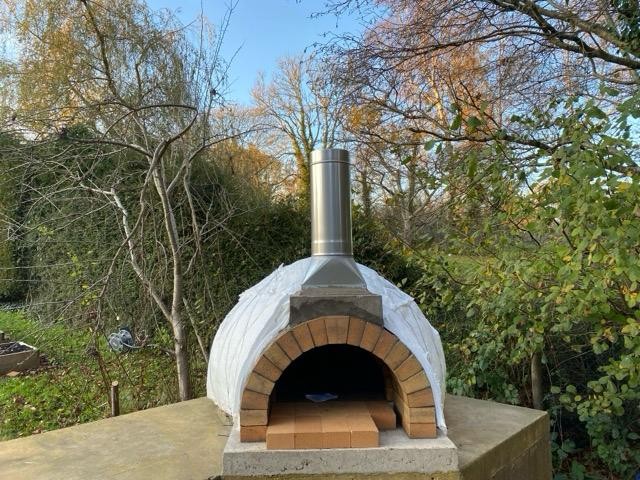

                        The weather is closing in on us! Needing to make the most of the odd dry and warm-ish hour or two here and there when not working or having family commitments.
                        The oven is now insulated with ceramic blanket and supported with wire. It needs chicken wire then v-crete layer before rendering.
                        The chimney begins with a cast plinth on top of the arch using refractable. On top of this is a rectangular to round duct adapter (steel), then the stainless flue pipe.
                        The ceramic blanket is applied in 3 layers, when covering with V-crete the material will be sculpted around the chimney. The outer arch is isolated so doesn't need to be fully covered by ceramic blanket.

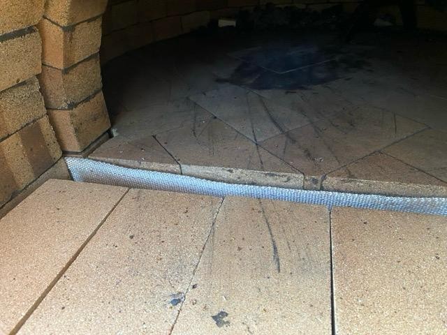

                        The entrance in the outer arch is temporarily firebricks - it will be V-crete with a stone slab. The floor will be isolated with insulating glass fibre tape.

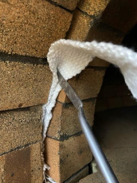

                        The dome and outer arch are constructed with 8mm air gap, the gap is filled by folding over 50mm x 3mm ceramic fibre tape. Friction only keeps it in place. I think this should be sufficient and it can compress without the dome loading the arch when the dome is hot. If the tape falls out, high temp sealant could be applied to one side and it be pushed back in. Lets see

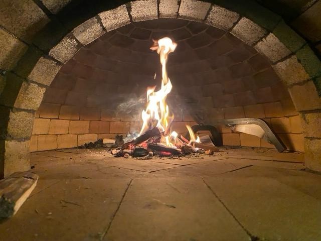

                        I have had 2 no. small curing fires of 2 to 3 hours, top of dome reaching c. 150 to 175C.
